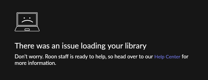

There was an issue loading your library - INNUOS ZENith MK3 Hi there,
I have a Innuos ZENith MK3 and the roon database keeps on crashing. Its the fourth time now within the last couple of month and I am tired of restoring from a backup. The log files have just been uploaded.
Router: avm fritzbox 7690 to switch: cisco ws-c2960cg to Innuos PhoenixNET switch to Innuos ZENith MK3 all cat wired.
