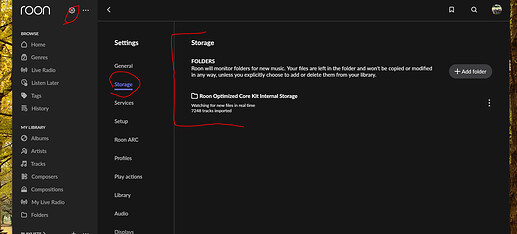

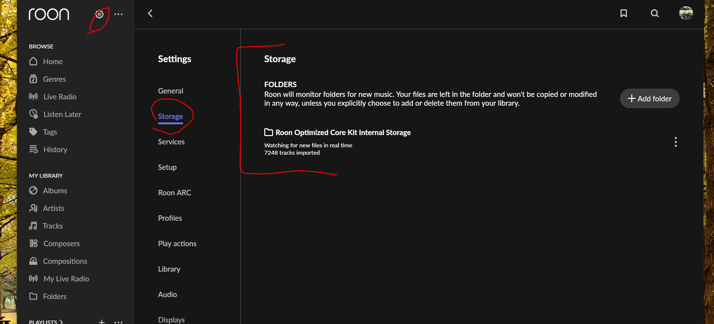

Where are the files stored? Check in Settings/Storage and look at the status of your storage locations.

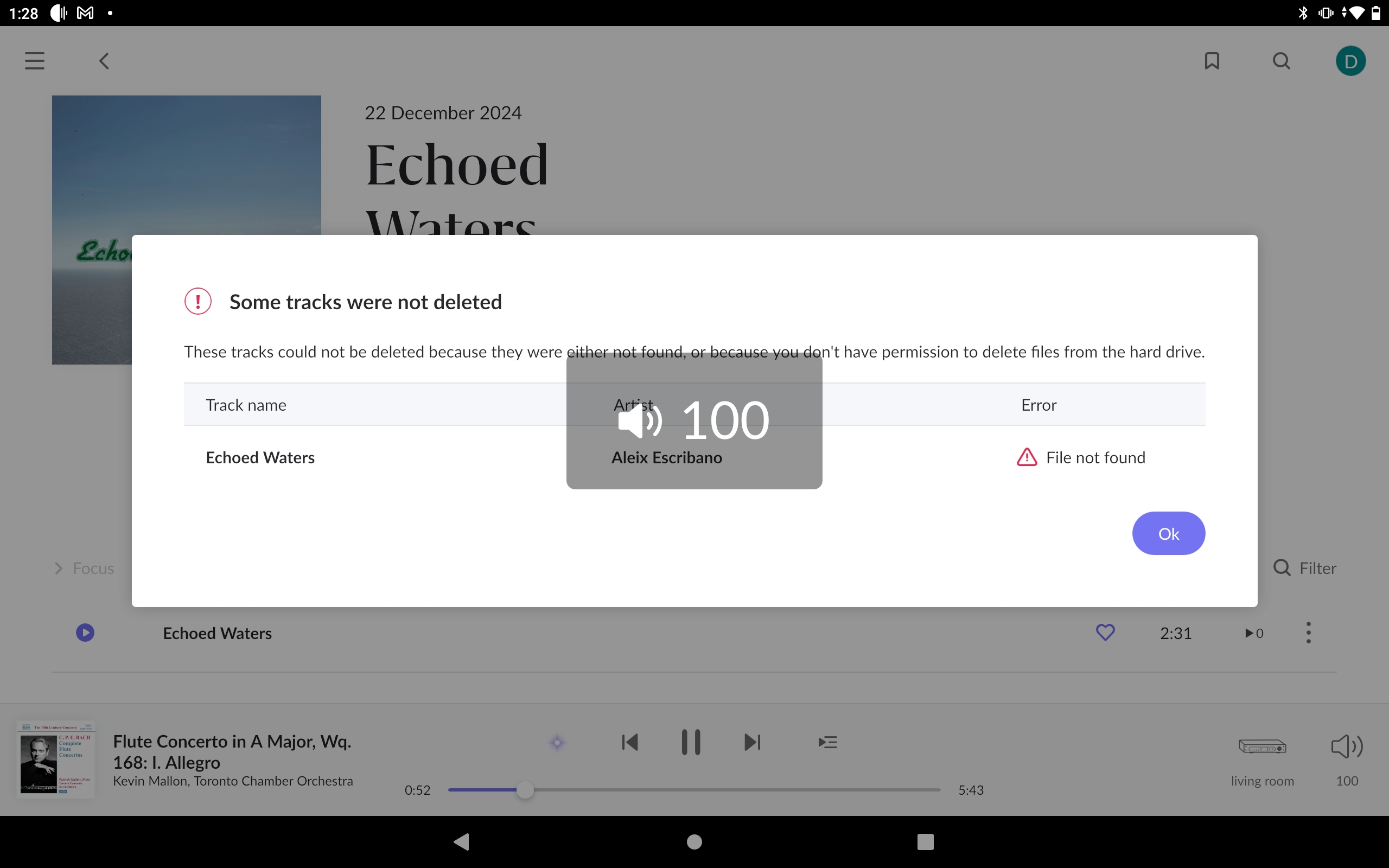

I did not Download them myself to ROCK, they just appeared which is why I was trying to delete them.
Many are single songs. I have tried to delete them but they are not found on Roon, they are listed in Qobuz storage section.
However, since I did not download them they are not found and the DB is not getting updated.
