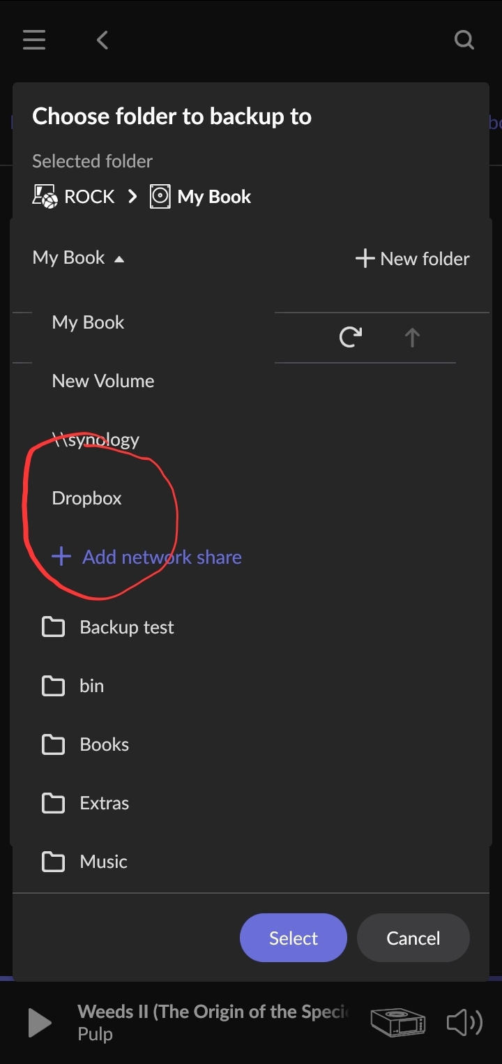

How do I configure the backups straight to Dropbox?
Do I require anything else other than the NUC ?
I’m just trying to understand, all the requirements before taking the plunge.
Thanks.
You select it from the backup location dialogue box
