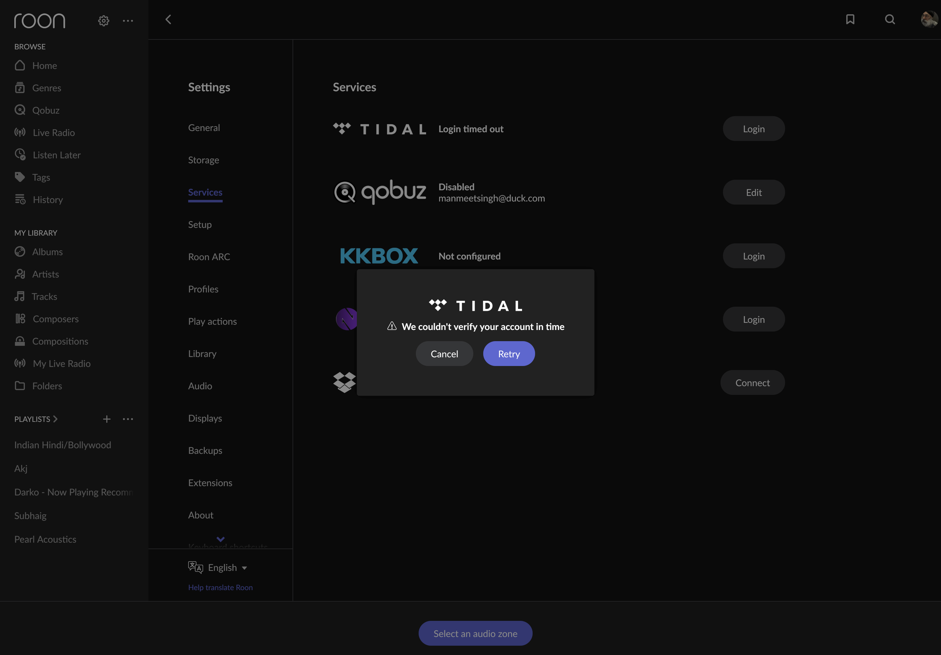

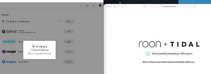

Roon desktop app is not able to recognizing that Tidal account authentication is successfully completed. Login window on Roon app keeps spinning.
I have Xfinity WiFi, connected via Netgear router.

Since the DNS change didn’t help, we need to look closely at the “handshake” between your web browser and the Roon app. When you click “Login,” Roon hands the process over to your browser, and once you authenticate, the browser needs to pass a “token” back to Roon.
To help us pinpoint where this is failing, could you please try the following?
  1. The Browser Swap: When you click "Login" in Roon and your default browser opens, copy that URL immediately and paste it into a completely different browser (e.g., if you use Safari, try Chrome or Firefox).
  2. The Redirect Pop-up: After you enter your Tidal credentials in the browser, do you see a pop-up asking for permission to "Open Roon" or "Return to Roon"?
  3. The Result: If you click "Allow" on that pop-up, does the browser just sit there, or does it return you to the Roon app where the wheel continues to spin?
This information will help us determine if the issue is with the browser's security settings or how the macOS handles the link transition back to the Roon app.

Followed the steps noted above and still getting the same issue.
