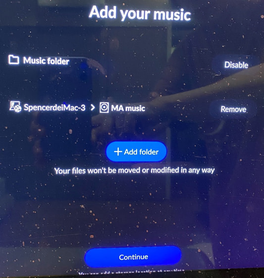

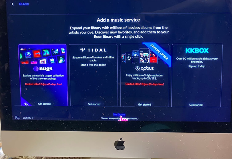

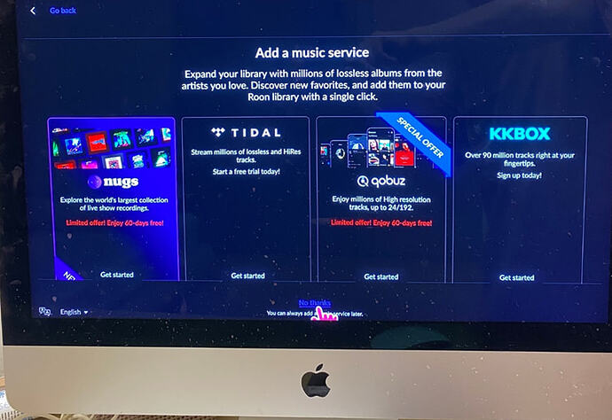

· I run my Roon on an iMac (MacOS: Sequoia 15.7.4) . Recently, it dropped out unexpectedly. I tried to reinstall using the latest version downloaded from Roon Labs repeatedly, but all failed. It just disappeared after I clicked the FINISH button. While the Roon server status showed running. Here are what I have done :
Run Roon and when it came to "Add you music", I clicked "Contiue", and then "Set up your Audio devices" I clicked "finish", then the next screen appeared only 1 second with No audo devices found and Manage audio devices showed in the bottom.
After above have done, Roon disappeared and could not be found. Have checked Roon Server Status : Running

Hi Noris, thanks for your reply.
I have tried to re-open Roon again, and the sequence is just the same as shown in the previous attached pictures. The result was the same when I clicked “finish”, it just disappeared again and Roon server status showed “running”. Please assist and thanks again.
