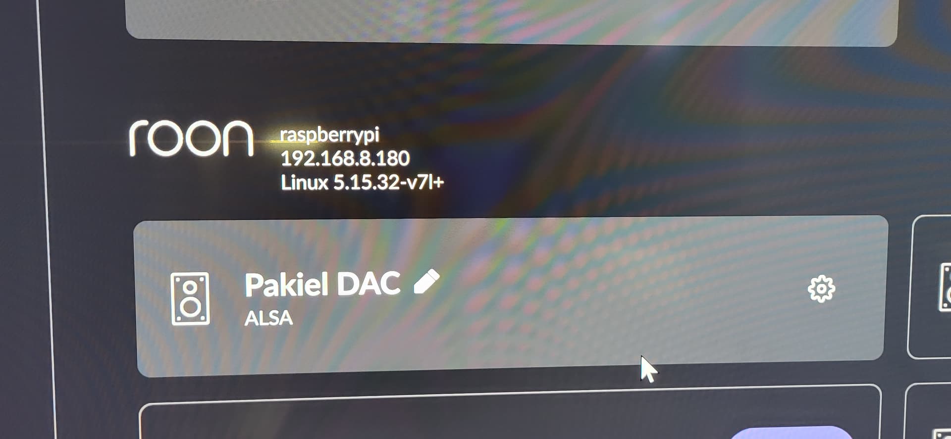

On a raspberry I have linux with roon display kiosk and roon bridge and I can't display. this happened a few days ago.
I will add that sound goes through the bridge.
Does anyone know the cause / solution?

I have a raspberry on it roon bridge and a browser with the roon display address entered.
Until last week everything worked fine, now it doesn’t display.
The roon display address also displays strangely instead of 192.168…, it is 127.0.0…
It looks to me like a bug in roon…

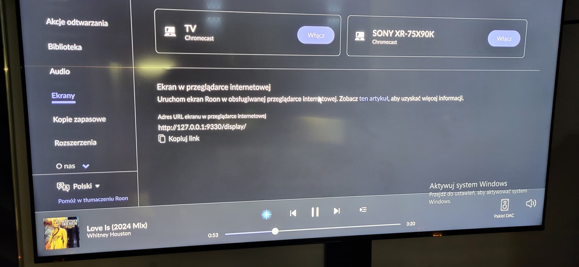

Currently, the IP that roon gives looks different than usual 127.0.0.1:9330/display/.

Could you share a screenshot of this page?
Thank you gentlemen for your advice.
Yes, I have Windows and Roon on it.
I am sending photos of how it looks in practice
It is true that when I enter the address 192.168.8.130:9330/display/ on another PC, the display works.

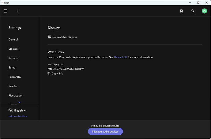

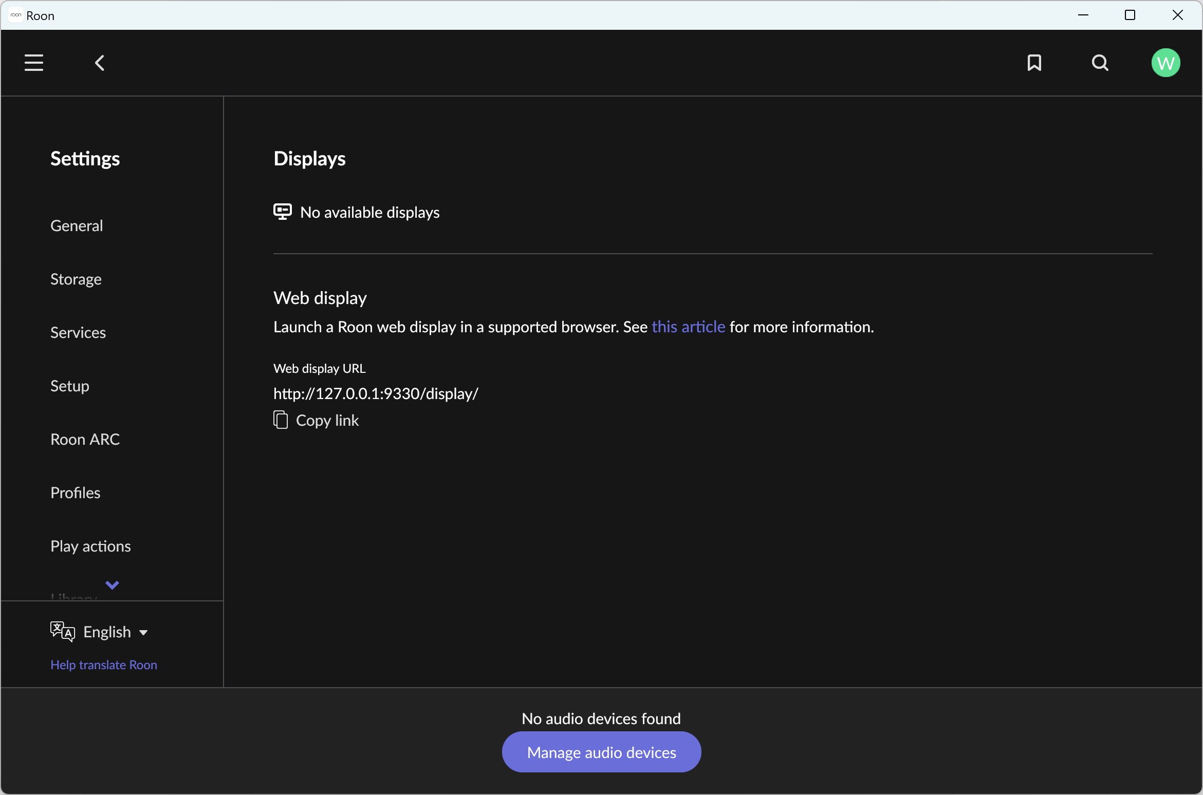

I have now been able to re-produce this issue with build 1470 of Roon Server and the Roon Client on Windows 11 23H2 build 22631.4460 (all updates and patches availble have been applied):
Running a Roon Client on the same computer as the one running the Roon Server and then going to Roon → Settings → Displays shows a display URL that employs the localhost ip address (127.0.0.1) instead of the ip address of the Roon Server on the local network:
Thank you both @Pawel_Majcherek and @Wade_Oram for the reproduction of the incorrect IP within Display settings when using both Roon and Roon Server on a windows machine. We’ve submitted a ticket to development for further investigation!
