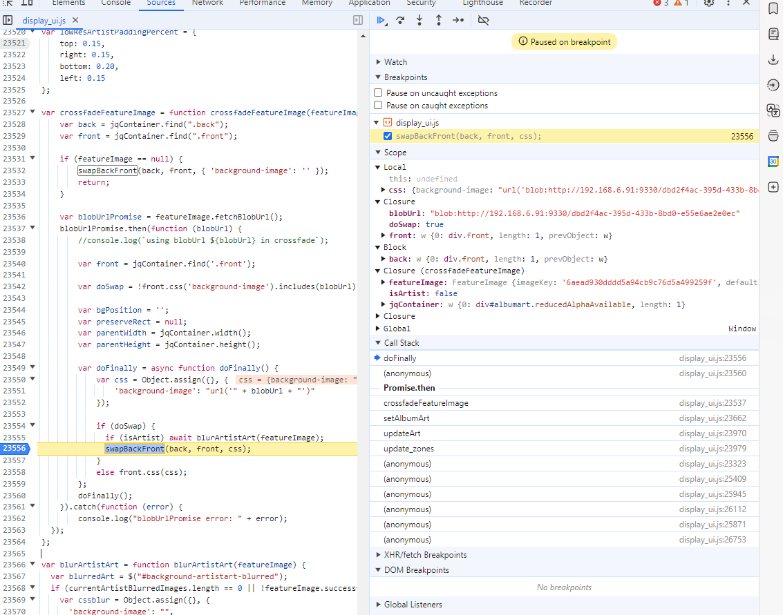

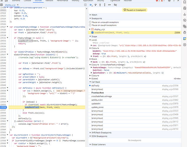

So here’s what’s happening. All you’re gonna see here is just me opening DevTools and analyzing display_ui.js.

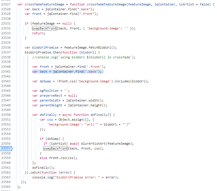

So you have this crossfadeFeatureImage function. That has this nested blobUrlPromise.then callback, and then a nested doFinnaly which is the problem. The main point is doFinnaly does a swap again, but that happens sometime later, after the Promsie returned by blurArtistArt is resolved.

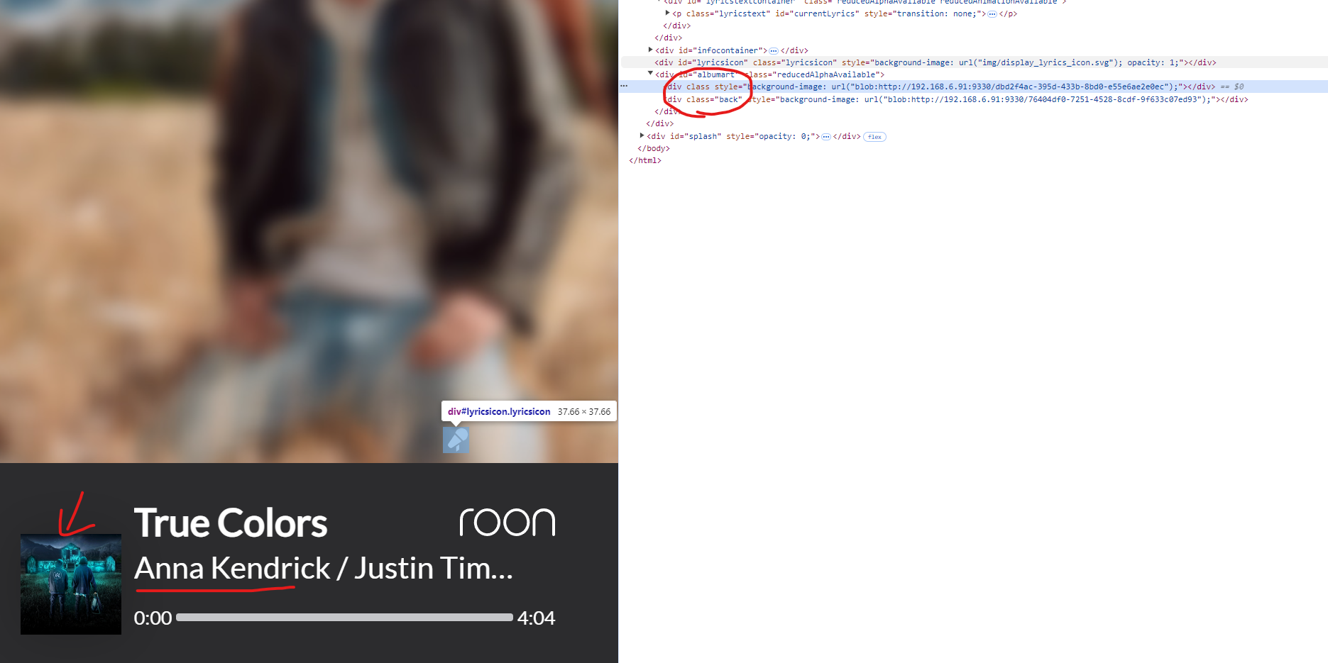

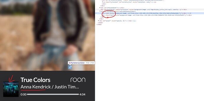

Now very importantly the then-callback closes on the back variable from the outer scope, but not the front one. Which means that when blobUrlPromise callback runs, the front div will be reevaluated, but not the back. Or more concretely, if we happen to do a swap, then another in a very short time, before blobUrlPromise resolves (this is most often the case if you go back to a previous track), the back variable will actually hold the now-front div (we’re after the swap). But front is running the jquery selector again, meaning that will also hold a reference to the very same div. You can see this in the screenshot, both variables have div.front.

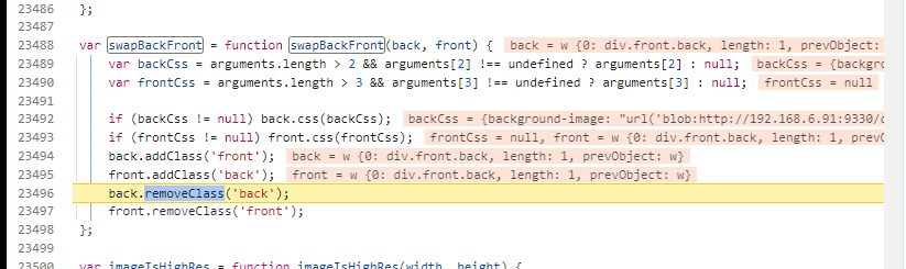

Now if you swap a variable with itself, it’ll lose it’s class attribute, due to how that function is implemented, pretty self-explanatory:
Leading to the end result, where one of the divs don’t have a class attribute, this makes the other one stuck there permanently as any future swaps will not find .front.

Just put both variables in the closure. Or neither. Doesn’t matter, it’s the same 2 divs anyway. So either add this line, or drop the other one, too.

If you perhaps care to properly solve the problem, here’s some advice on how to do it. The issue is that you’re doing fire-and-forget promise continuations that depend on the current state of the DOM. That swap on line 23557 in the screenshot should only run if crossfadeFeatureImage hasn’t been called again since. Some options:
  1. Make the entire crossfadeFeatureImage stack async, and queue invocations (e.g. write a wrapper) in a way where calling the next one will first await the last invocation. This is the elegant solution. Something like:

  3. The lazy way is to just add a reordering-check. You either have a global / module variable, or an equivalent like a custom jQuery .attr('data-swap-order') on the parent element, which you always increment by 1 on line 23535. Then when you’re done with your async thing and want to modify the DOM again (line 23557) you first check if that attribute has changed since. If it did, you do nothing, it means another crossfadeFeatureImage is underway. If it’s still the same then you do the second swap.
    You kinda do something similar with that doSwap variable but 1. it’s not checked at the right time in case isArtist == true 2. you still update CSS even if it’s false, so it probably does something different, I did not investigate too much.
