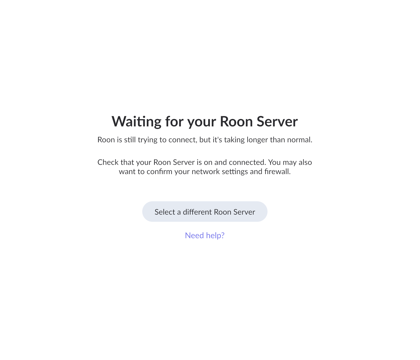

· When I try to start Roon I get a message "Waiting for your Roon Server..." Roon is trying to connect etc
· Charter modum, Netgear devices in the house. Everything works perfectly except Roon which will not start. Can run Qobuz directly to Moon Ace and it works fine. When attempting to open Roon on my Mac I can't even access "About Roon" in the Apple menu
What happens when you “Select a different Roon Server” and choose your server (again) from there?
