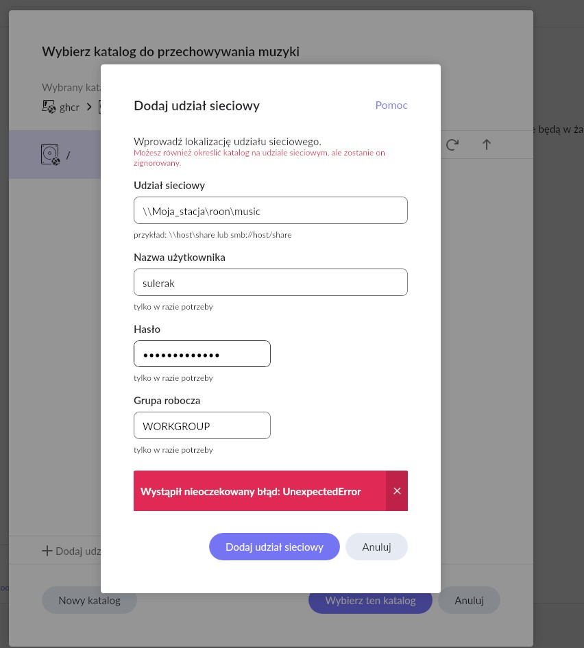

· I noticed that Roon installed on a Synology NAS (Docker) DSM 7.1.1-42962 Update 9, image gz1903, stopped seeing the library, which is also on the same NAS. When I try to add a network folder, I get an UnexpectedError message. The server itself works fine, but it only plays Tidal.

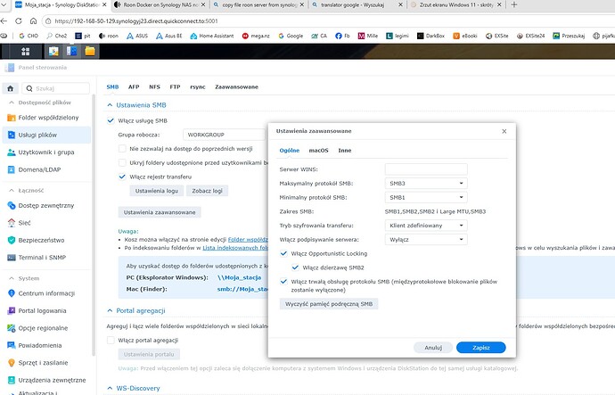

Second, you should not be using an SMB share at all here. Your music is on the same NAS that runs the container. Reaching it over the network means Roon leaves the machine and comes back to it, which requires the container to have special permission to mount SMB filesystems, a working account and password, and the NAS’s SMB service behaving. All of that to reach a disk directly underneath it. Your screenshots show what that costs: the music share returns UnexpectedError, and your backups to the same NAS last worked on 4 August and failed on 12 August. One cause, two symptoms.
Pass the folders into the container instead and Roon sees them as ordinary local storage. No network, no credentials, nothing to break.

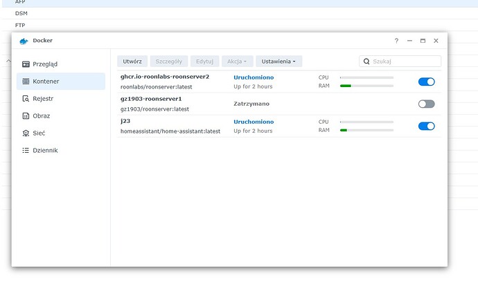

Thanks for the reply, but I wasn’t able to download the image via Docker. None of the addresses are working. Maybe there’s a file with the image to download somewhere. Should I try installing from a file?
Hello @Jaroslaw_Karelus
You are on DSM 7.1.1, which means the legacy Docker app rather than Container Manager. That app has known trouble pulling images from GitHub’s registry through the Images tab and the Add From URL box. We have seen this several times from other Synology owners on your DSM version, and it fails the same way every time regardless of how the address is typed. Our own Synology guide still recommends that route, which we are getting corrected.

I managed to install your Roon server(THX), but I still can’t add any network folders. How can I copy files to the container directory music?

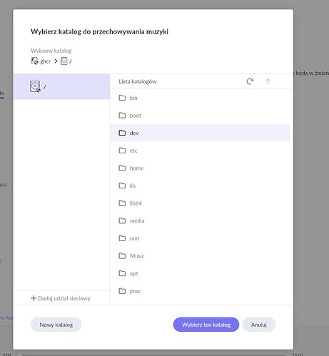

The problem is that you can’t see any other directories besides the ones from the container
Then your mapping of the local music folder is probably not working.

Only seeing the container’s own folders means the folder mappings from vadim’s step 2 didn’t take when the container was created. Roon Server can only see paths mapped in at launch, that’s also why Add Network Share throws the UnexpectedError, so please leave that path alone.

The important thing is that you are looking for something that should not be there.
When you map a folder into a container, you give it a new name inside. Your Synology folder /volume1/music becomes /Music inside the container. It is not a copy and it is not a different place. It is the same folder and the same files, reached under a different name.
So this is correct and expected:
Inside Roon you see:     /Music   /Roon   /RoonBackups
You do not see:          /volume1/...  or any other Synology folder
Roon can only see the folders you mapped. Everything else on the NAS is invisible to it, by design, and that is not a fault.
