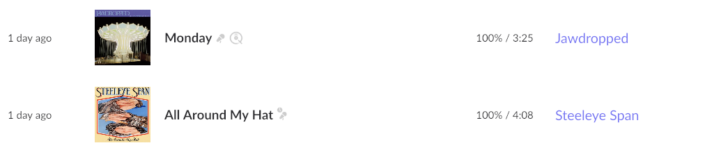

However, here’s how the two songs from last time show up in my history: The Steeleye Span track is a local Mp3, and the Jawdropped song is on Qobuz. In this instance, when I noticed that “All Around My Hat” was not advancing, I put it back to about 3:58, let the last 10 seconds play again, and then it advanced normally from there.
