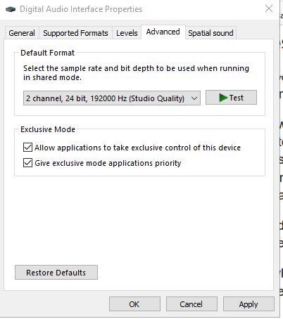

Stop Roon, disconnect your device, uninstall any specific driver that came with the unit. Plug it back in and it should show up under Windows ‘Sounds’ as USB Audio device
Then got to ‘properties’, uncheck the ‘supported format’ boxes
Go to ‘Advanced’ and check ‘exclusive mode’ both boxes, for testing purposes select a common value for playback like in the following pic and run ‘Test’
If it plays a sound, Win10 audio and your devices including cables work and you need to focus on Roon.
With that cleared up, you can go and fire up Roon again and take it from there.
If not there could be a hardware problem with your devices or they need a specific WASAPI driver from the manufacturer that you can install. Run the whole test series again and see what you get.

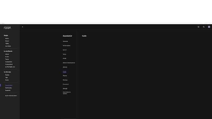

Make screenshot of “Audio” section in Roon settings. Are there any other PC built-in audio devices, “System Output” or something?

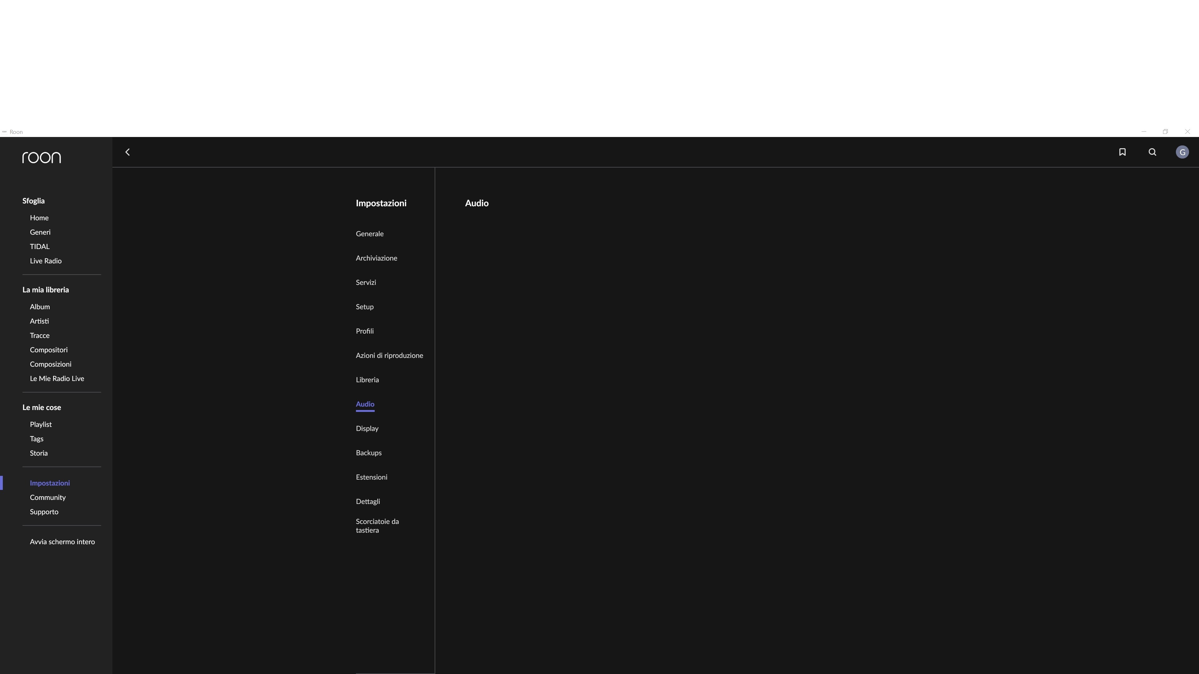

Hello,
I also tried an older version of the usb driver that I still had on the 4.80 computer and it failed.
And here is a screenshot of the audio settings.
As you can see, everything remains as it is, and the audio management button does nothing when you click on it.
In the meantime, it also rejected the Ipad that was briefly visible in the audio settings yesterday, but did not want to connect.
