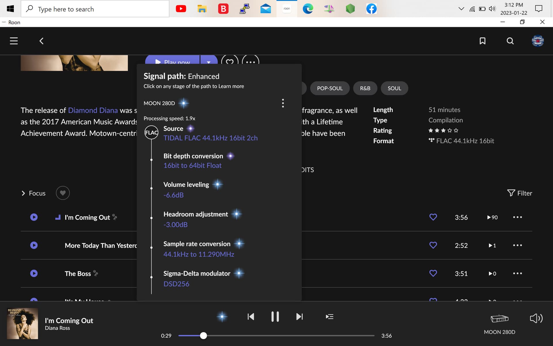

@Martin_Webster. I added the information you asked. Is there somebody out there with a solution?
What is your proccessing speed for dsd 256 when you say it works for about 30 to 50 seconds
Also what is your firmware on your moon mind.I have the most recent with 2.02.
Your pretty low there yourself at 1.9x

I’d be very interested to see processing speed in dsd128 and then the dsd256 it falls down on.
You might just get away with 1.2x but that’s pushing danger zone territory.
This seems to be the problem. The processing speed drops to 0,9x with DSD256 as with DSD128 it is still 1,9x!!!
What can I do about this?
