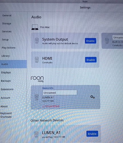

Hello,
Actually I’m using Roon (01 month free) to play music from Mac mini to Lumin A1. However Roon said that Lumin A1 is uncertified. I tried a lot of ways but unsuccessful, could someone give me some advices or any ideas about this problem. Thank you very much for your help.
Hereby is the picture of this, don’t hesitate to ask me if you need more information, thank you:

While I check the unexpected uncertified status for you, please give it a zone name, play something to this Lumin zone and see whether the actual playback works for you.
Hi Peter @wklie,
Thank you for your advice. I’ve just tried as your suggestion, give a name and play few songs and it’s still here. I’ve even restarted both mac and A1 and the same thing appears as below:
Does the playback work ok, despite that status?
Yes, it works perfectly despite this message.

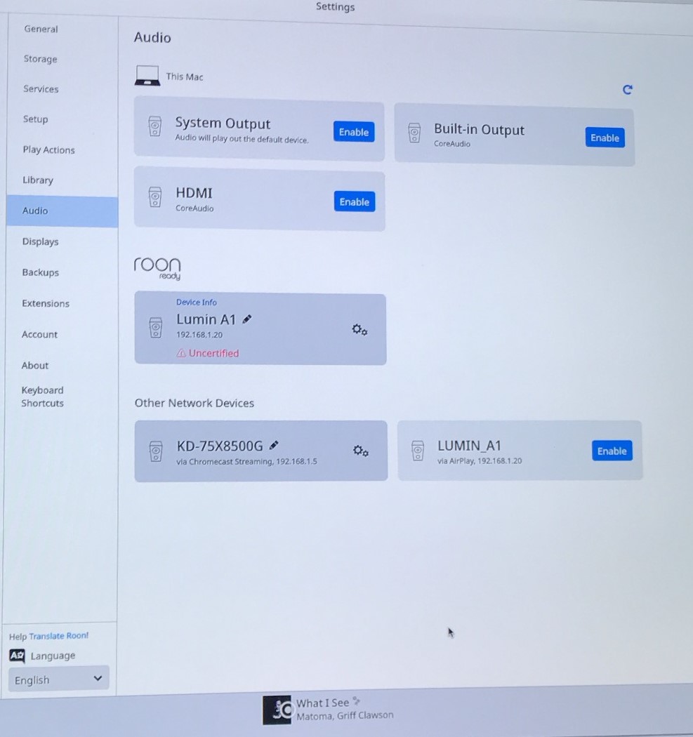

Perhaps support will take a look at it and enable diags to see what is happening. lets give them a day or two to come back from the weekend.
Please disable firewall in your whole network, including the Mac and router.
In Roon Settings -> Audio -> Roon Ready -> Lumin A1 -> gear icon -> Device Setup, tap Load Defaults.
Thank you very much for your help Peter, I tried and It’s still not yet solved. But dont worry, it works perfectly despite this message, so I’ll take time to try and solve, maybe upgrade mac OS.

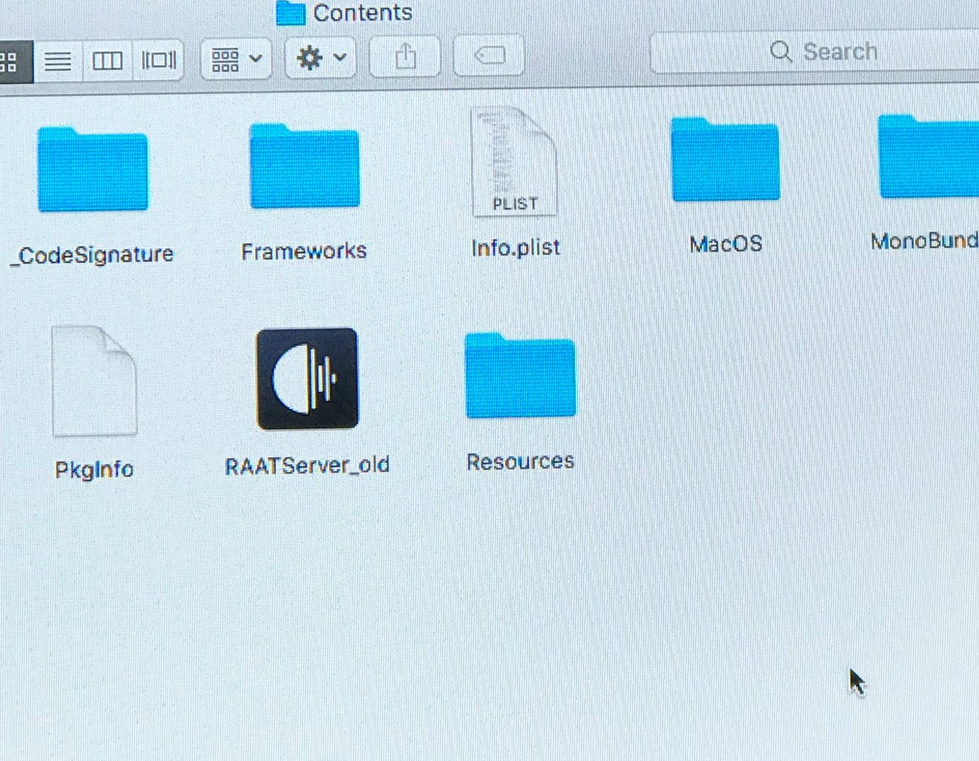

Please
  • Shutdown Roon Core
  • Make sure firewall and antivirus are disabled
  • Navigate to your Roon’s Database Location: https://kb.roonlabs.com/Database_Location
  • Reboot your Mac
Hey @Lesailes_Pham, I second @wklie’s suggestion here. Please let us know if this helps!
