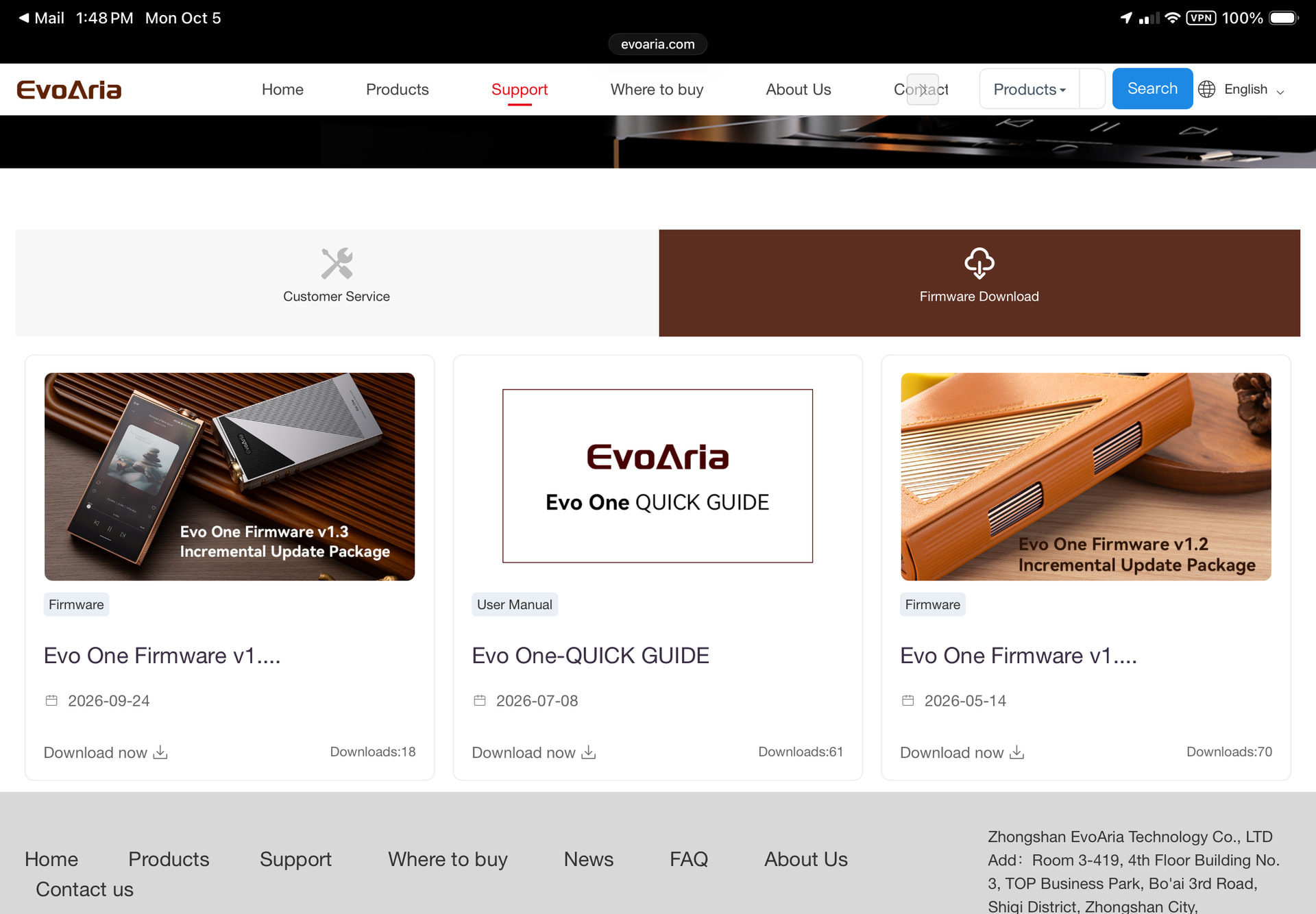

Thanks, Connor. I tried the manual firmware reinstall, but unfortunately I hit another roadblock.
I downloaded EvoAria’s current v1.3 firmware ZIP and attempted a Local Update from the microSD card, following EvoAria’s instructions and leaving the package zipped. The Evo One recognized the file and gave me the prompt to restart/upgrade, but the installation then failed with simply “Upgrade failed” and no further details.
Since the unit is already running v1.3 from the previous OTA update, I’m wondering whether the local updater simply won’t reinstall the same firmware version over itself.
I considered doing a factory reset, but as I understand it, that would wipe the user configuration while leaving the currently installed v1.3 firmware in place, so I’m not sure that would accomplish the clean firmware reinstall you were suggesting.
EvoAria also still provides the v1.2 full firmware package on their site. One possible route would be to install the v1.2 full package and then install the v1.3 update locally from the SD card. However, I don’t want to attempt a firmware downgrade without confirmation from EvoAria that v1.3 → v1.2 → v1.3 is a supported/safe procedure.
So at this point I’ve been unable to perform the clean v1.3 reinstall. Since your diagnostics show that the Evo is incorrectly announcing only 44.1kHz/16-bit capability and is also sending blank uniqueID and deviceID fields, would you be able to reach out to EvoAria as you mentioned? It would also be helpful to know whether they recommend a factory reset or support the v1.2 → v1.3 reinstall route.

Please let us know how 1.30 got onto your Evo One: through the device’s own update, or from a file you downloaded, and from where. EvoAria lists 1.21 as the latest on their side, so we want to confirm which package you are running.
I used the OTA update function on the EvoOne on the day it was released or the next day.
I’m not sure how they can say 1.21 is the latest, their own site lists 1.3 to download.

Thank you, that clears it up. Your Evo One got 1.30 through EvoAria’s own update, and their download page also lists firmware v1.3, so you are running a package they publish. The unit our partners tested first was on 1.21, which is why it did not match what you see.
We also tried installing v1.3 on two Evo One units that were on 1.21, and the update failed on both, so the “Upgrade failed” message does not look specific to your unit. We have shared this with EvoAria already, but the firmware is theirs: Roon cannot change what the Evo One announces or roll its firmware back. The next step has to come from EvoAria.
