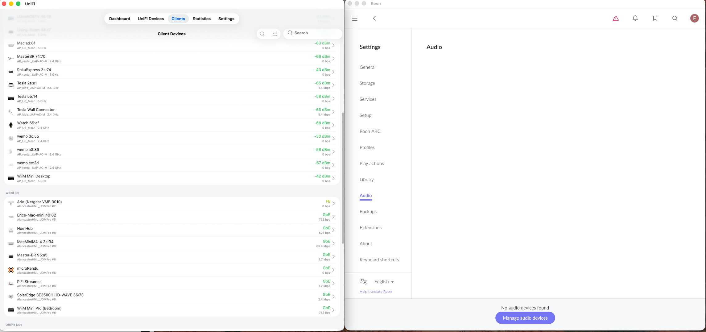

1GB fiber connected to a Ubiquiti UDM-Pro router. Most of my endpoints are connected via GbE.
The image below shows a number of endpoints that are clearly connected to the network (see lower left frame, MicroRendu, Wiim Mini Pro, PiFi Streamer, etc.)
It’s clearly not a network issues as I can ping all of these devices without issue. But as you can see the Roon client doesn’t see any network devices. these will often reappear after restarting the core but then the just disappear again.
I’ve had major issues with Roon Core since the April update (see other thread that IMO was prematurely closed).
Oddly enough, when I remote into the unit that is running Roon Core and open the client there it does see the endpoints, but none of the other client devices (macOS and iOS devices) can see the endpoints.

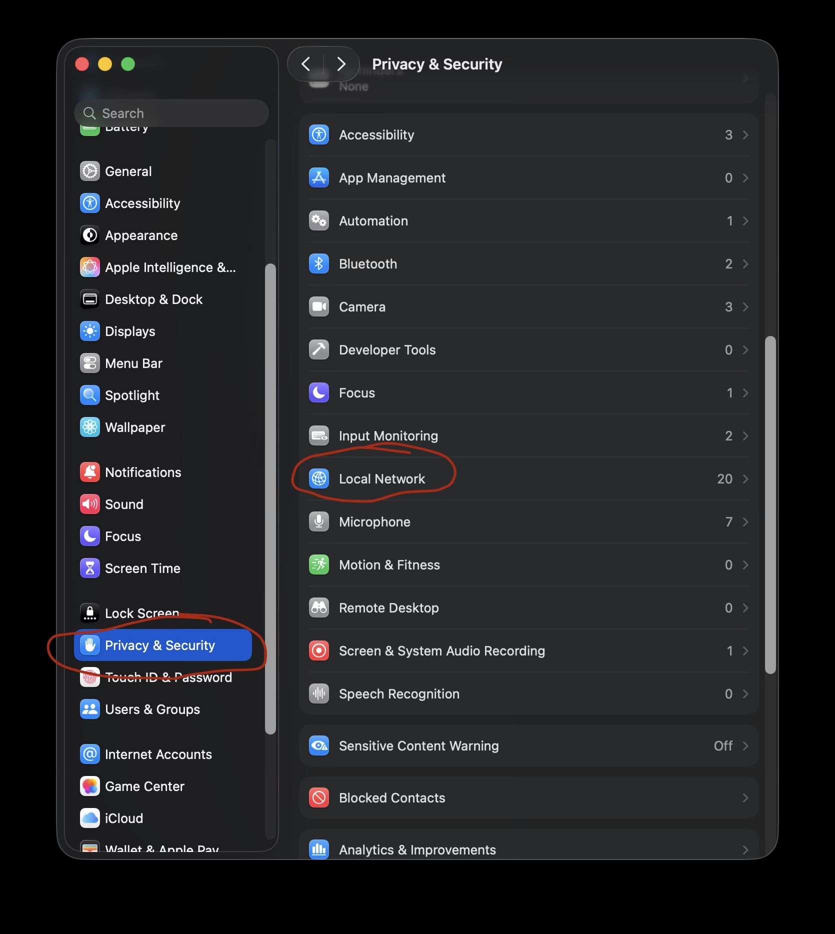

Since you’re running macOS, the behavior you’re seeing is consistent with the newer, stricter Local Network permission controls in the recent macOS releases.
Please try the following steps:
  1. Open macOS System Settings → Privacy & Security → Local Network
  2. Make sure Roon and Roon Server are both enabled
  3. Even if they are already enabled, please toggle them off and back on
  4. Fully quit Roon Server from the macOS menu bar / task bar
  5. Reboot your Mac
  6. After reboot, launch Roon again and check if the devices is avaliable again.
Once these permissions are refreshed and the system restarted, your audio devices should reappear.
Please let us know if the issue persists after these steps, and we’ll continue from there.

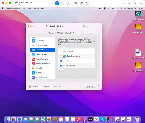

OK … I’m assuming this is correct under “Full Disk Access”? That seems to be the only place I can enable Roon and Roon Core that I see.
I’ve reset and restarted and will follow up (it always works after a restart but eventually disappears later).
Will keep you updated.

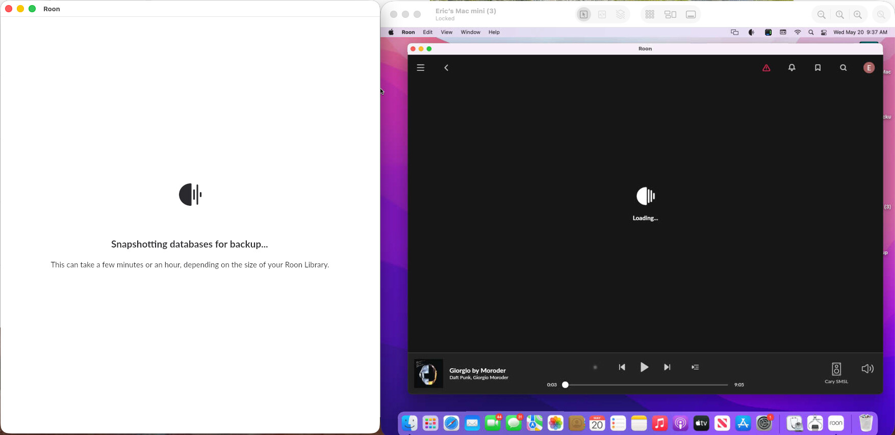

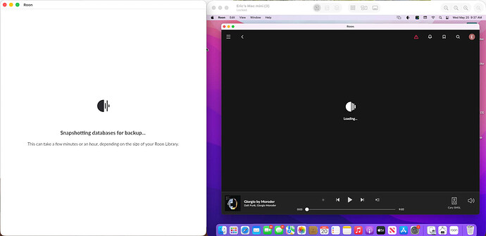

So far I’m not having the issue with the endpoints vanishing, but instead the macOS clients do this:
The image on the left is a macOS client (MacBook Pro) and the image on right is the client running on the Roon Core machine.
I’ve let it run for hours and it doesn’t ever finish. Ultimately end up shutting down the Roon client and restarting the Roon Core to bring it back online

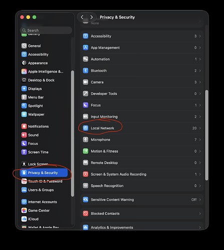

No, it should be under macOS System Settings → Privacy & Security → Local Network. What’s your macOS version?
Hi @Eric_Taylor,
@Suedkiez is right here. Please retoggle Local Network access for both Roon and Roon Server, and make sure it stays on.
Thanks.
@alex_h & @Suedkiez

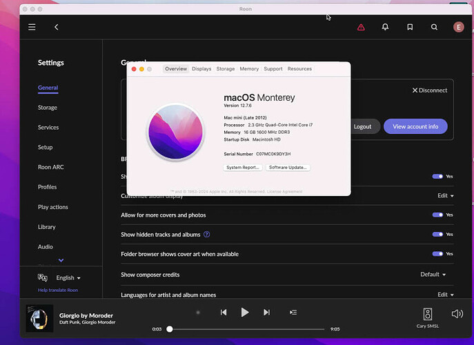

I’m running 12.7.6 Monterey using OCLP (see my previous post for a full debrief on why)
That option does not appear in Monterey :cry:. Do you know what version does provide this option?
That’s okay then and a good thing, because this additional annoying (because it keeps having to be retoggled and apparently can’t be avoided) hurdle was added by Apple with Sequoia. So, whatever the issue is that you are experiencing, at least it can’t be this.

Looking at your latest screenshot, I want to clarify one very important point: The “Snapshotting databases for backup” message explains why the client is stuck. When Roon performs a database backup, it pauses database operations to ensure data integrity. During this time, the Roon Client will show that “Loading…” status indefinitely because it cannot interact with the Core while the snapshot is in progress. If your library is large or stored on a slower drive, this process can take significant time.
Regarding the endpoints vanishing: Since you are using OCLP to run Monterey on unsupported hardware, please keep in mind that network stack stability can sometimes be affected by the patches used to support your specific hardware. If your endpoints continue to vanish outside of backup windows, we strongly recommend migrating to a more stable, natively supported platform. Given the complexities of running patched software via OCLP, the most reliable way to ensure a consistent experience is to move the Roon Core to a dedicated, officially supported environment.
