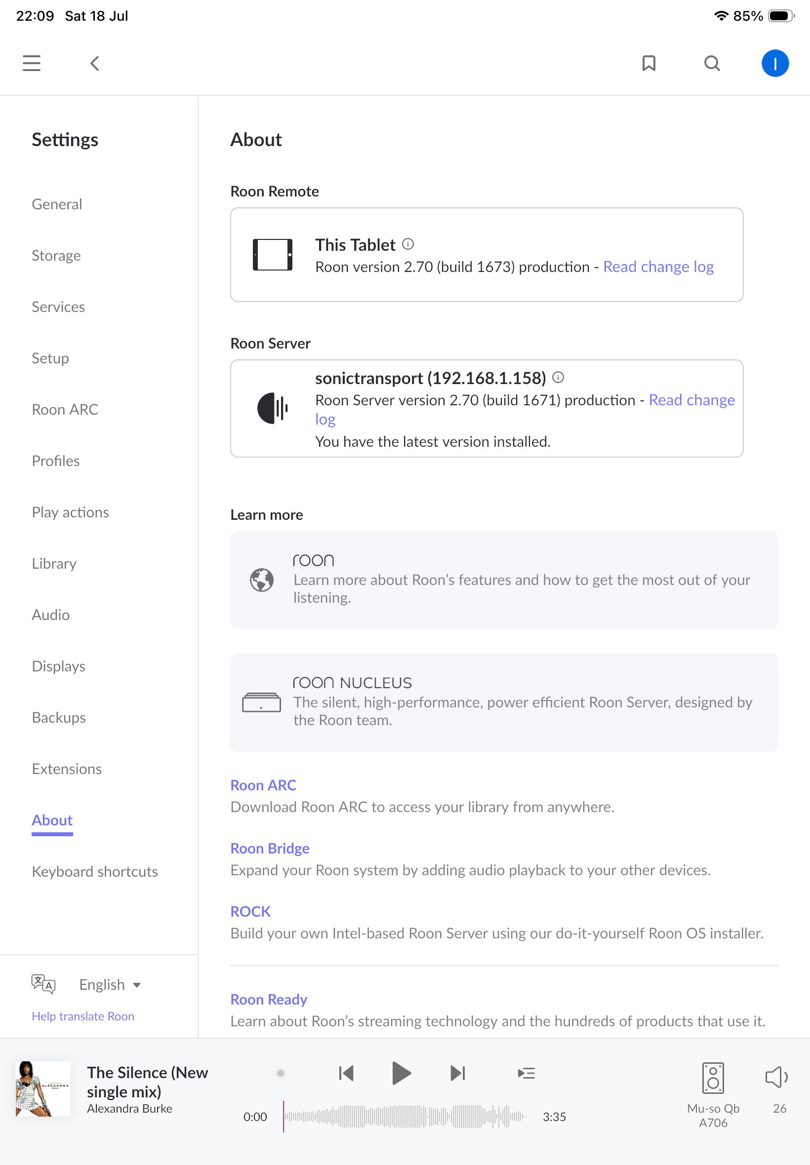

· Roon core server is an Audiostore Prestige 2TB server running Roon Server version 2.70 (build 1671). It is connected via a Cat6 wired network via a Mac mini m1 to our old Naim Dac-V1 (new in 2012), Naim Nap140 power amp and PMC wall mounted speakers. With Roon Remote running on the Mac mini, it performs flawlessly.
The same server is connected via Ethernet and fibre optic to a Sonore OpticalRendu then out to a Chord M Scaler, Chord DAVE dac and then to a high end hifi. I can see the server and the opticalrendu on the network via the sonicorbiter app. The opticalrendu is running Roon Ready 1.1.47, yet no matter what I do, I can’t see it as an audio zone on the Roon control app on either my iPad (Roon 2.70 build 1673) or on my iPhone.
The same server is connected over wifi to our old Naim Mu-so Qb 1st generation (new in 2016). The Roon control app on either my iPad or the iPhone can see the Mu-so Qb and I can select it as an audio zone, both directly as a Roon ready endpoint and also as a device via airplay2. However, I can’t play any music through it.
In summary, I can’t play music via the DAC-V1 but not on the main hifi or the Mu-so Qb. I suspect it’s an issue arising from one or more software updates, rather than being an issue of faulty hardware but really need help to get either the Mu-so Qb or the main hifi to connect again.
