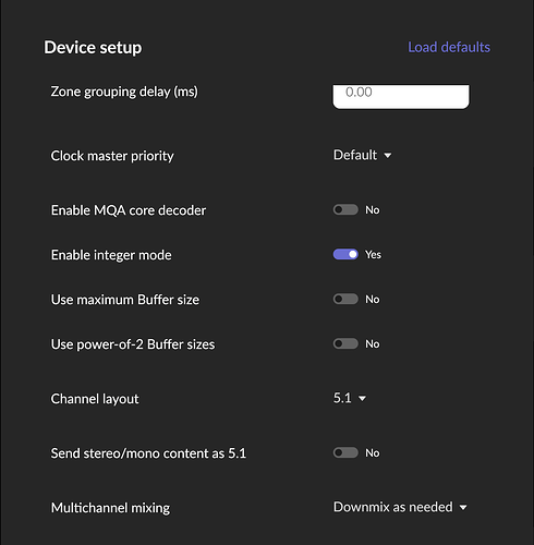

Can you lastly share a screenshot of your device settings>advanced>multichannel mixing?

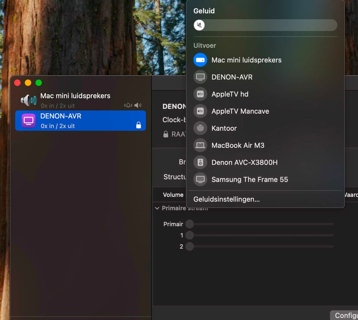

One more thing I ave noticed: after the switch to stereo, the output device in Roon is still the Denon, but in Mac OS the output device has changed to Mac mini internal loudspeakers!! (with an exclusive lock on the Denon).

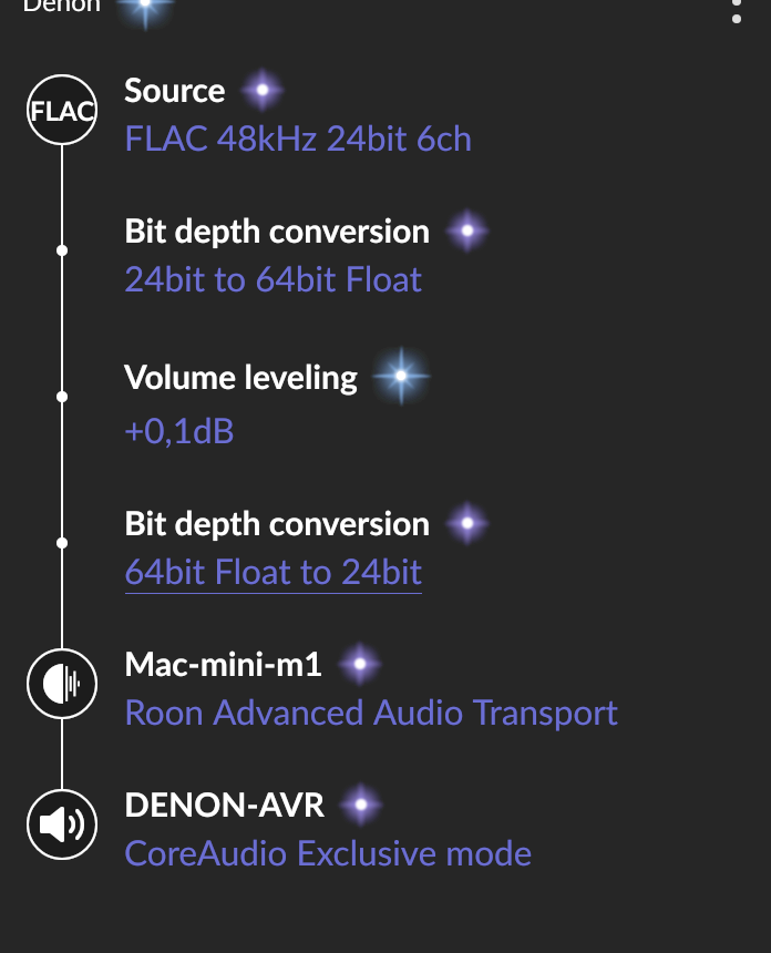

After all of this, Roon still says we have a 5.1 device:
The audio path says Denon:
Mac OS has switched to internal loudspeakers, but the Denon still receives the stereo signal.
