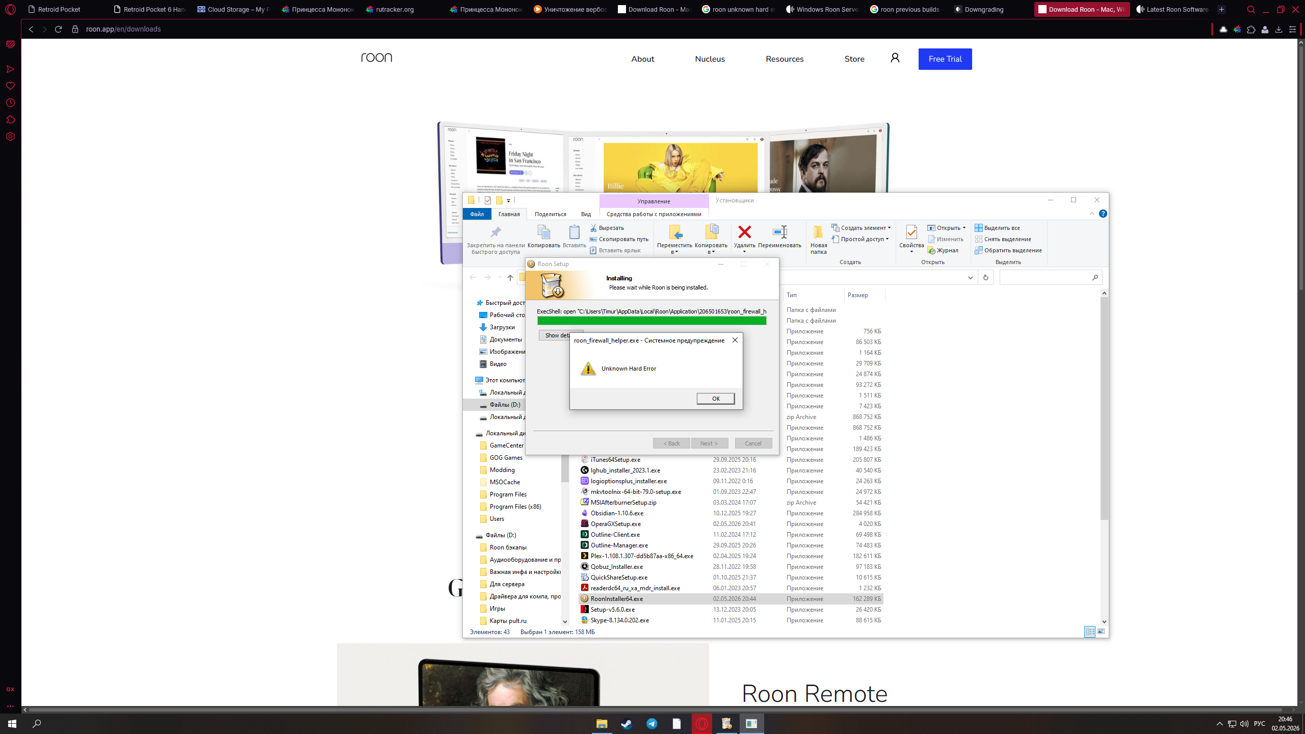

Roon.exe fails to open after latest update with 'unknown hard error' (ref#KWWMB5)
· After the latest update roon.exe doesn't open the program but shows a warning windows with the message "unknown hard error". I've already tried to reinstall, to fix and change some parameters in windows registry and even system rollback - nothing worked

Thanks for writing in and sharing your report! Looking at your screenshot, I can see the “Unknown Hard Error” occurring when roon_firewall_helper.exe tries to run during installation. This is a specific Windows system-level error, not a typical Roon issue. Here are your next troubleshooting steps:
First - Right-click the Roon installer → Run as administrator. The firewall helper requires elevated privileges to register itself, and permission issues can trigger this error. See if you still have issues when trying this.

Hi, nothing worked. I tried a lot of solutions, including editing programs brandmauer, adding new rules for them, installing latest .net runtime, also tried YOUR solution
I found this error in Windows Event with description “the process was terminated due to an internal erorr in the .net runtime at ip 0x00007FFAA5EF92EE with exir code 0x80131506”
