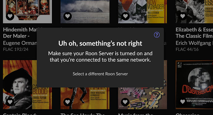

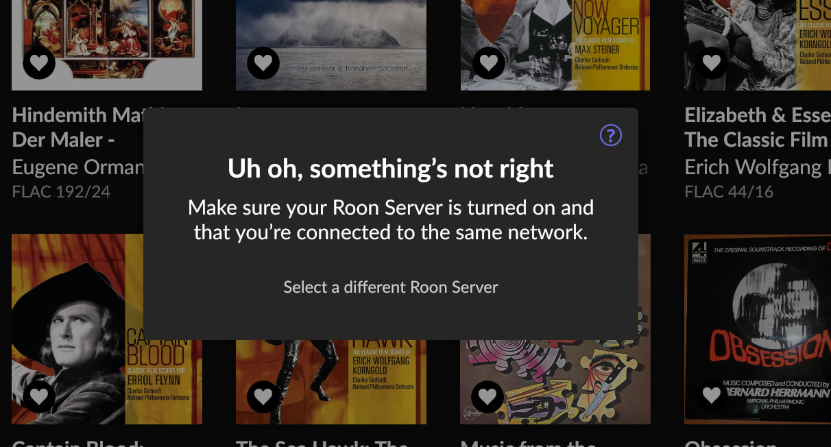

Playing direct to the eversolo I get frequent dropouts. Also twice today., ,my laptop and iPhone couild not find the server the server.. after a while it came back… this is something new and troubling. I still believe this is software and/or a server issue.
Seeing this frequently now… so it’s getting worse..
