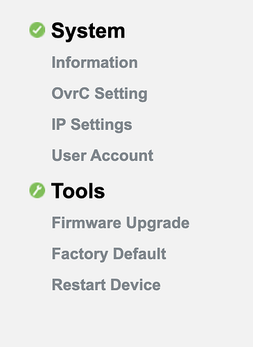

I have logged into the router and the setup page looks nothing like what you are showing me. See below.
@Mel_Martin ,
Querier settings should be somewhere close to the IGMP snooping setting there.
I’d try to look from “IP Settings” first.
If it’s not there we’d recommend to try to contact a manufacturer.
Is that possible for your case ?
Thanks.

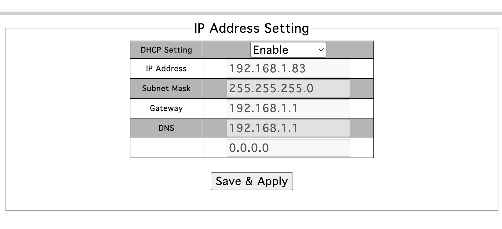

The settings are quite sparse… here’s what is under ip settings.
If they are still in business I’ll try and reach them. It’s been a very reliable router, and of course everything works just fine on it, except for Roon of course. There is a muni items called OVRc settings, but I have no idea what those are. They can be enabled or disabled.
@Mel_Martin ,
From the interface screenshot you have provided it looks like your Araknis switch is Unmanaged one.
Can you please tell us the full name of the model of the switch ?
Thanks.
Sure. It’s a AN-110-SW-R-16.
