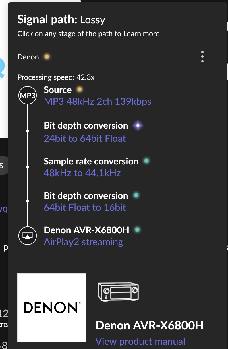

I recommend testing with another audio input available on the Denon X6800H, like AirPlay. Play a local file from Roon - can you reproduce any issues?
Now, test internet radio playback to the Airplay Zone. Do you have any of the same issues?

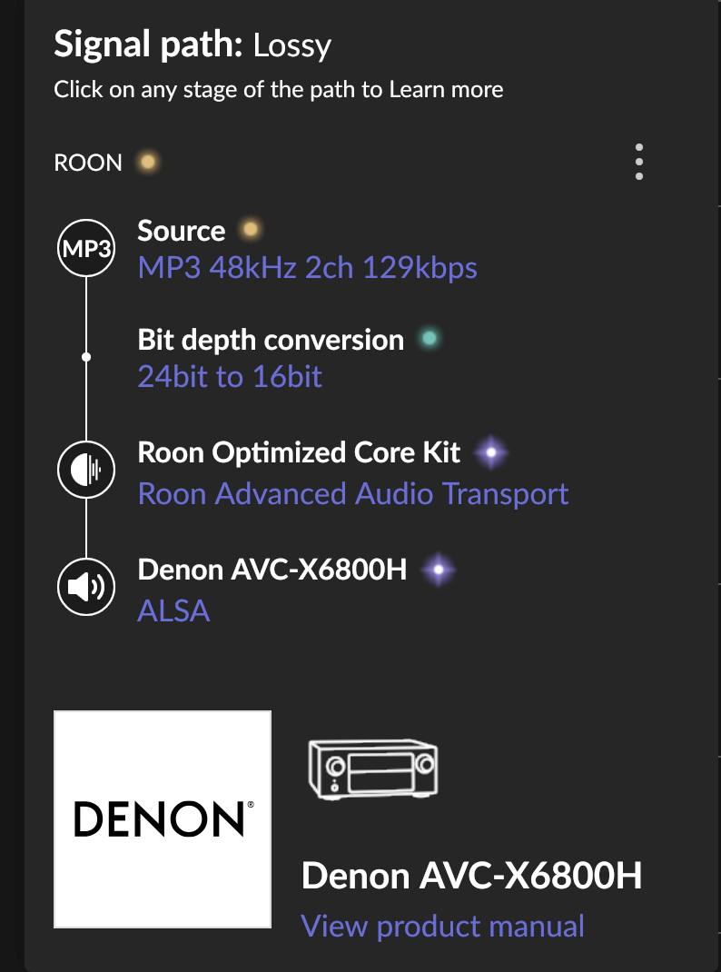

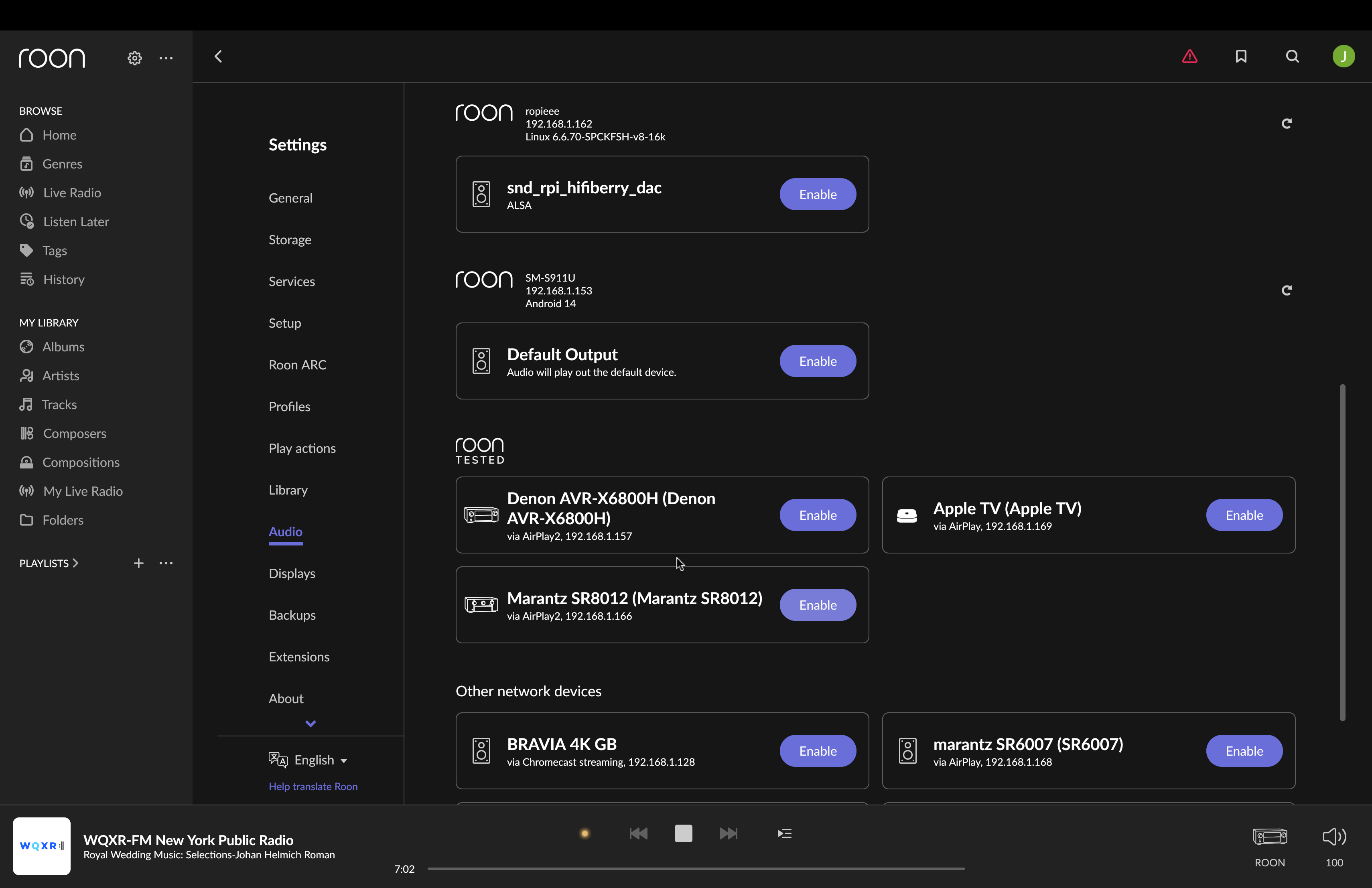

Please share a screenshot of Signal Path in the HDMI setup as well. Thank you!
Conner here r screenshots. THX
Conner, screenshot Airplay2 From Macbook Air M2.

Thank you for your post. To clarify - did you encounter any dropouts when using Airplay? What about when using HDMI? Please provide the name of the track was playing, if so.

Conner, Airplay 2 works fine no dropouts. The HDMI is the problem. FWIW, the Denon ethernet cable was plugged in to a network switch. I moved that cable directly into the Fios router. Now the NUC and Denon a plugged directly to the router. Same dropouts from the NUC.

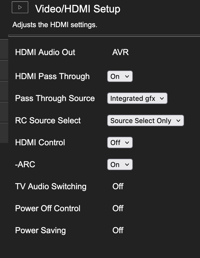

Ben, 3 different HDMI cables. In my Denon 6800h,
This setup allows HDMI audio uninterupted. However, no surround from HDTV. So this is not a Roon issue.
