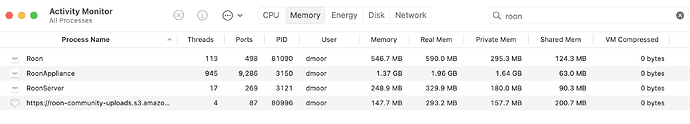

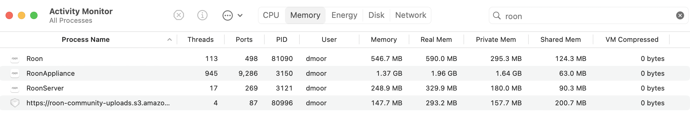

I suspect it might be helpful to the Roon support team if you could enable all of the memory-related columns you see in the screenshot below:
When you say reboot the Roon serve do you mean quit and restart Roon? The Roon process goes away but the Roon Appliance and RoonServer processes stay around.
Here’s where we are after a restart.

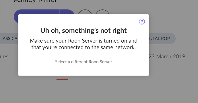

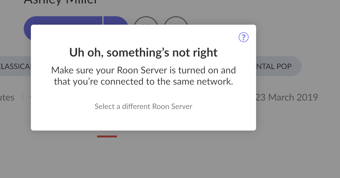

There is another issue which may or not be related to the memory leak. Roon keeps losing its connection to the server. When prompted to connect to a different server I chose the same one and it reconnects. Sometimes it will just reconnect without my doing anything.
