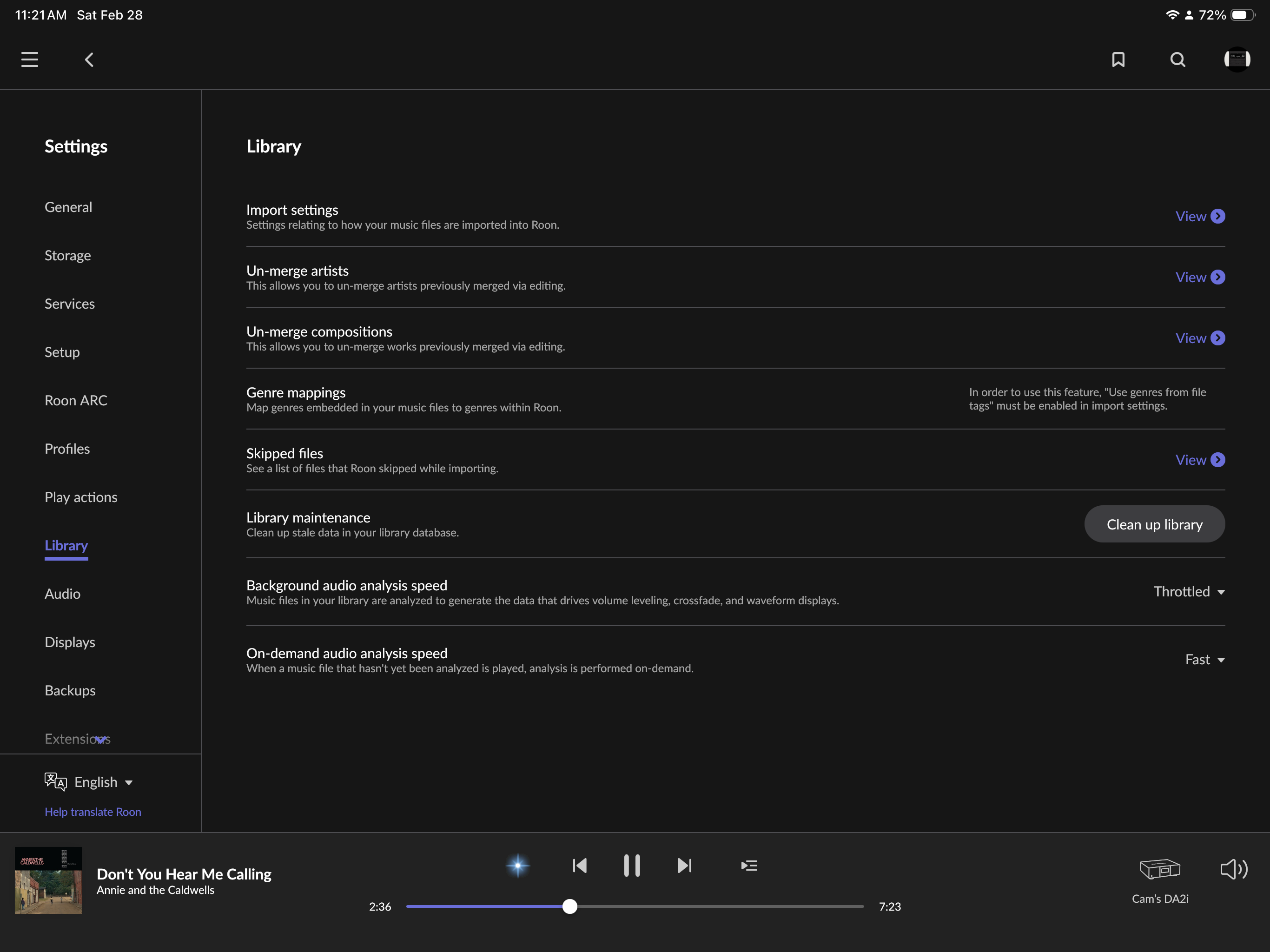

Is there any change in behavior if you try to navigate to Roon Settings -> Library and set both Background and On-Demand Audio Analysis to Throttled or Off?
· No, the issue is still the same

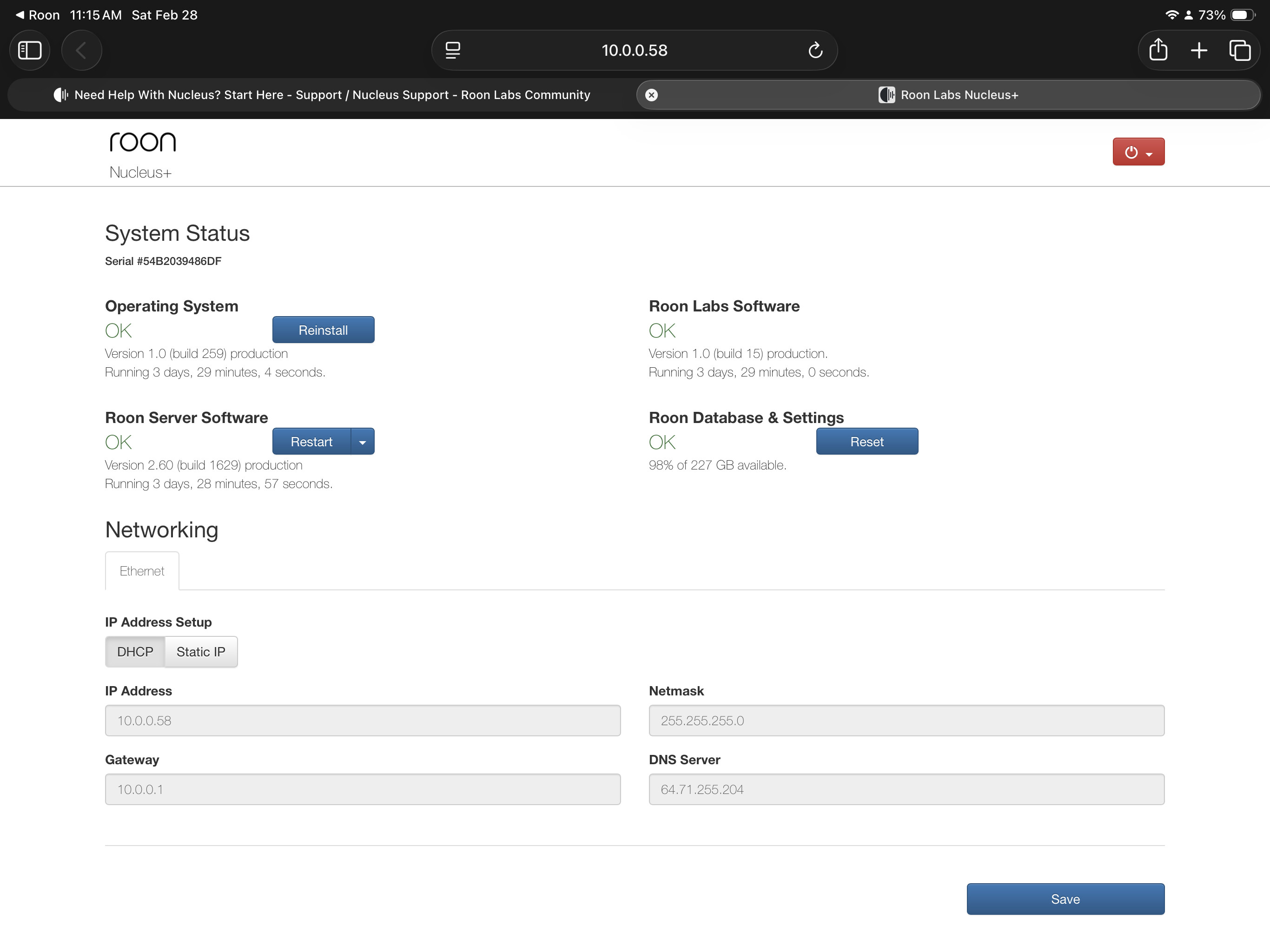

Router Domain Name System (DNS) change
· I was able to change my router's DNS servers but it did not help

Thanks, this is very helpful! Unfortunately I don’t think Rogers will not let me change the DNS service and it doesn’t give me access to the router settings, so I’m stuck with that. I am going to be busy for the next couple of days so I won’t be using Roon for about 48 hours. Hopefully that will allow it to catch up. I will report back in a couple of days.
Hello @Kerry
You can change the DNS settings directly on the Nucleus.
Here’s a step-by-step on how to change the DNS settings on your Nucleus:
Open a web browser on a device connected to the same network as your Nucleus.
  1. Enter the IP address of your Nucleus in the address bar.
  • If you don’t know the IP address:
    • Open the Roon app.
    • Go to Settings > Setup > Find Nucleus.
    • Note the IP address shown for the Nucleus.
  • Alternatively, use http://nucleus.local/ (on macOS or Windows with Bonjour installed).
  • Log into the Web Interface:
  1. Once the web page loads, you’ll see the Nucleus web administration interface.
  • Change the DNS Settings:
  • Scroll down to the Networking section.
  • If the Nucleus is using DHCP:
    • Note that you cannot directly edit DNS settings under DHCP. You will need to switch to a static IP to specify custom DNS servers.
  1. Switch to a Static IP:
  • Click on the Configure or Edit option under networking.
  • Enter the current network settings for your Nucleus (IP address, subnet mask, gateway) manually. These can often be found in your router’s settings or your current DHCP lease information.
  • Specify Custom DNS Servers:
    • Add DNS servers in the relevant fields. Common choices:
      • Google DNS: 8.8.8.8 and 8.8.4.4
      • Cloudflare DNS: 1.1.1.1 and 1.0.0.1
      • OpenDNS: 208.67.222.222 and 208.67.220.220
  • Save and Apply Changes:
  • Click Save or Apply to confirm your new settings.
Restart the Nucleus (make sure Roon Server is stopped) and let me know if you continue to experience stoppages when streaming
Thanks for this! Last time I tried this my ISP didn’t like it and blocked the connection to the new DNS. I guess some ISPs have built in security to force you to go through their DNS. I will work directly with them to see if there is a solution.
