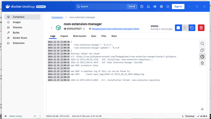

As a not very experienced user, I tried to install the extension-manager on Ubuntu using docker.desktop and I failed …
Maybe somebody has a hint where to look. Here the message:
Thanks in advance!
Hi @Markus_Kirchhofer,
When installing the Extension Manager you have to use the v1.x-standalone tag, the full name then becomes theappgineer/roon-extension-manager:v1.x-standalone.

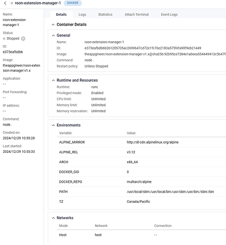

I’m having a problem with REM. I’m getting the “Extension Manager requires Docker!” error. I specify GROUP_GID=0 as an environment variable when I install it. It had previously been working and I tried reinstalling when I noticed the error. I didn’t need to specify group_id when I initially installed it a year or so ago. I’m not sure when this started as the Deep Harmony extension I use has continued to work. I’m using the v1.x image in Container Station 3 on an Intel x64 QNAP (TS-664). I’ve also tried the v1.x-amd64 image with the same result. Same goes for the standalone version.
Any suggestions would be greatly appreciated.
Below is a screenshot of my container details

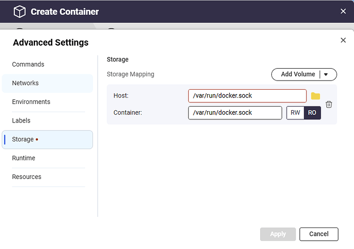

It seems this was a problem with the Container Station 3 GUI. Once I ssh’ed into my qnap and:
  • removed the old Container
  • pulled the new image, then
  • ran the docker command “–network host --restart unless-stopped --name roon-extension-manager --group-add 0 -v rem_data:/home/node/.rem/ -v /var/run/docker.sock:/var/run/docker.sock -e “TZ=Canada/Pacific” theappgineer/roon-extension-manager:v1.x-standalone”
    Everything seemed to work. I needed to remove the "–log-driver journald " option as journald wasn’t installed.
In any case I seem to be up and running again - now onto getting Deep Harmony working properly again as it also had stopped working - but now I have REM running properly, I don’t think that will present any major problems.
Bob.
Hi @Bob_Hornibrook
Good to hear you got it working again. The critical part is the mount of the docker socket, if that is missing the Docker installation cannot be found.
Maybe this part was missing in the GUI setup.

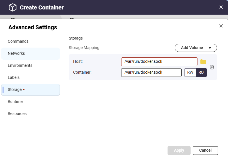

If I was to add it with the GUI, I assume it would be as a volume that mounts a host path, would this example below be correct?
Also is it read only or read/write?

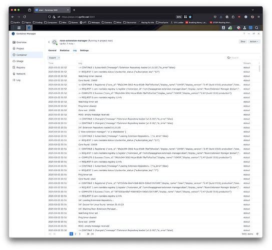

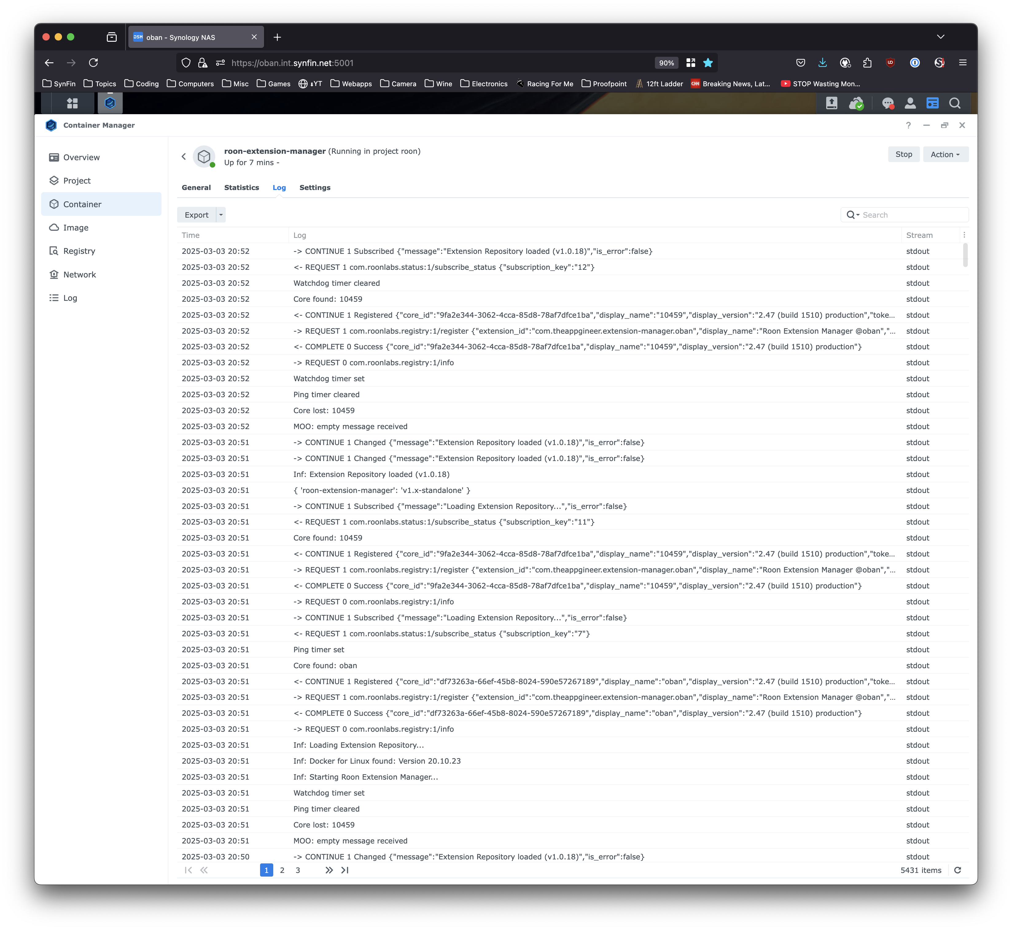

Anyone else noticing that suddenly today the Roon Extension Manager is crashing a lot? I used to see the occasional crash (no big deal), but it’s crashed probably 10 times today. Most recently at 8:51pm. Here is a screen cap of the logs from the docker container showing the crash & restart:
It’s seemed fine for me and I’m also using Container Manager on a Synology
