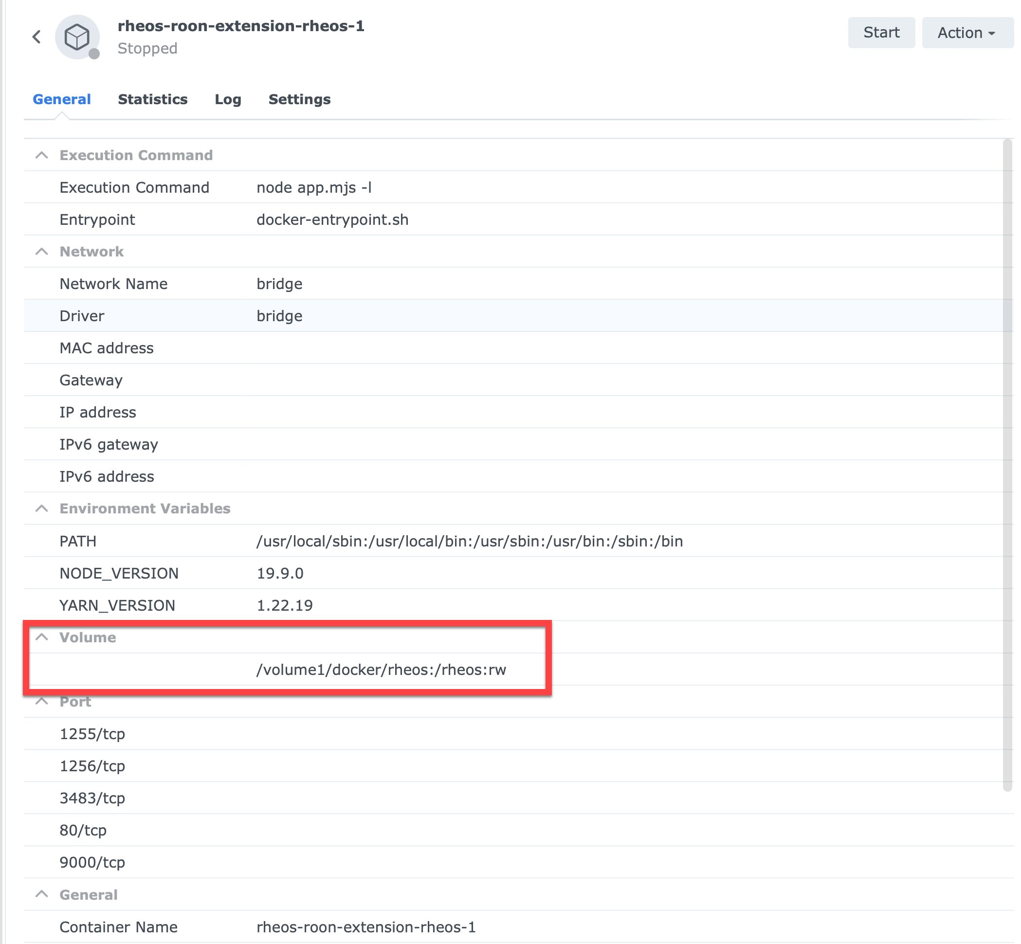

@Evan_Kohn1
Here is your issue. Do not map an rheos folder in the image… that method is for the option where you are going to install Peter’s files directly into a blank image…
Just remove the entire volume mapping highlighted below…
lets see if this gets you going or to the next error for us to fix :slight_smile:
