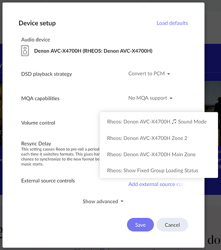

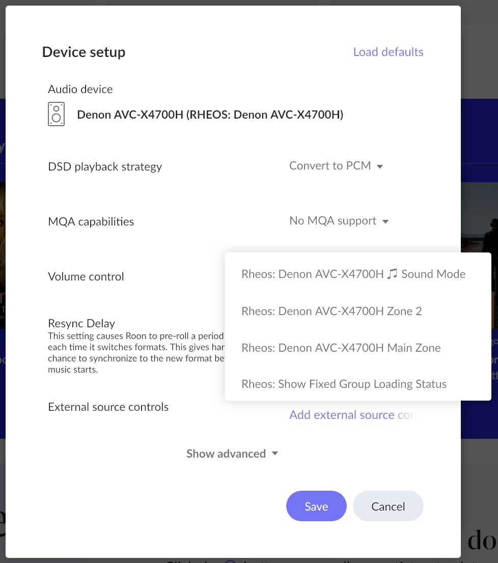

Hello!
Just unsure while configuring. What do I select here?
Thanks for testing. Add sound mode, Main Zone and Zone 2 as external controls.
I am working on making this more stable so please let me know how you get on. Which version are you using and set up?

Sound mode has disappeard.

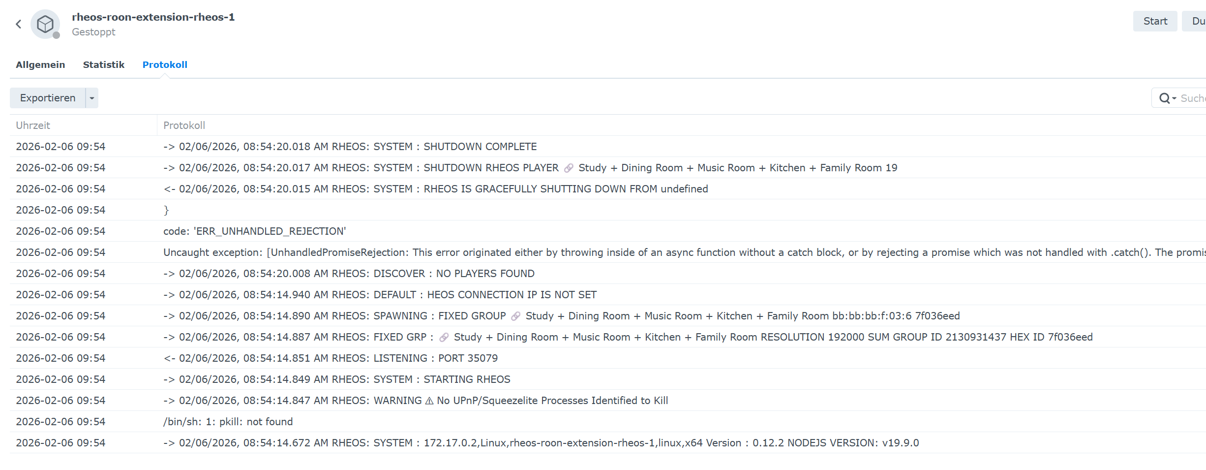

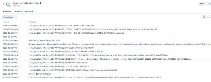

Tried the test version.
Got this error:
