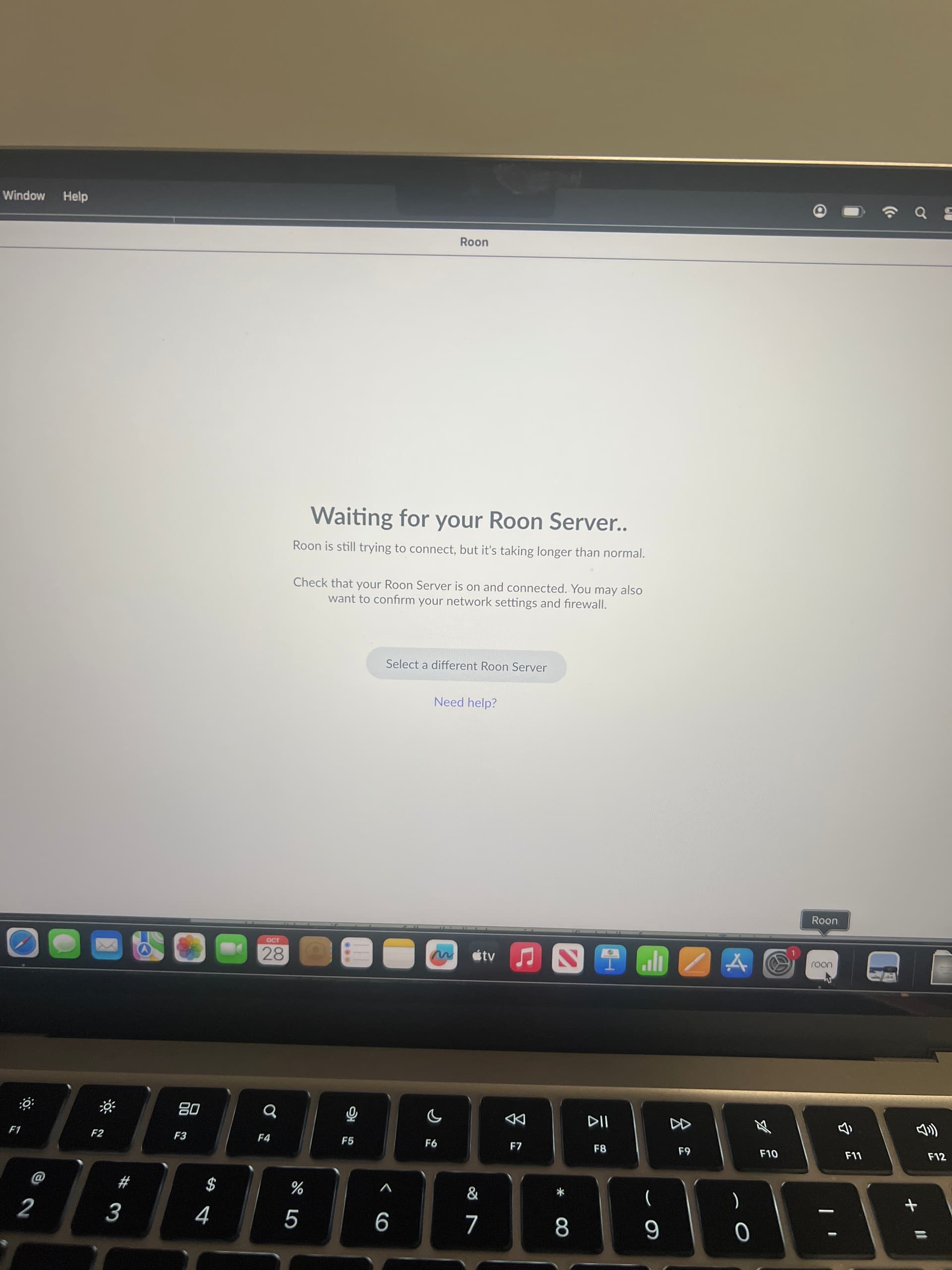

My Roon server is my Apple laptop.
It is connected to my network wirelessly and was working perfectly. I am using Roon on my mobile to control it remotely. It is also connected to the same network wirelessly and was also working perfectly. I do, however, usually use Roon directly on the laptop.
I am not very computer literate, I’m afraid, but everything on the network is operating correctly. The only thing I can think of is the laptop did a software update and I think it was after that, that Roon stopped working.

Hello @dougsrp,
If you click on “Select a different Roon Server” on this screen and then choose “Use this Mac as the Roon Server”, does it work for you?
Vadim, you are a legend!!! I’m back up and running!
