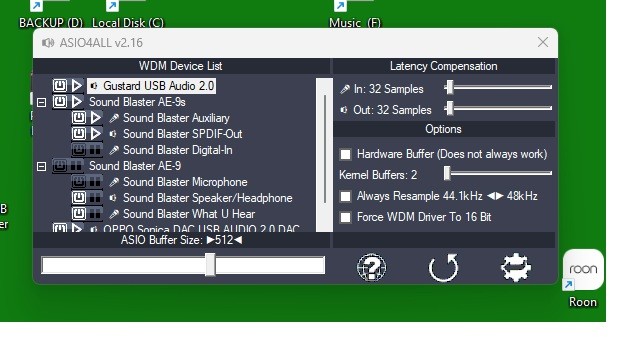

The ASIO4ALL interface shows the AE-9 as connected and running

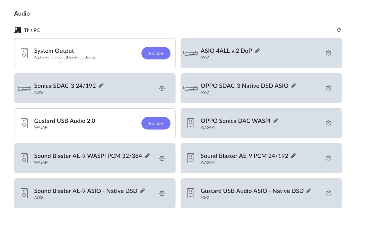

Under ROON Audio, the AE-9 is displayed as enabled for WASPI PCM and for ASIO DSD Native. Plays the WASPI option however converts DSD files to PCM
I hope the attached photos help.

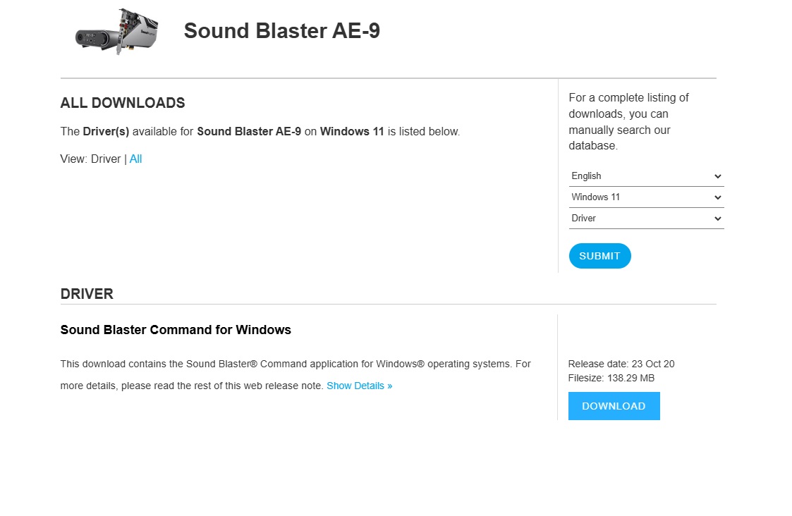

Thanks for the additional information and screenshots. It could be the case here that ASIO4ALL is a generic driver that may not fully support all hardware features, including native DSD playback. Creative provides official ASIO drivers for the AE-9, which are more likely to support native DSD. Have you attempted to download this version of the ASIO driver?

Thank you so much for your support. I could not find the the Creative ASIO driver download. Perhaps the ASIO driver is embedded within general Windows Driver Download?
(please see photo)

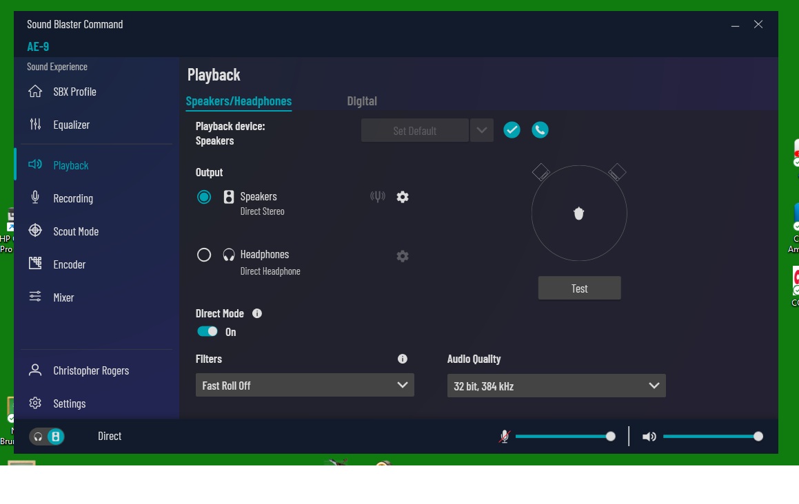

I do not know if this screenshot of the AE-9 Playback Settings will help.

And, yes the AE-9 ASIO driver is embedded within the SB AE-9 master download. At least I found out that much. (This issue was raised in a earlier post.)
