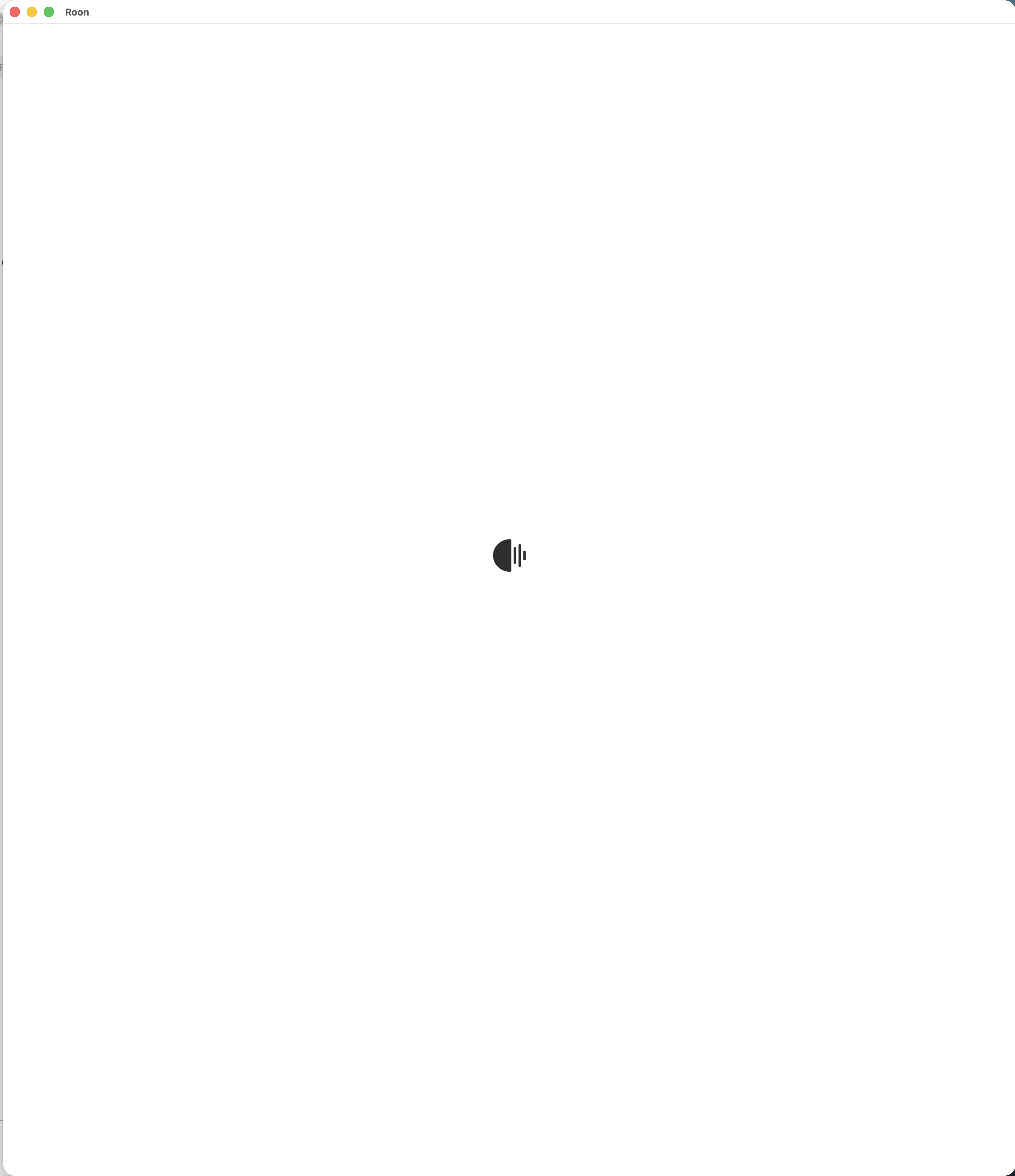

I performed the NUC and RedWolf shutdown and restart before I submitted my support request and again after reading your response. Afterwards, I could get Roon to reload enough to give me the opportunity to choose between two devices (Redwolf and NUC).
I tried selecting the NUC and got the infamous white screen with the blinking Roon icon. I was able to shut it down and reboot it in order to try the RedWolf and managed to get the same “blinkin’” response. This was all done on the monitor associated with the RedWolf.
