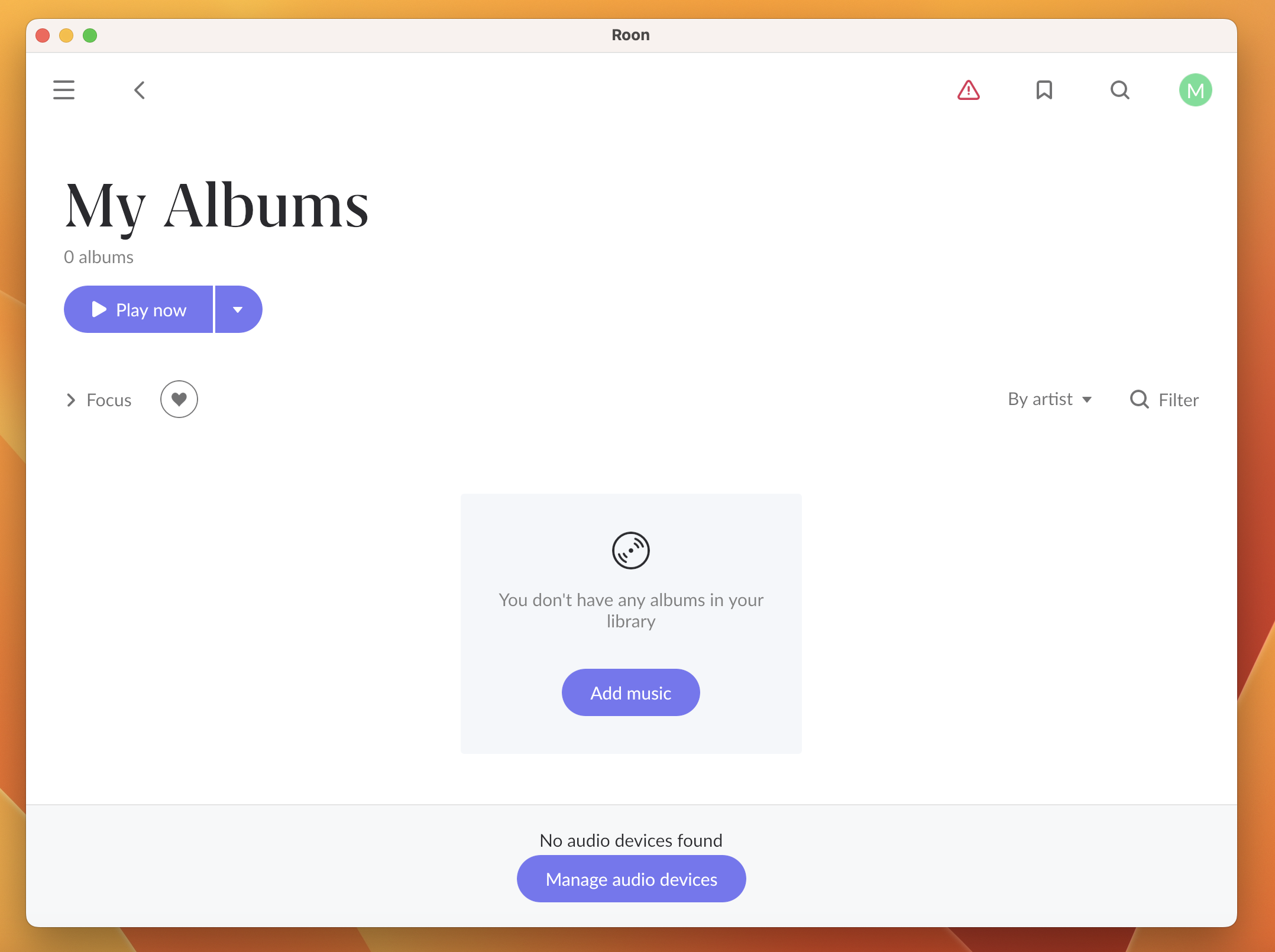

Roon has suddenly removed my entire library, and it won't load any music located in my iMac's hard drive. It also won't detect my DAC/AMP.

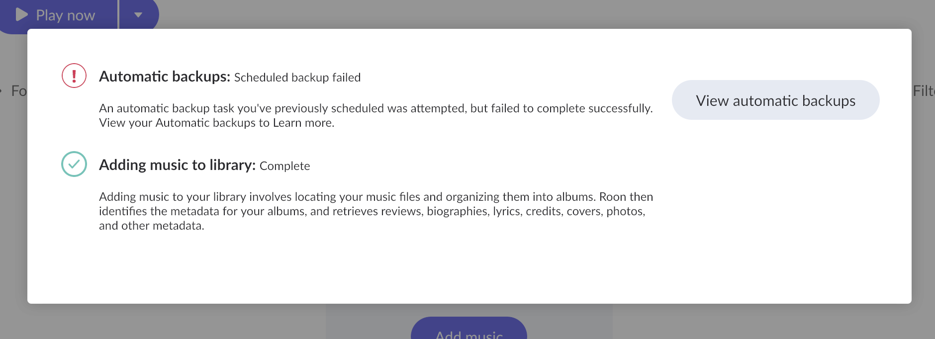

And what shows if you click the red triangle with an exclamation mark in it?
I get this message.
So nothing that seems to be related to your current issue. I’m sure official support will soon reply here too and hopefully have some further ideas for you.

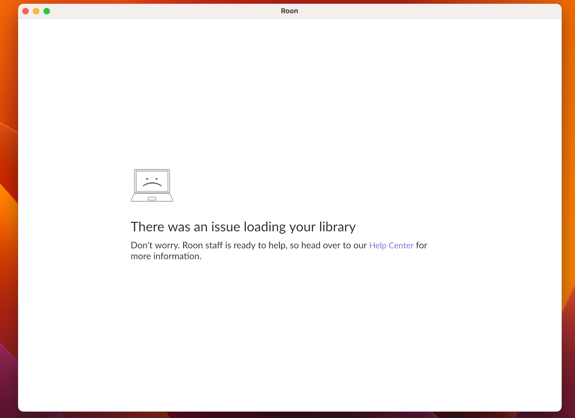

Hi there,
How do I stop my Roon Server? I just have this as the screen:

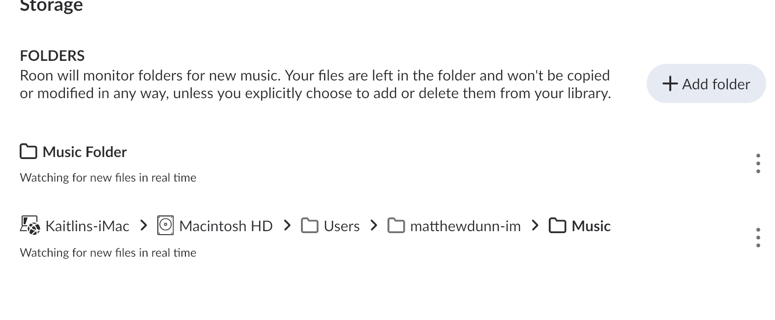

Hi, thank you for the tip. I went ahead and quit then rebooted my computer with the same issue. Here’s a screenshot of the Storage section of Roon Settings.
Hi @aeromaniac,
Thanks for the screenshot! Can you confirm the ‘Music’ folder still holds your local library?
We’re also seeing multiple instances of Roon Server tied to different Mac’s - can you confirm you’re on the proper machine that contains your library?

What’s peculiar about this situation is that Roon won’t see any devices connected to my computer. I can’t find my iFi iDSD Signature or even my iMac’s Core Audio in devices.
Even weirder is that when I click on Qobuz or Tidal, the websites populate. However, when I click Library, none of my Qobuz or Tidal library saves show up.

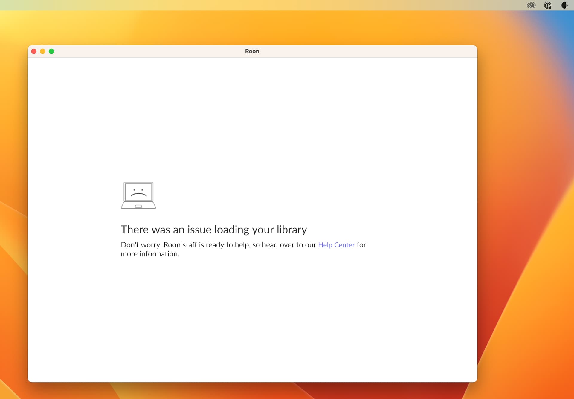

Hello, it didn’t result in anything new. I went ahead and moved my cache folder contents to a different location. You can see that the Roon Server icon is on.
Thanks for giving that a try @aeromaniac!
From a diagnostic report, we saw an error pointing to corrupted or invalid image metadata in Roon’s internal library database—specifically, an issue when deserializing (decoding) image data for a performer, album, or track.
