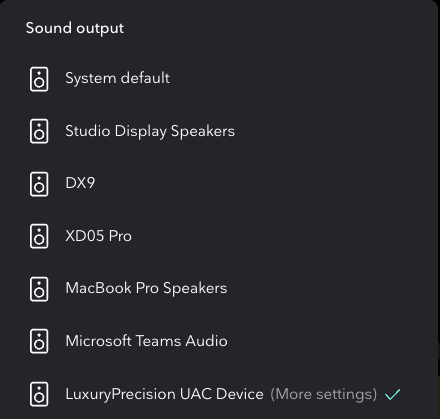

I have uploaded Roon’s Audio page to indicate that none of my devices are shown as available. I am also attaching a screenshot from Tidal clearly indicating all my devices. If Tidal can recognise my devices on the network , why can’t Roon? I have tried toggling the settings in Privacy>Local Network without success. Rebooting my Mac works… for a while before Roon reverts to showing no devices as available.

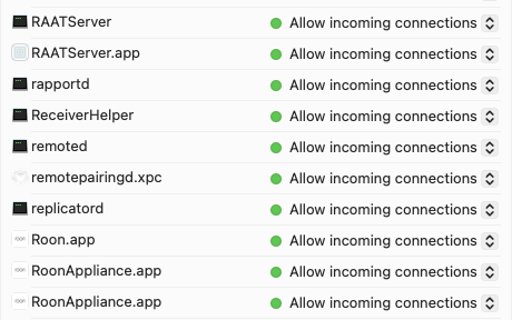

Well, as expected, that workaround only worked for 24 hours , I am now back to the same situation. I think I have already followed the instructions to create exceptions
for Roon & RAATServer. Screenshot attached.
Screenshot 2025-05-29 at 4.27.04 PM
So to reiterate, these exceptions were already in place. No devices are showing up after I switched the Firewall Off & toggled it back on. Only option left is to reboot my computer (I have 8 different applications open so this is a giant pain) but that solution is really only good for 24 hours or so.
