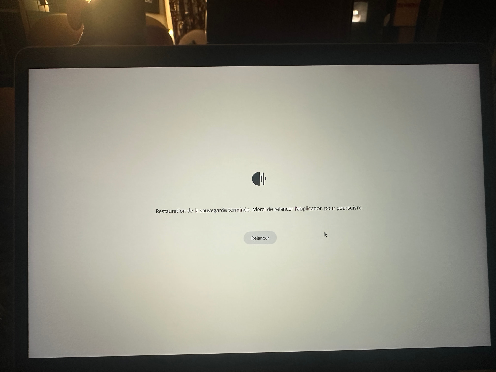

I have the latest version of roon server and roon : version 2.71, build 1683. I have a Synology NAS and roon on my iphone.

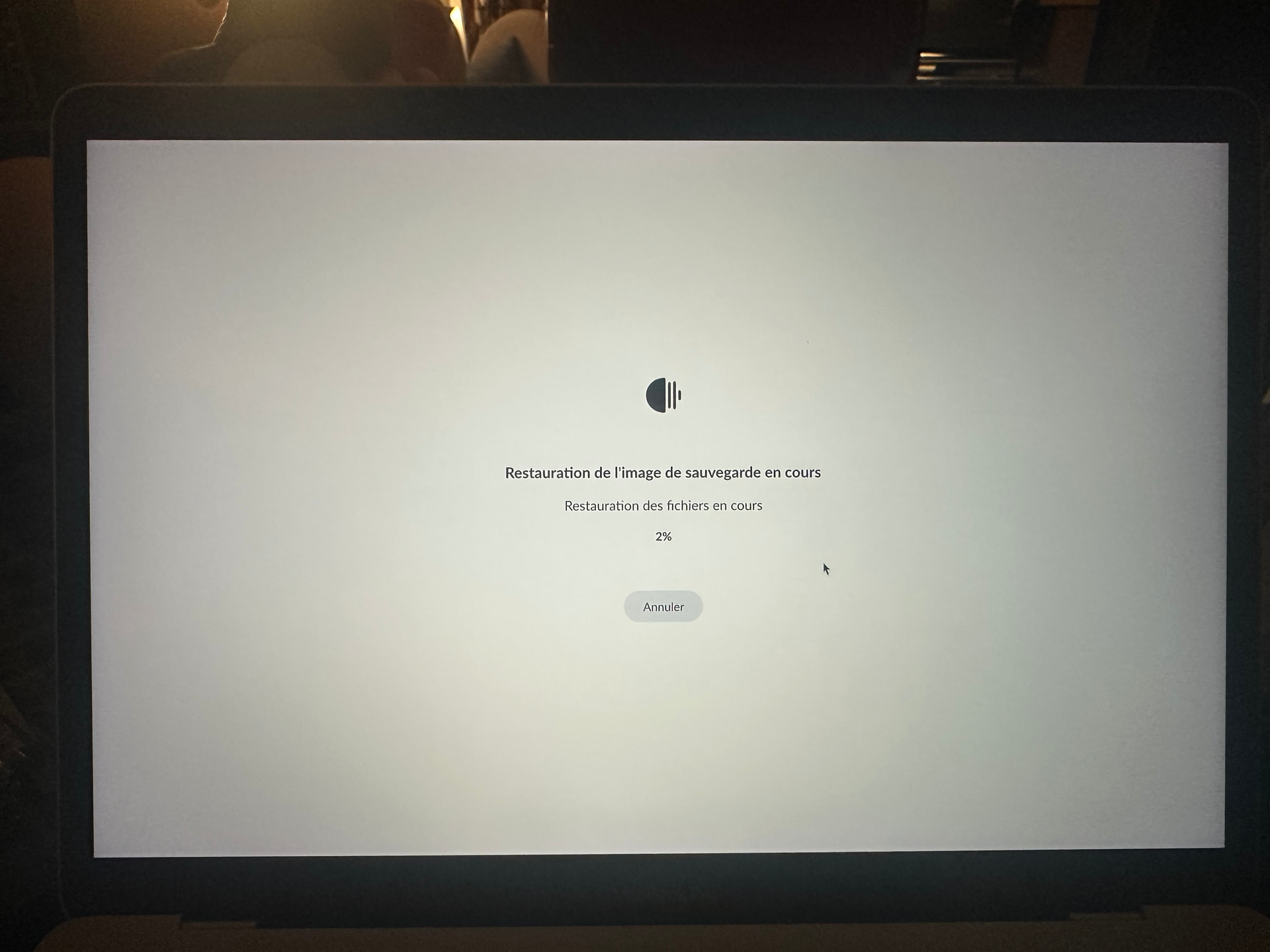

I bought a Gustard S26 yesterday : i move all my flacs (1500 albums) on the Gustard SSD, after i launch a back-up of the database on my old roon server (on the synology) and restore it on my new roon server on the Gustard : all was ok.

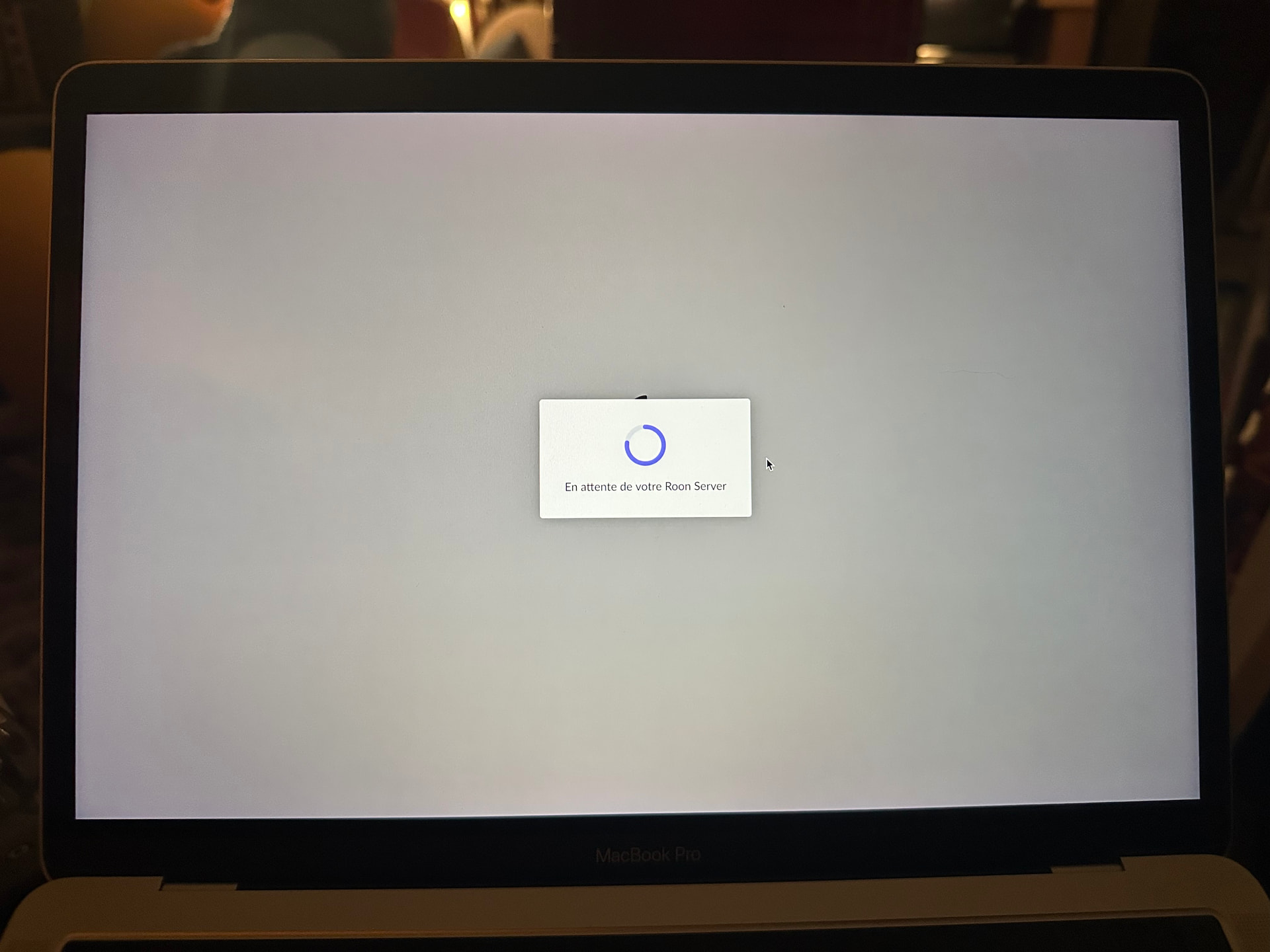

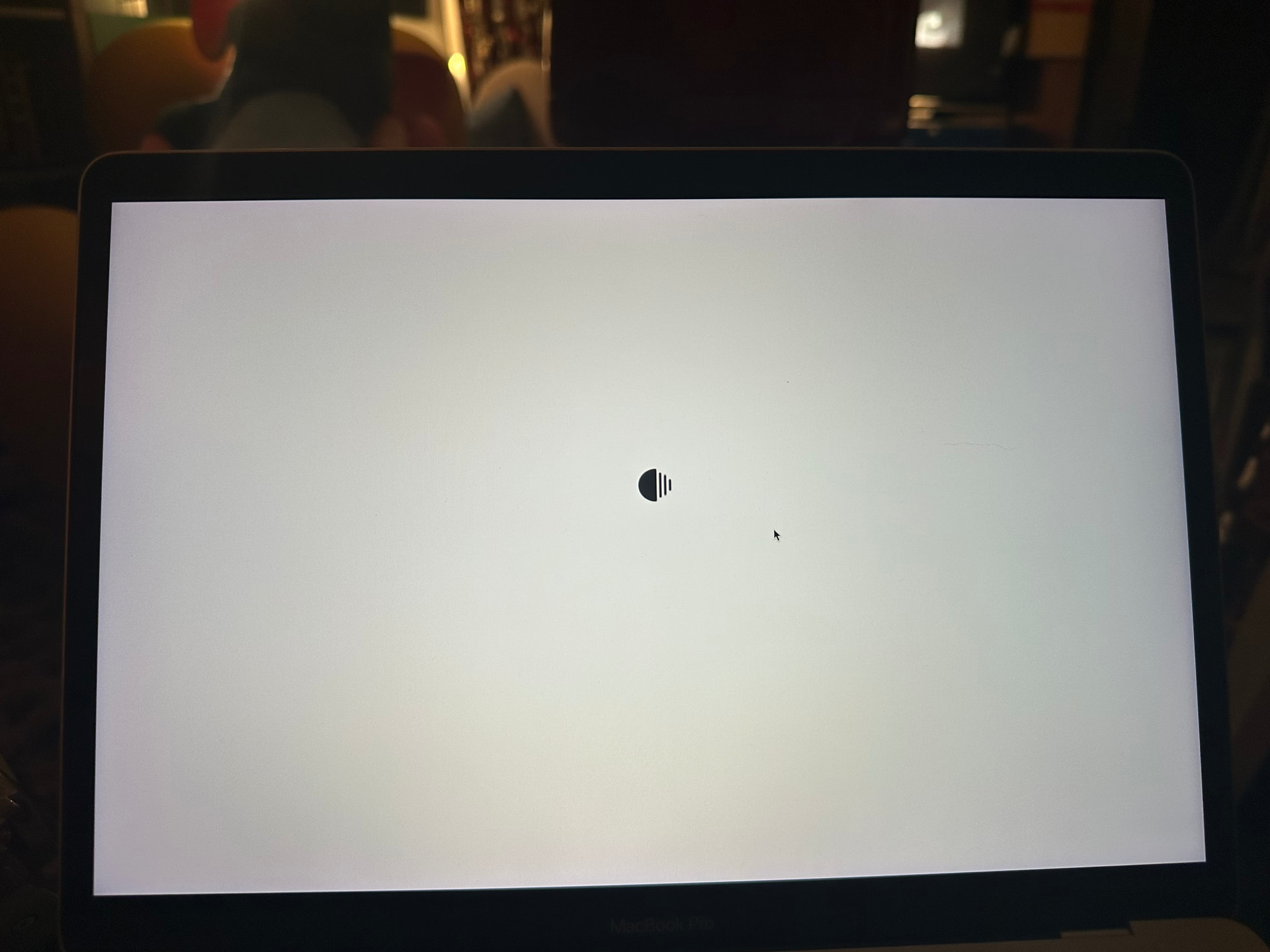

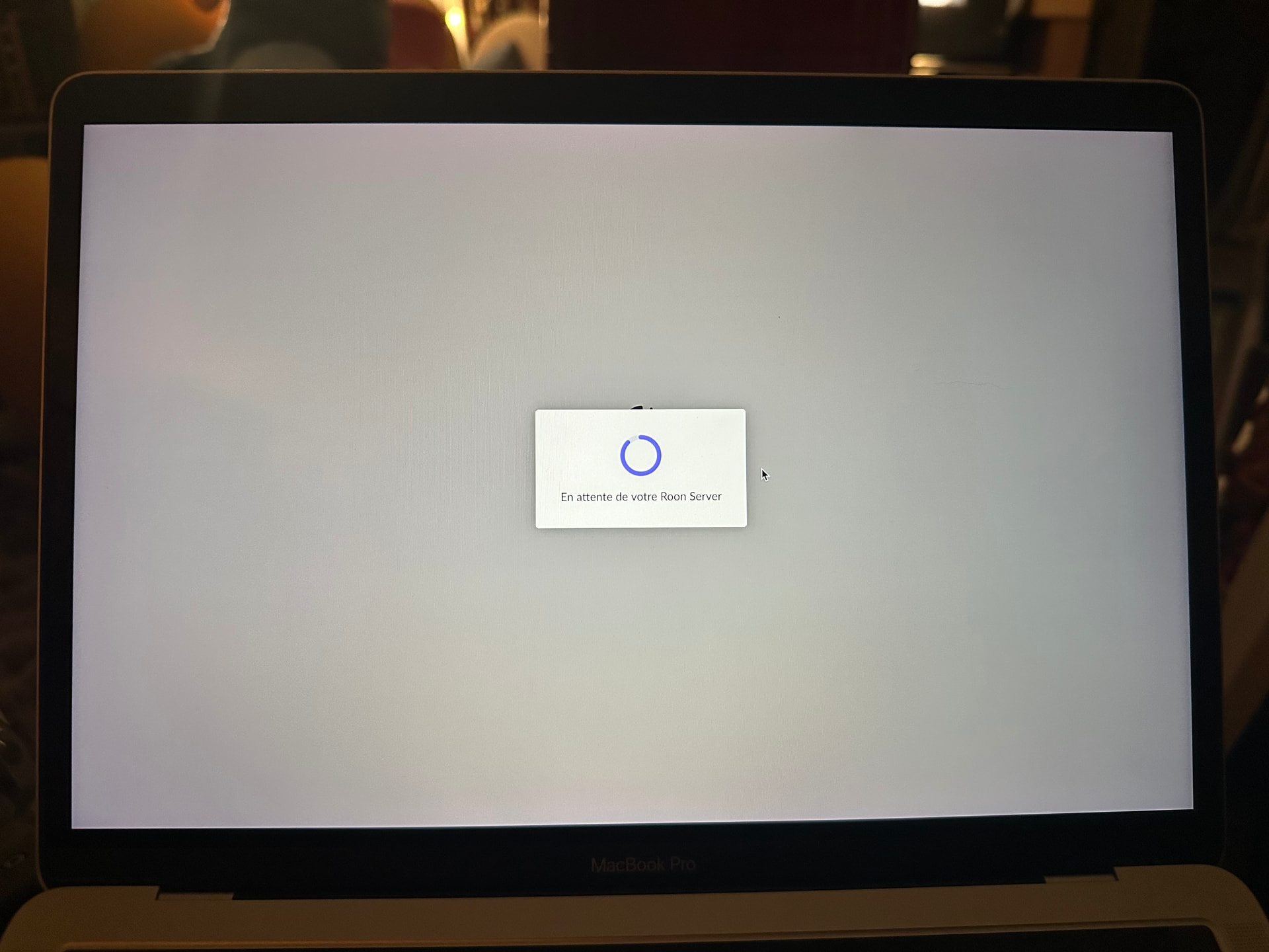

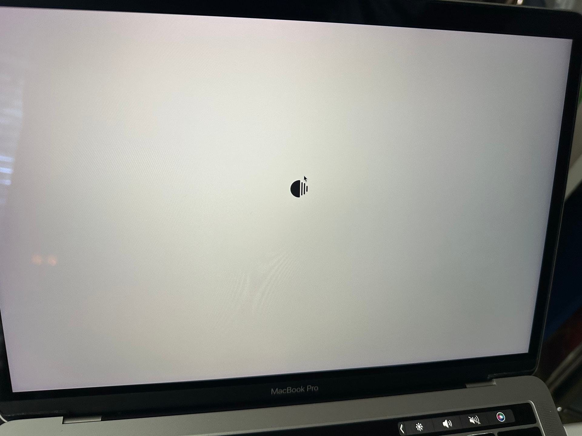

After the restore was finished, i ran roon and since 4 hours, roon show me only this : sometimes roon lost the connection on the roon server during 2 seconds and after it’s ok but roon loops on this : see screen shots

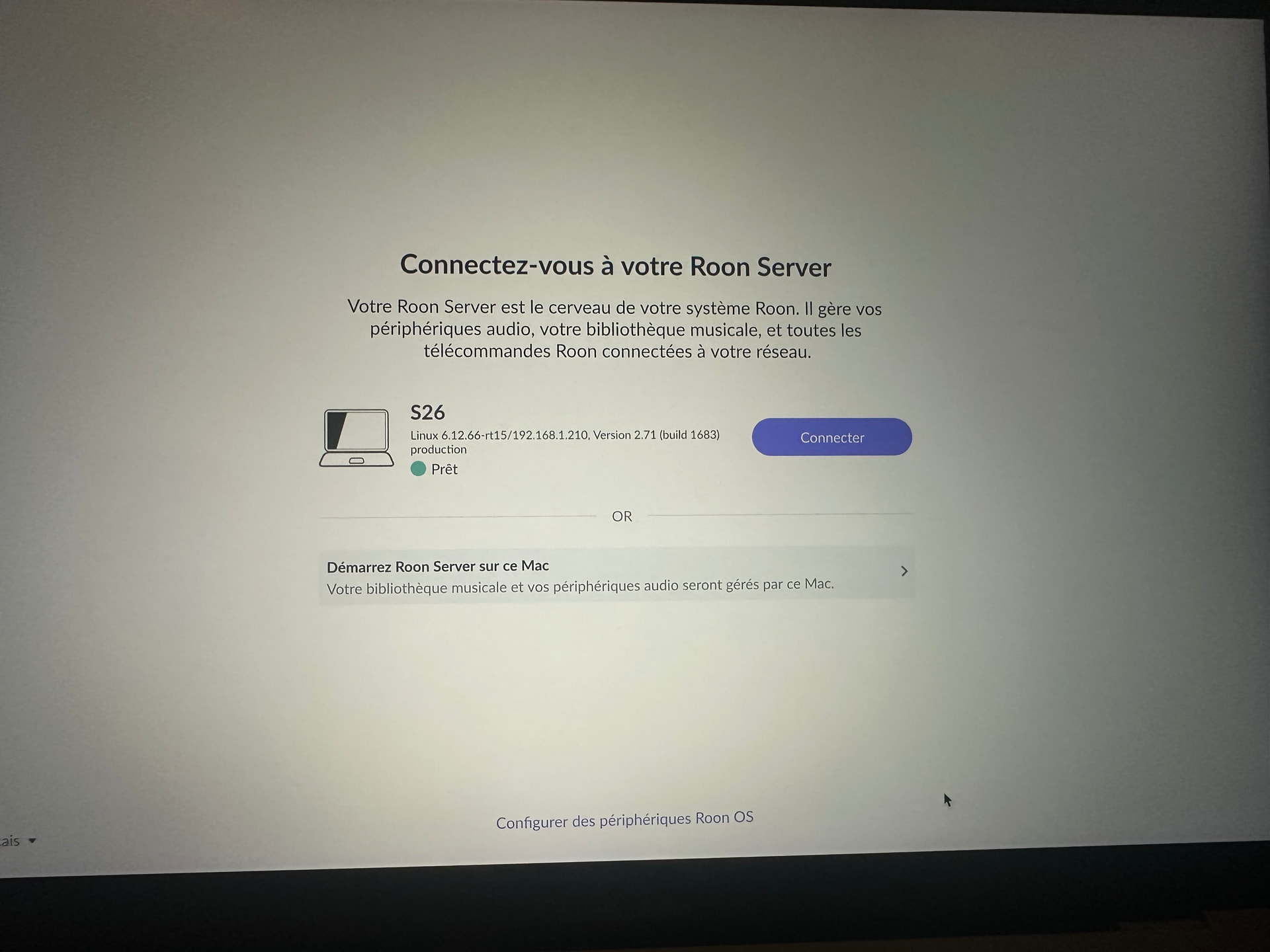

From a fresh Roon Server diagnostic report from the S26, it looks like the backup was never actually restored onto the Gustard. The Gustard’s Roon Server started with a completely empty database on Wednesday at 13:42, and the 1,381 albums you see on it came from Roon scanning the music folders on the SSD directly, not from your backup. You can confirm this yourself: on the Gustard your playlists and tags are gone (0 playlists, 0 tags), while your Synology still has all 20 playlists and 13 tags, plus your play history and edits.

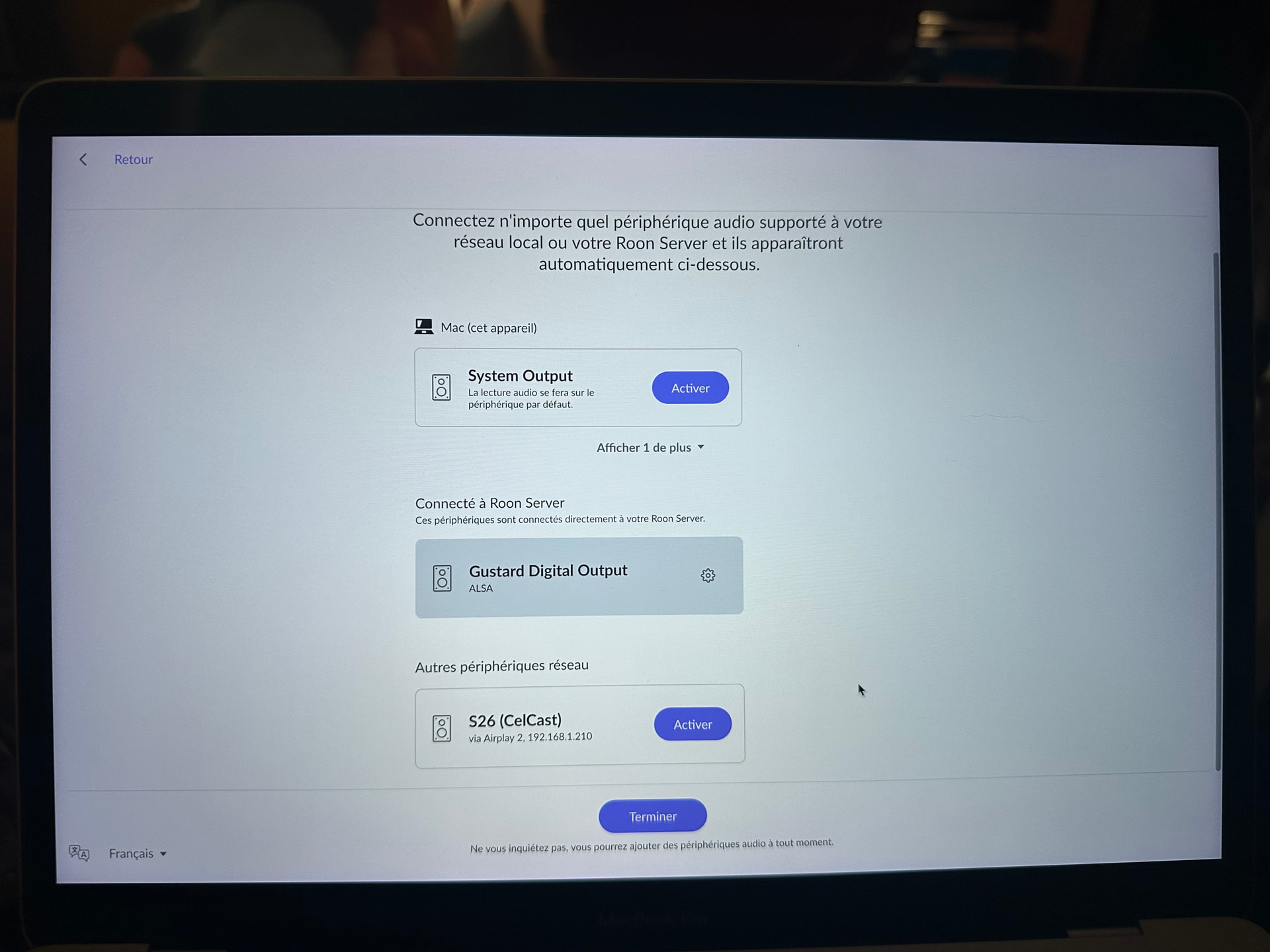

Second, you have two Roon Servers running at the same time, and your account allows only one. We see each one repeatedly signed in and deauthorized the other, eight times in total. Your Roon app on the Mac has been connecting to both of them, roughly every hour. One of them has your library, the other is empty and signed out, and the app keeps switching between them. That is what produces the endless white loading screen you photographed.
Right now, your Synology is the authorized server, it has your full library, and it is working, it was playing music to the Gustard yesterday evening. The Gustard’s Roon Server is signed out and its library is empty (it also looks like it took a firmware update on Sunday afternoon, which reset its database a second time).
Here’s how to sort this out. Please decide which machine you want as your Roon Server, then:
  1. Stop Roon Server on the machine you are not keeping. This matters, leaving it installed and running is what causes the tug-of-war. On the Synology: Package Center → RoonServer → Stop, and turn off “start on boot.”
  2. Restart your Roon app on the Mac and iPhone so they forget the other server. When Roon asks which server to use, pick the one you kept.
  3. If you’re keeping the Gustard, do the restore again and only after step 1. Go to Settings → Backups on the Gustard, choose “Restore from backup”, browse to the backup folder you copied onto the Gustard, and pick the most recent backup. Wait for it to finish completely before opening the app again. Your Synology backup is around 16 GB, so this will take a while, please let it run.
One more thing to check: your Gustard appears on the network at two addresses at once (192.168.1.209 and 192.168.1.210), which usually means both its network ports, or Ethernet and Wi-Fi, are connected. Please leave only one connected, this can cause connection problems on its own.

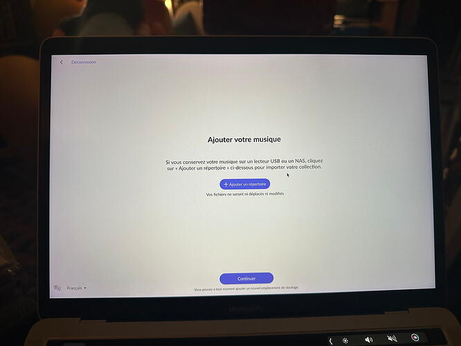

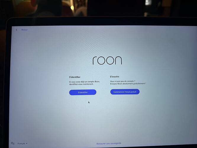

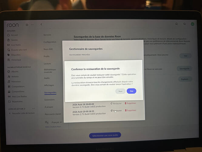

I stopped my roon server on the synology, i initialize the roon database on my Gustard, after i ran Roon, I identified myself, i select the Roon server in Gustard an choose restore database on the bottom of the page : strangly, the restore took one minute and after ran Roon it loops like last week.
Will
Roon loops on this :

Roon Server on the Gustard isn’t hanging, it’s crashing and restarting, over and over. In the ~23 minutes of logs you sent, the server started up 16 separate times, roughly once every 85 seconds. Each time it gets partway through loading your library, runs out of memory, and gets killed before it can finish. Then it starts again from scratch.
That’s the loop you’re seeing. From the app’s point of view the server keeps vanishing and coming back, which is why you get the white loading screen and the constant disconnect/reconnect. The library never finishes loading, so Roon never becomes ready.

  2. On the S26, reset the Roon database to a fresh, empty one, do not restore a backup yet.
  3. Don’t add any storage folders yet. Just let it start.
It should come up cleanly and your app should connect normally within a minute or two. That confirms the diagnosis and gives us a stable starting point. Once we’ve got your answers to the questions above, I’ll tell you exactly which backup to restore and in what order to add your music folders, so we don’t trip the same problem again.
