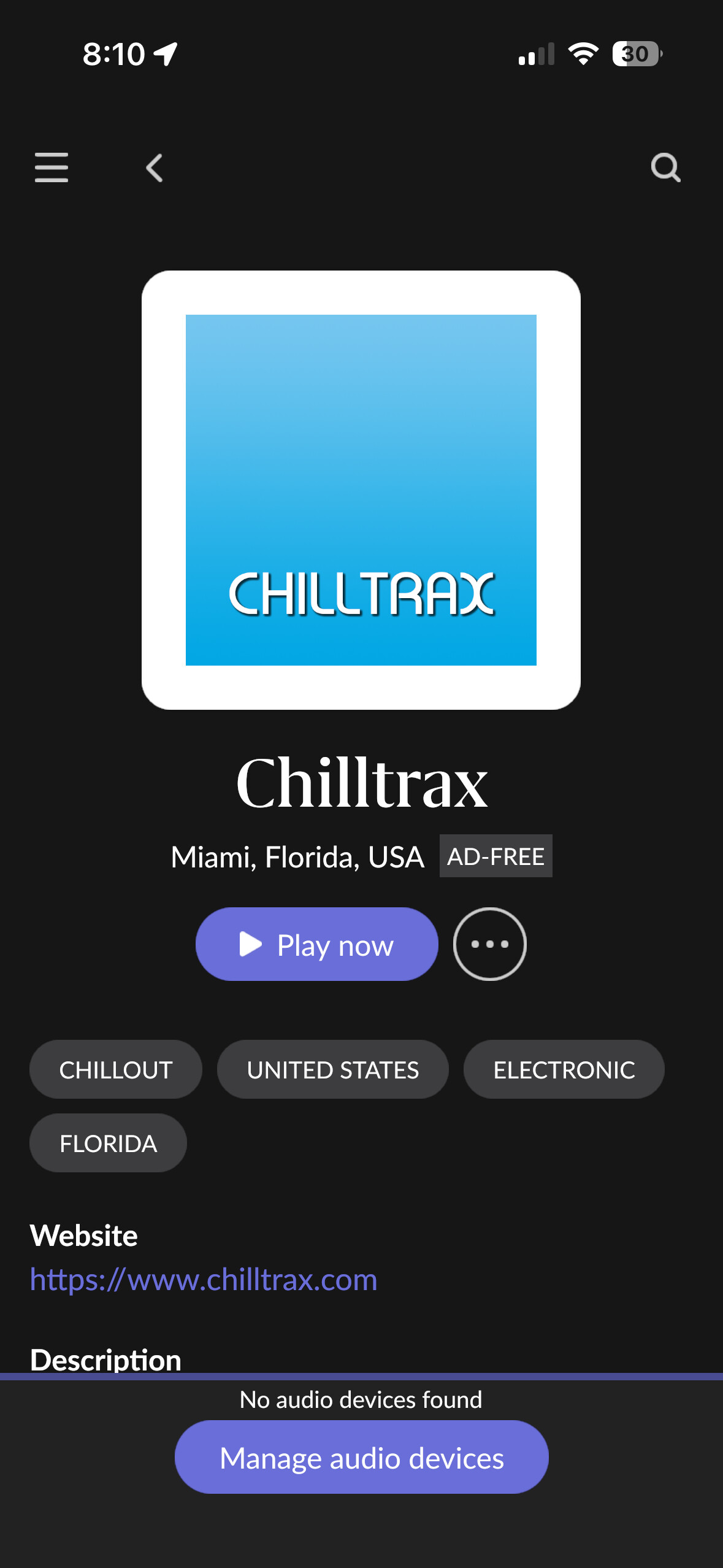

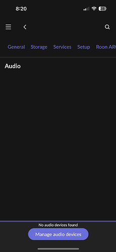

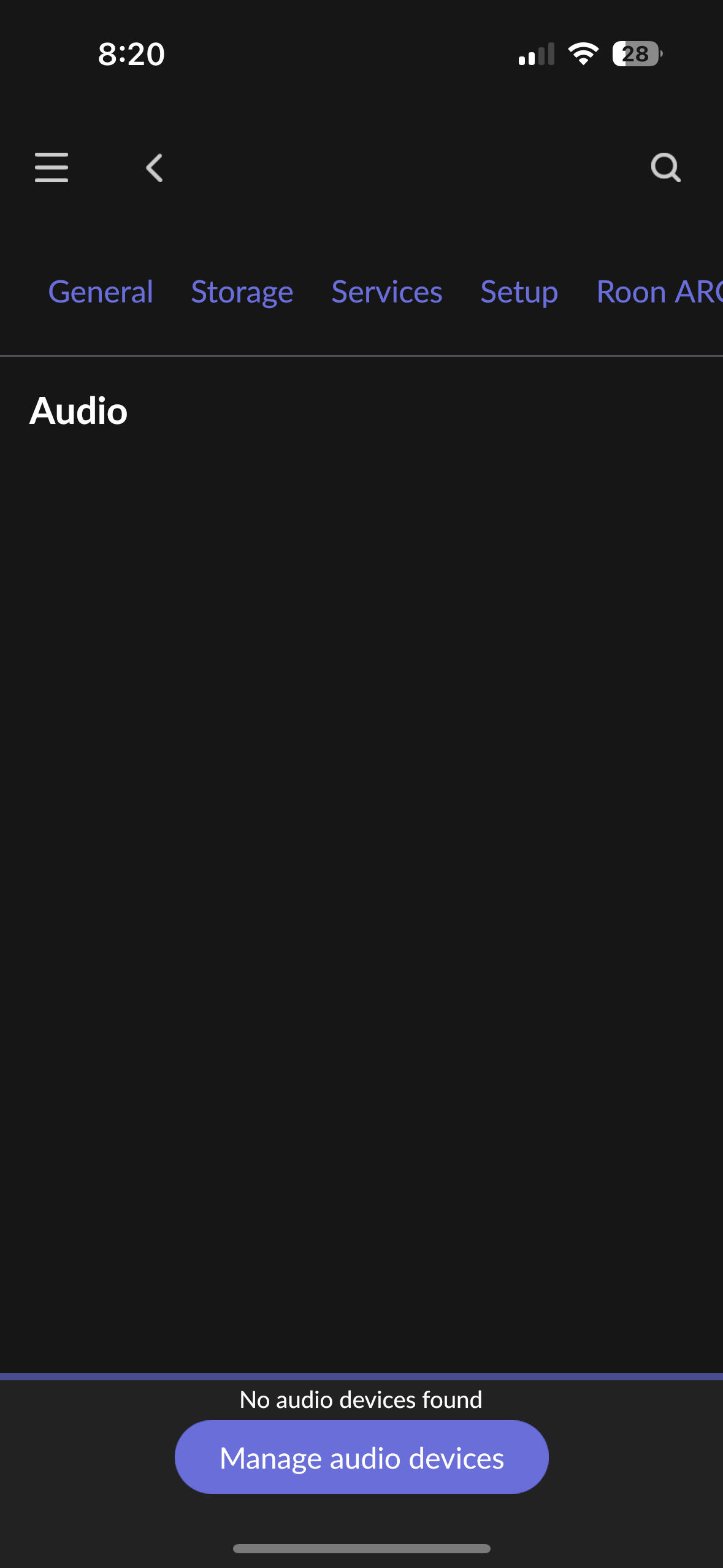

More info. iOS client loses connection to server repeatedly. No changes to my network setup which has been the same for 5 years. Running latest build of both iOS client and Roon server. This is a regression.
After restarting iOS client, it finds the server but now all audio zones have disappeared.

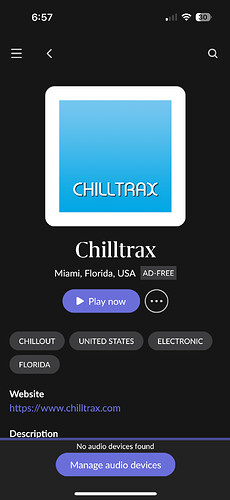

Zone discovery has not stabilized. Right at this moment my iOS client is seeing no zones. Mac Mini is hardwired to the amplifi router. iPhone is usually on one of the mesh points. Zones directly hardwired to the router are not seen. Zones on same mesh point as iphone are not seen. No recent firmware updates to the Amplifi router. Band steering to 5 Ghz band is on. Router steering is off. None of these settings have changed in years. No other routers. This zone flakiness is new within the past few Roon server updates and/or Sequoia updates. I had been running Roon on Sequoia prior to that with no zone discovery issues.

Just happened. 2021-11-21 20:10 EST. This is NOT track dependent. iPhone is on an amplifi mesh point, wifi 5 Ghz. Mac mini Roon server is wired to the amplifi router.
This happened after I was out all day and then came home. iPhone automatically joined the wifi network.

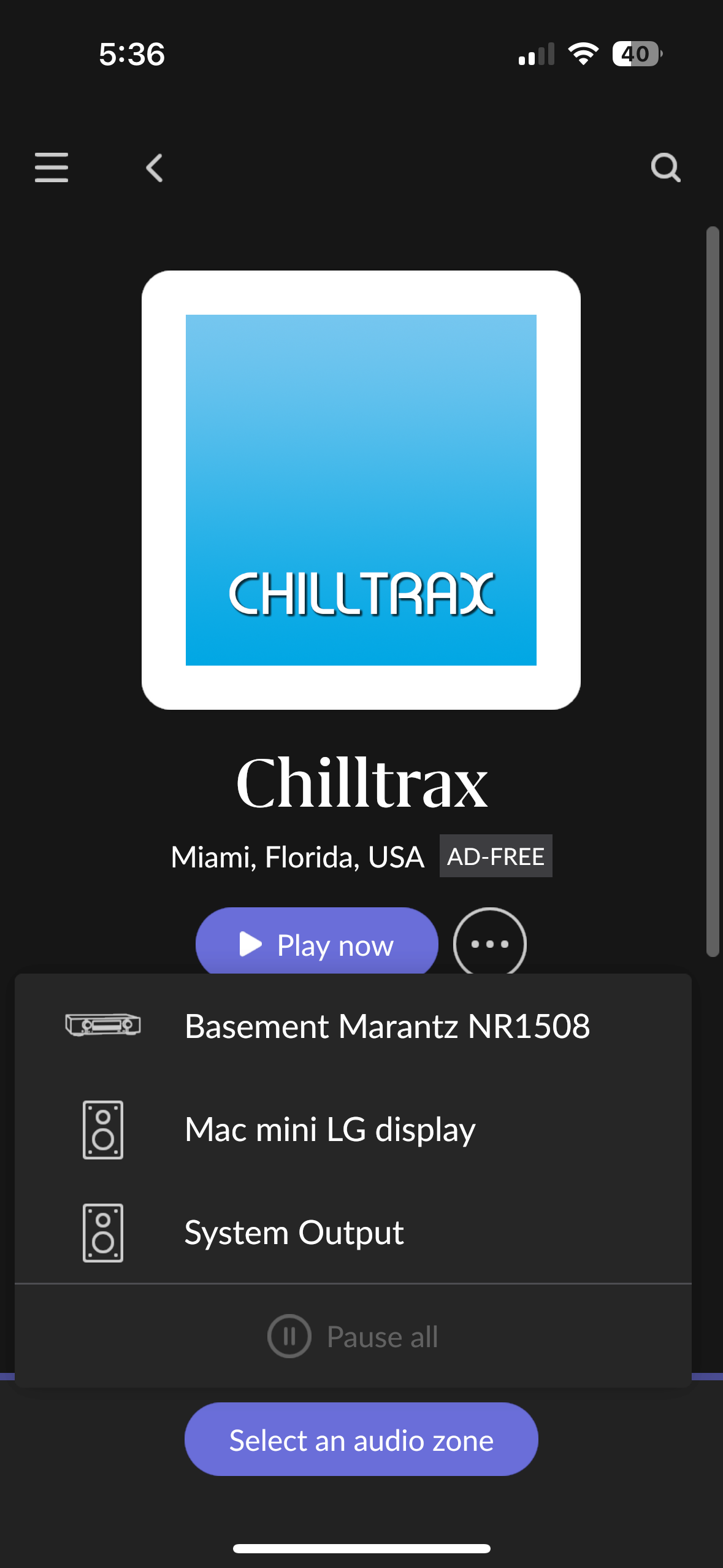

Hi. I think this may all be user error. I realized the mac mini was NOT set to wake on network activity. So, I think the times I was seeing no endpoints was because the mini was asleep. I changed the setting to wake on network access and now I see the endpoints from the iOS client. Will monitor and let you know. Sorry for taking up your time.
