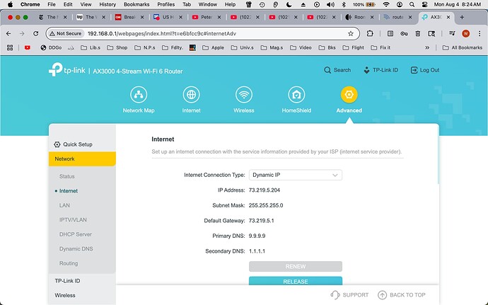

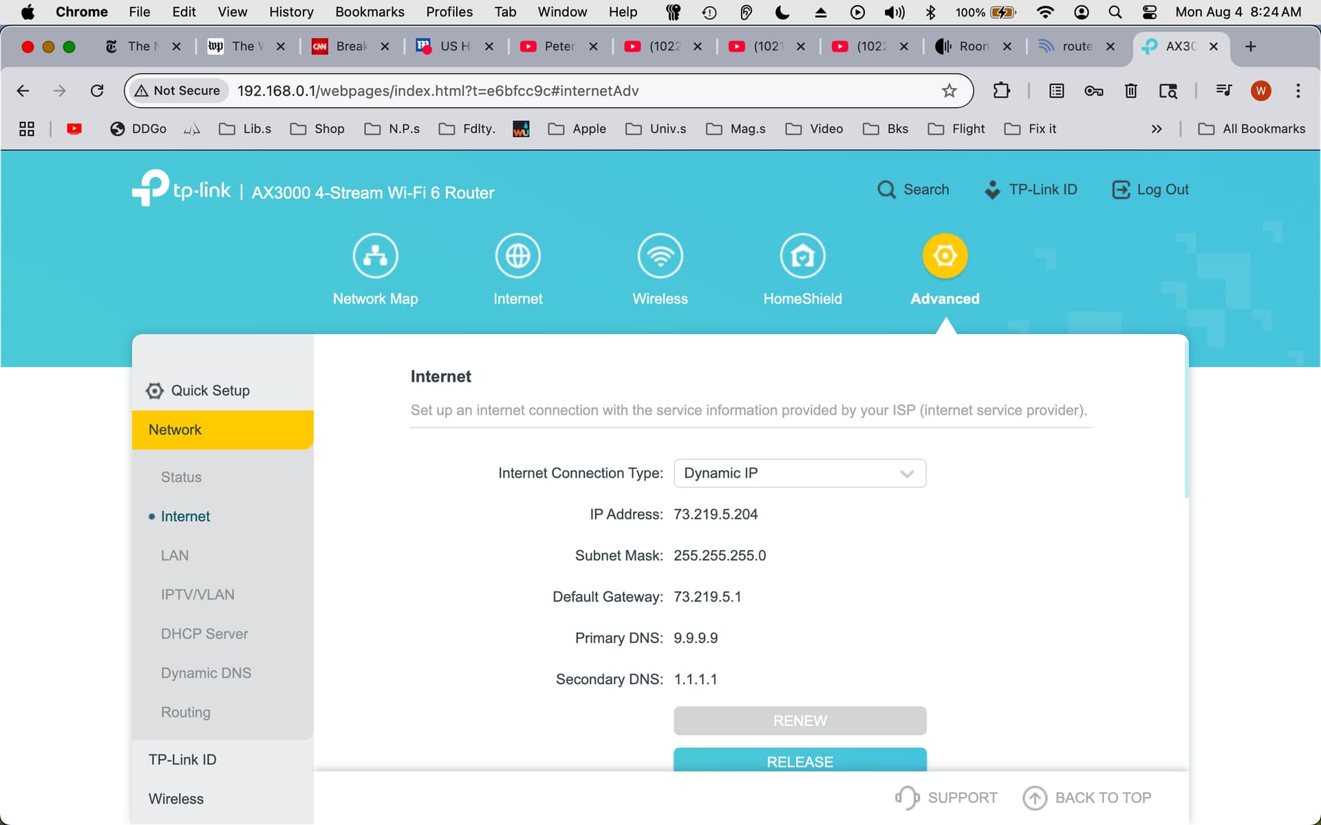

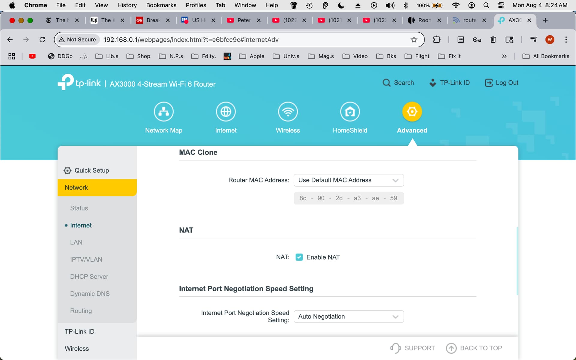

Thank you for the response. I’ve changed the DNS on the admin. page. My administration page is a bit different than your example. Does this look right?
(see screenshot)
I’ve made the other changes you suggested and ran Roon Live Radio and NAS files for approx. 20 hours without “Roon Quitting Unexpectedly.” However, I still can’t get my remotes to update to the latest Roon software automatically or manually. What can be causing this? Thanks for your time. Bill

Hey @William_Tabaka,
Thanks for the updates and screenshots! I’m glad to hear there’s been progress as well - smooth listening is so crucial!
