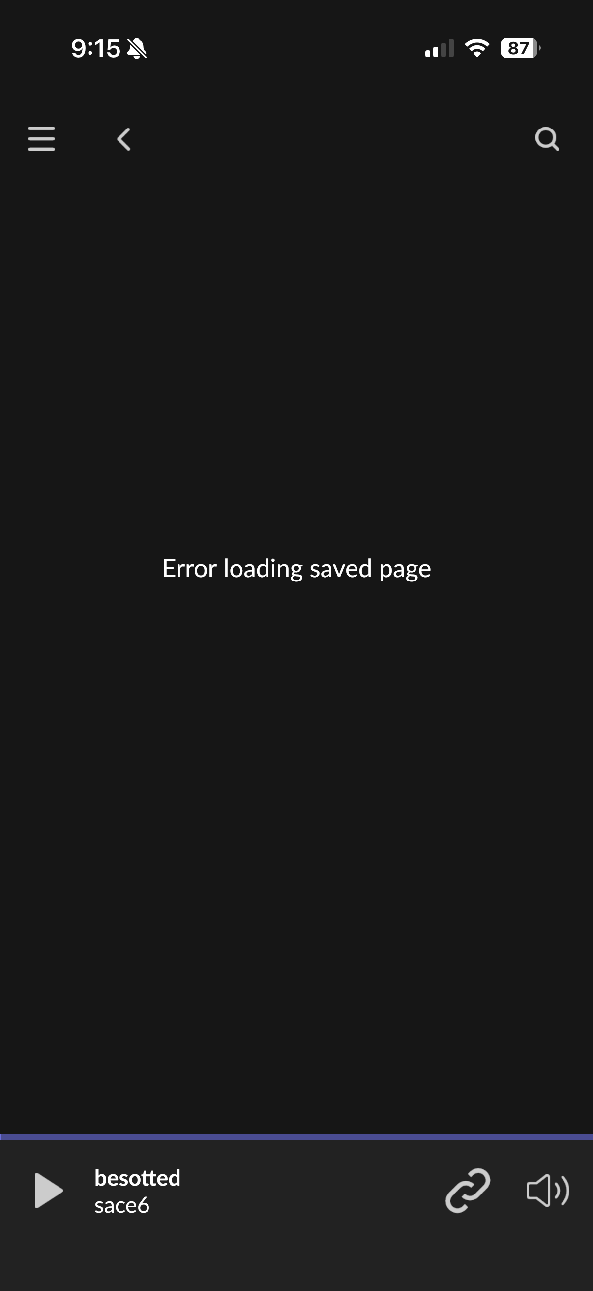

Quite frequently Roon will not respond to the play command. I'll press play and just wait and nothing happens. If I navigate in Roon, it will often say 'Error loading saved page'. I close and reopen the app multiple times and try again - sometimes it will eventually play. Sometimes I have to reboot ROCK via the web UI. In most cases this will get playbook working speedy again, but on some occasions, I have to power down and power on the ROCK from the physical power button. That is always the most reliable way to get Roon responding to play commands at an acceptable speed, however all these fixes are just temporary. The issue always returns within a day or two. At times when I can't take it anymore, I just use the Tidal app, which NEVER has any delay whatsoever when either using Tidal Connect or AirPlay to my speakers. It would be great if support team could review the logs to see what could possibly be causing this frustrating issue. Also I only use Roon to play music from Tidal, and the ROCK is connected to switch via Ethernet.
I have 1Gb / 90Mb Internet connection. I'm using Amazon Eero 7 - 3 in total throughout the house. I have 3 network switches with 2.5Gb uplinks to the Eero's.
