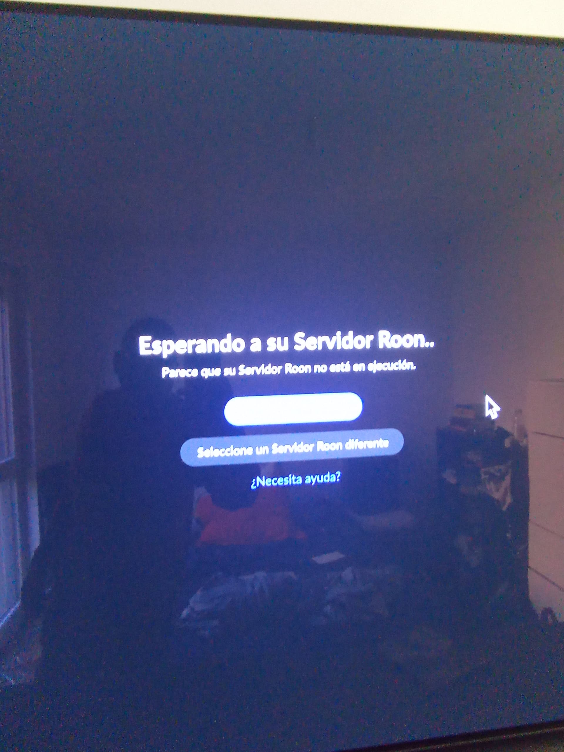

Now its appears a message that days that my Roon server its not working.

If you look at the top bar on your Mac do you see the Roon symbol like in the below example?
If you don’t it means that the Roon server itself is not running even though the client is. If you do see it click on it and see what the status of Roon server is.
Hello Daniel, i see what you said to me…
Roon server status: Running

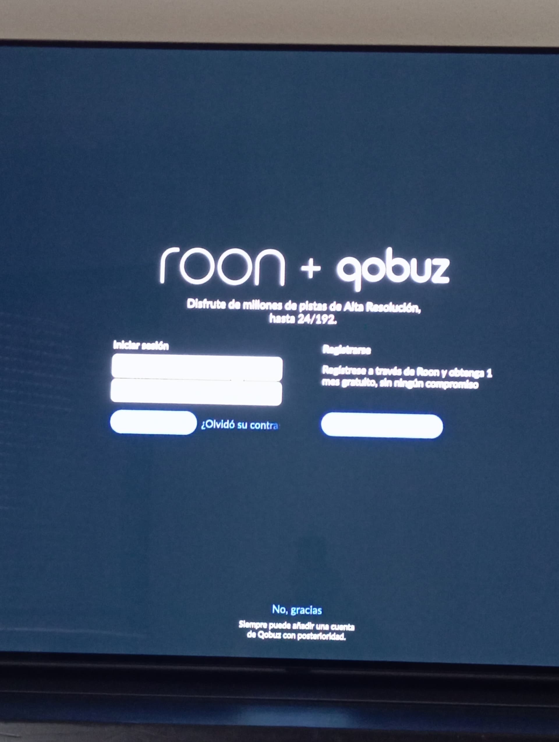

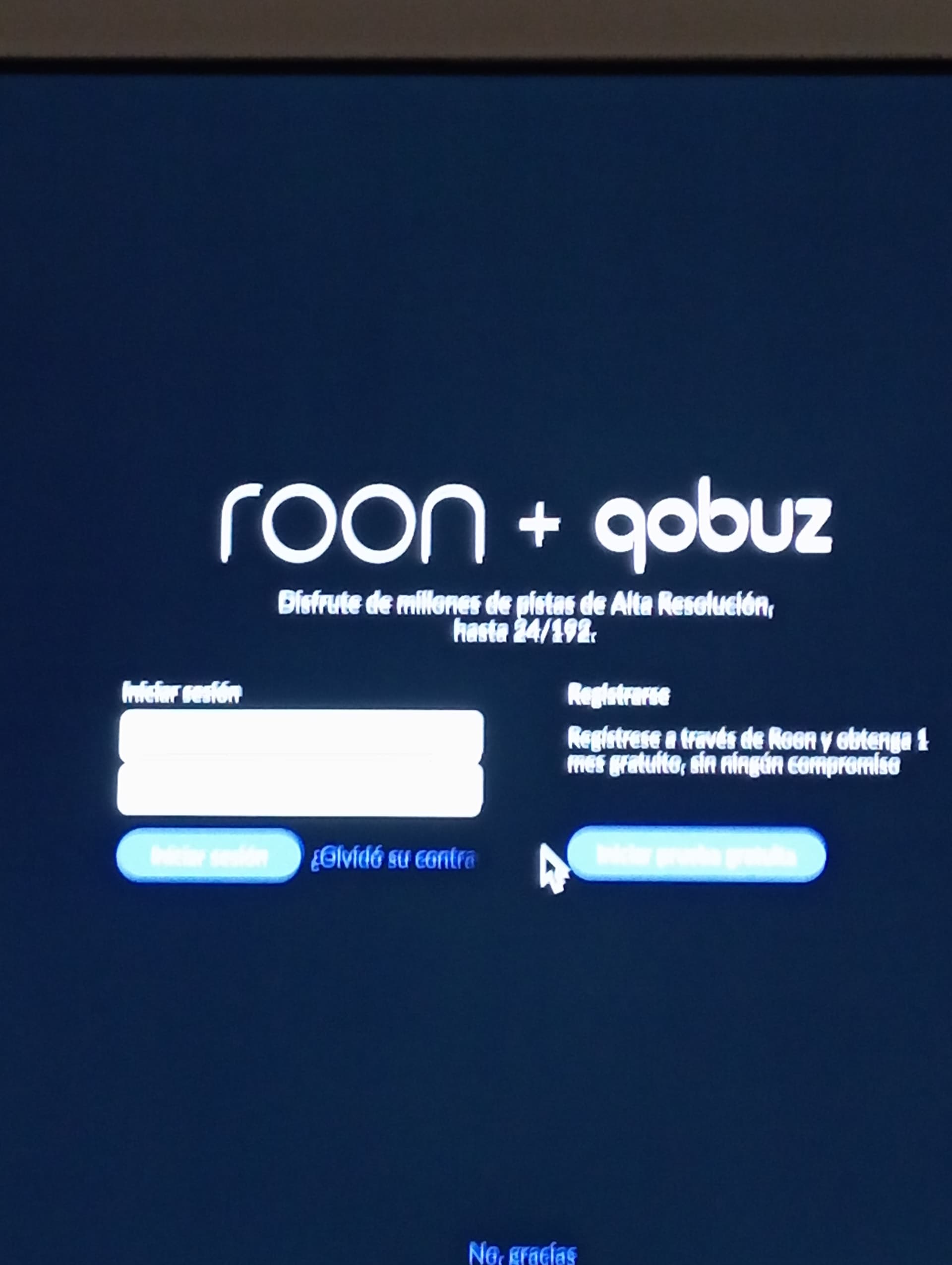

I open the program and i have to put the password of Qobuz.
I write It and its ok. The the app seems that going to run but suddenly its closed… If we dont find a solution soon im going to Close my acount with Roon…

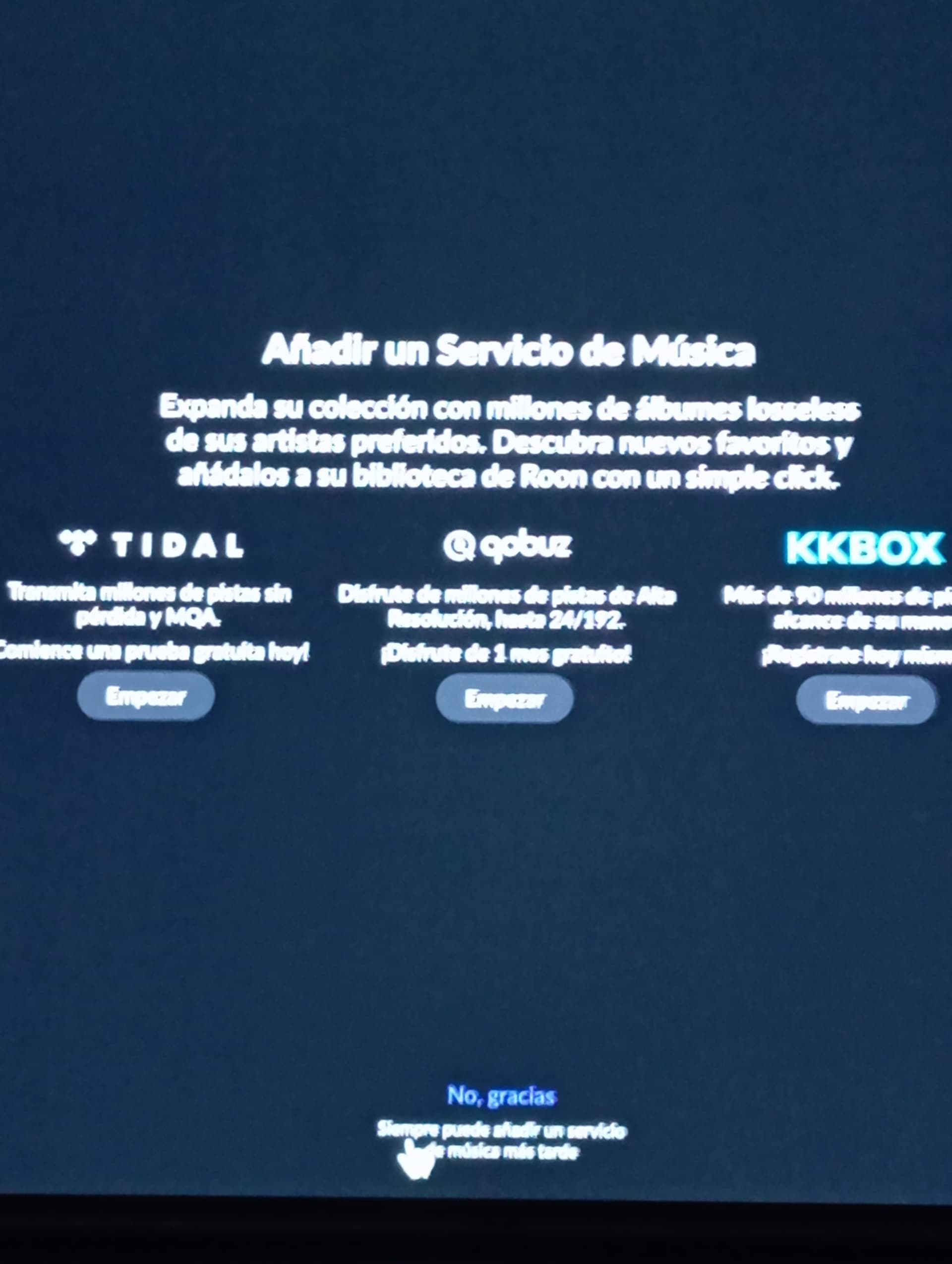

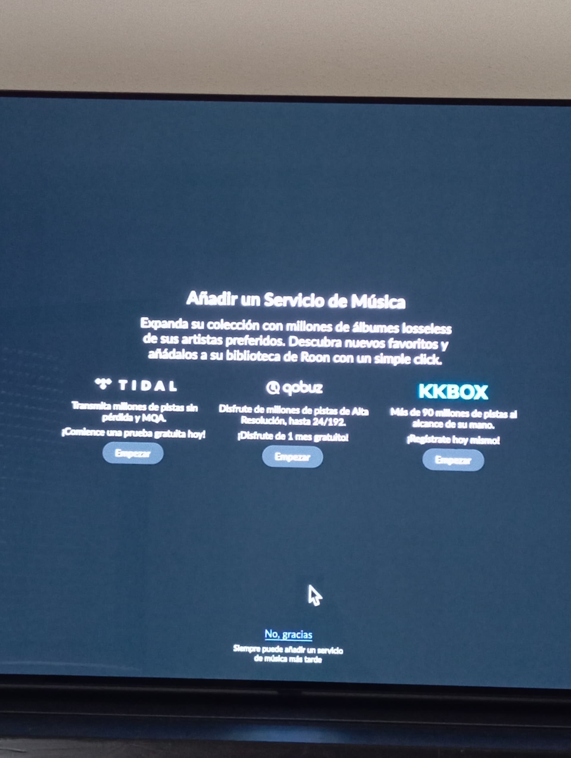

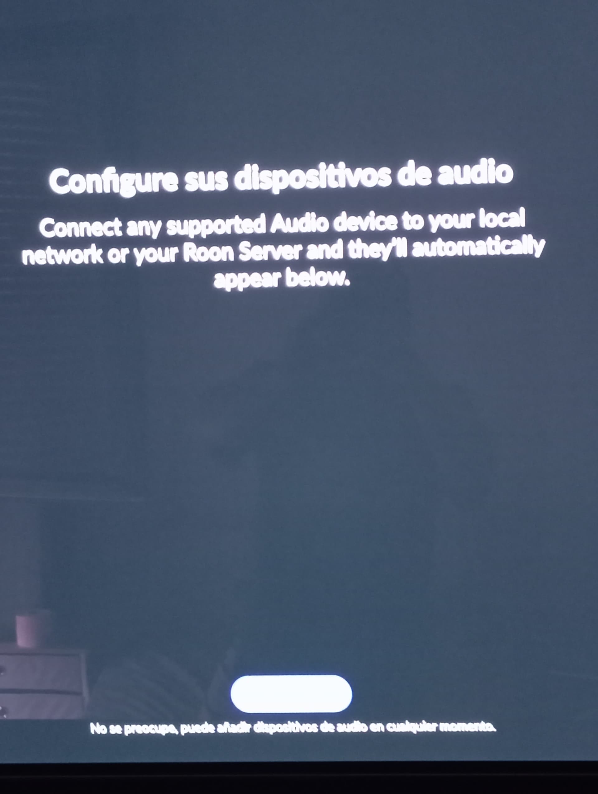

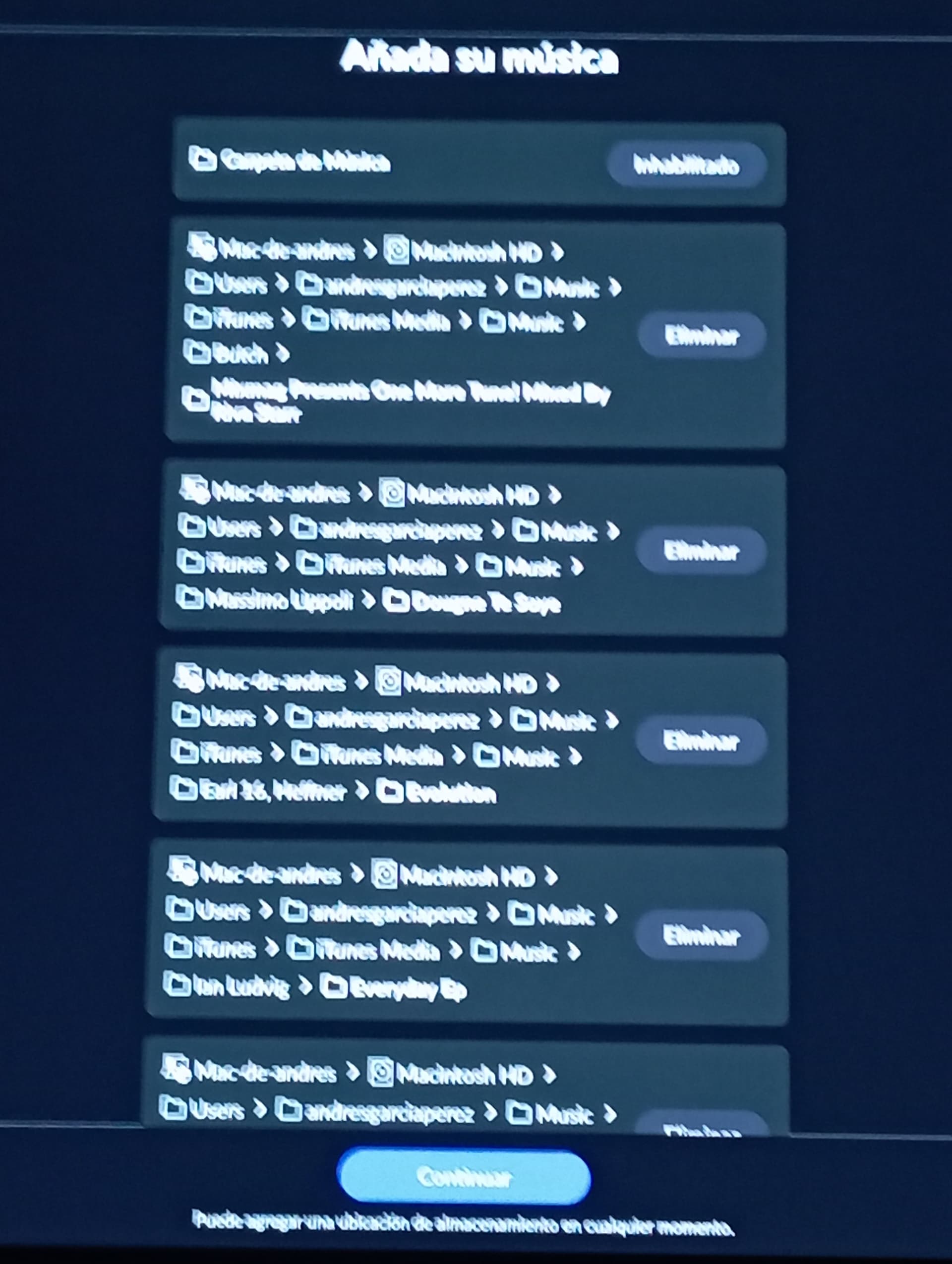

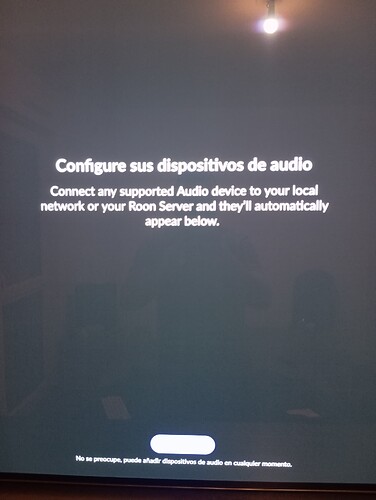

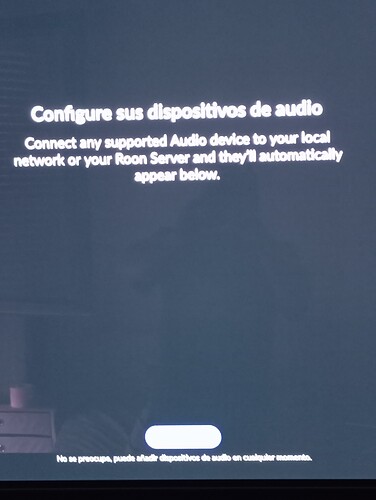

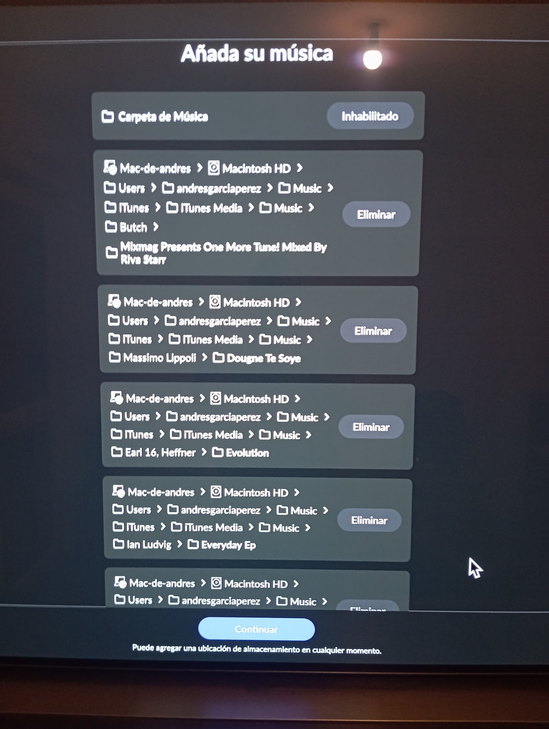

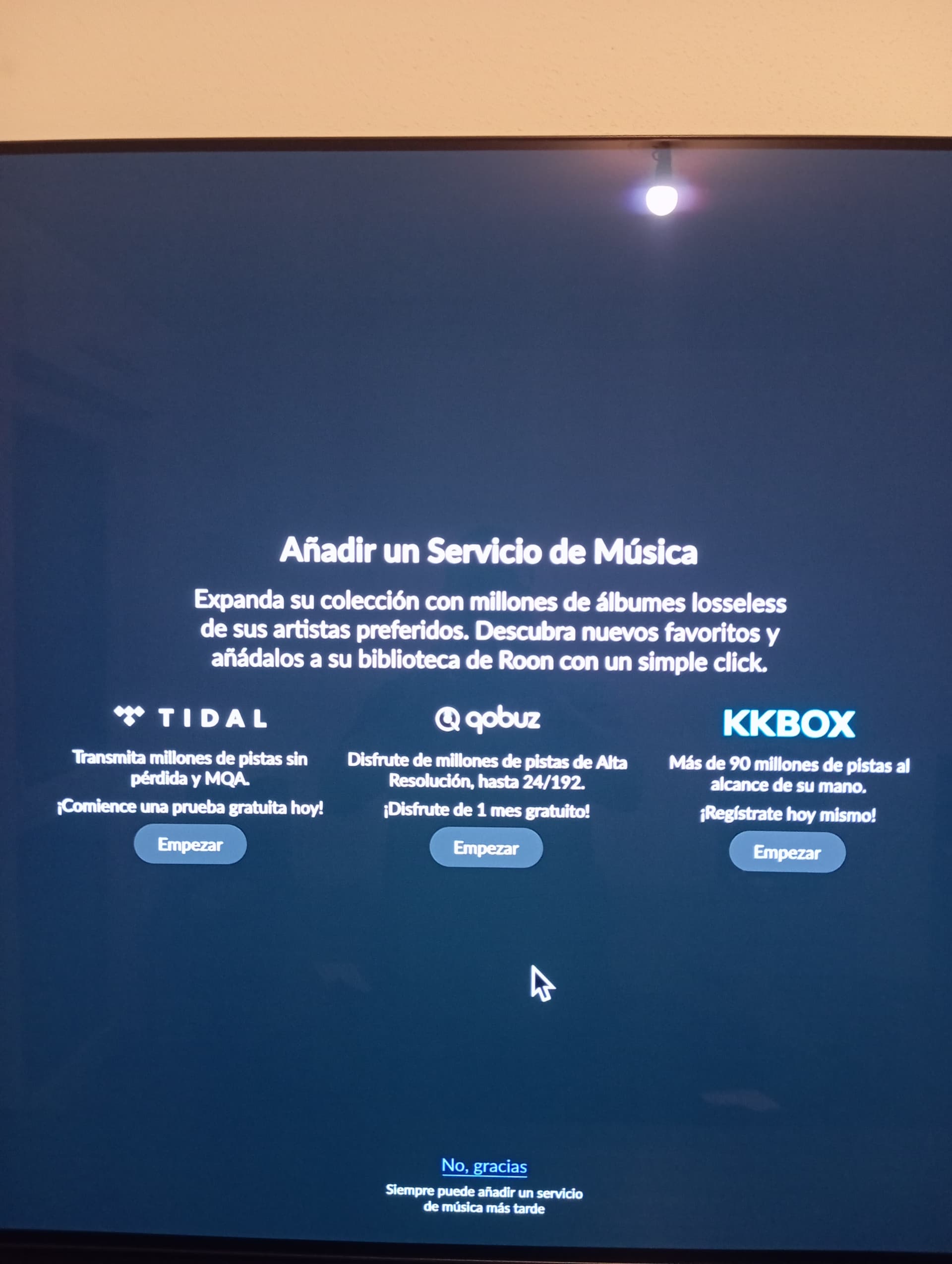

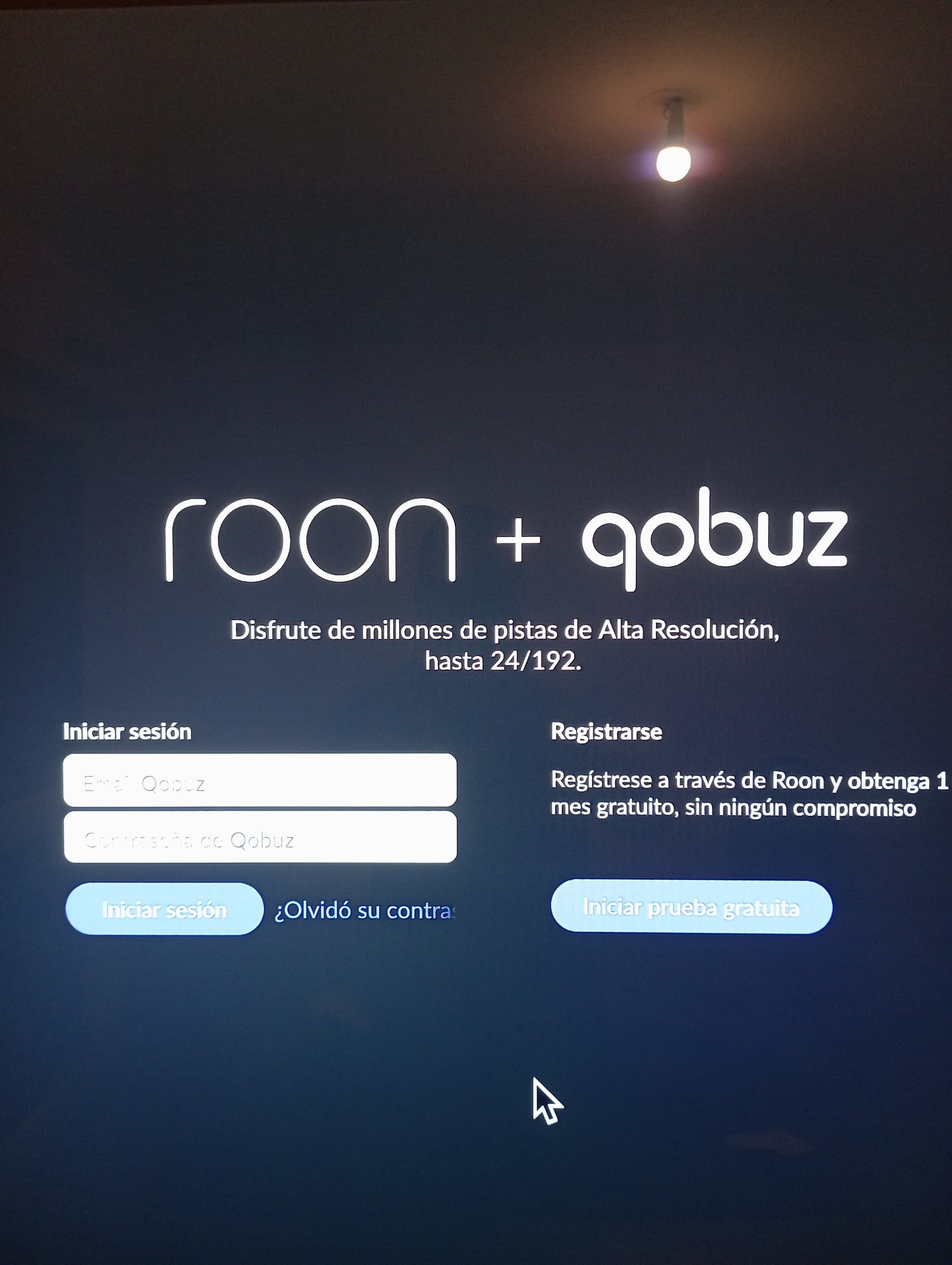

Now the situation its like that: i open the Roon and appears the next 3 photos. In the last one, i put my mail and Qobuz password and its make like start Roon but only one second, then, suddenly its turn off Roon and nothing happend

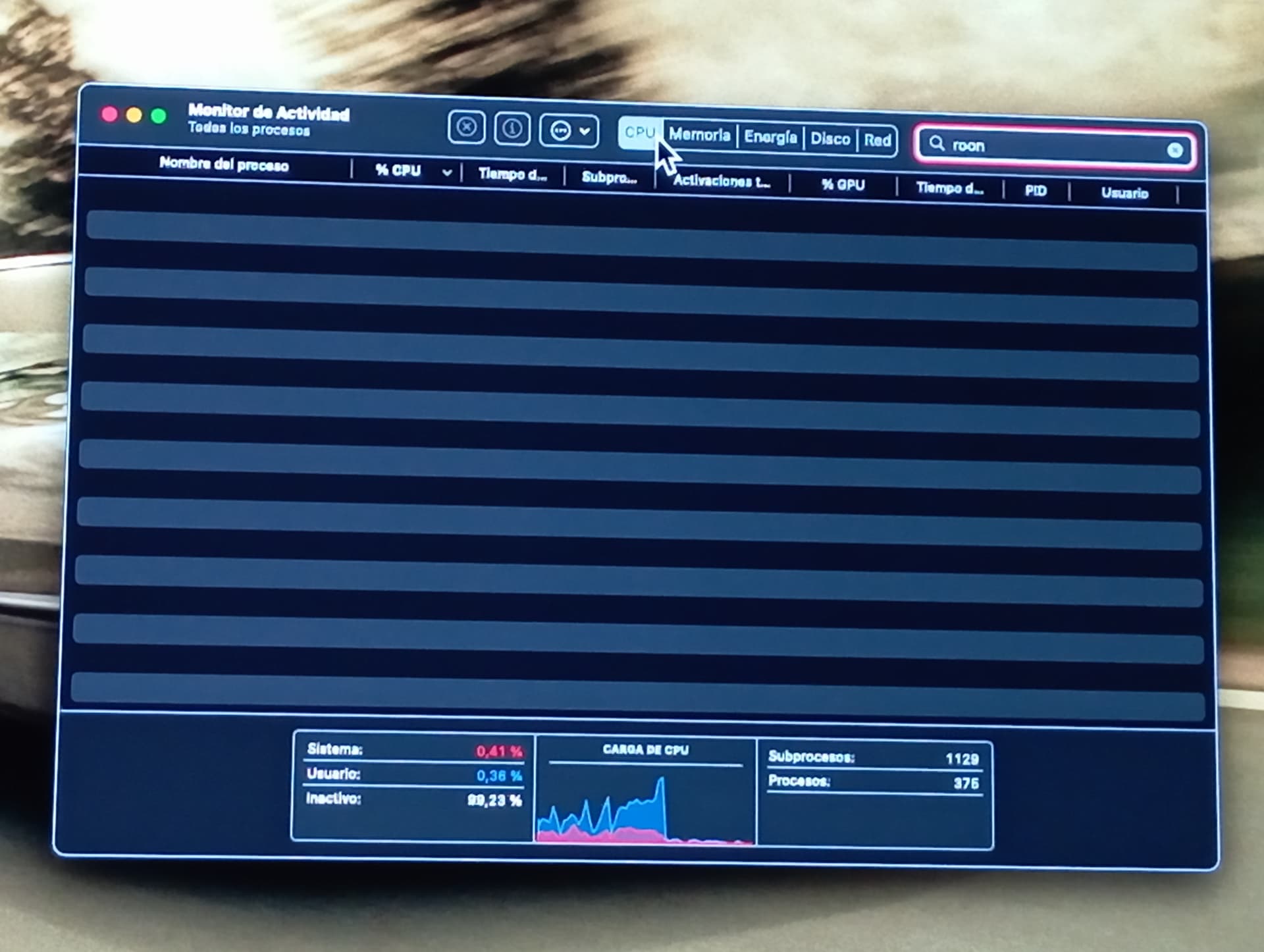

  1. Open Activity Monitor and see if there are Roon-related processes still following. If so, what happens if you terminate them?

I try to make that you write me but there are no Roon process Running in Activity monitor…
Also i push: Go and look for Roon.ick files and there are no results…

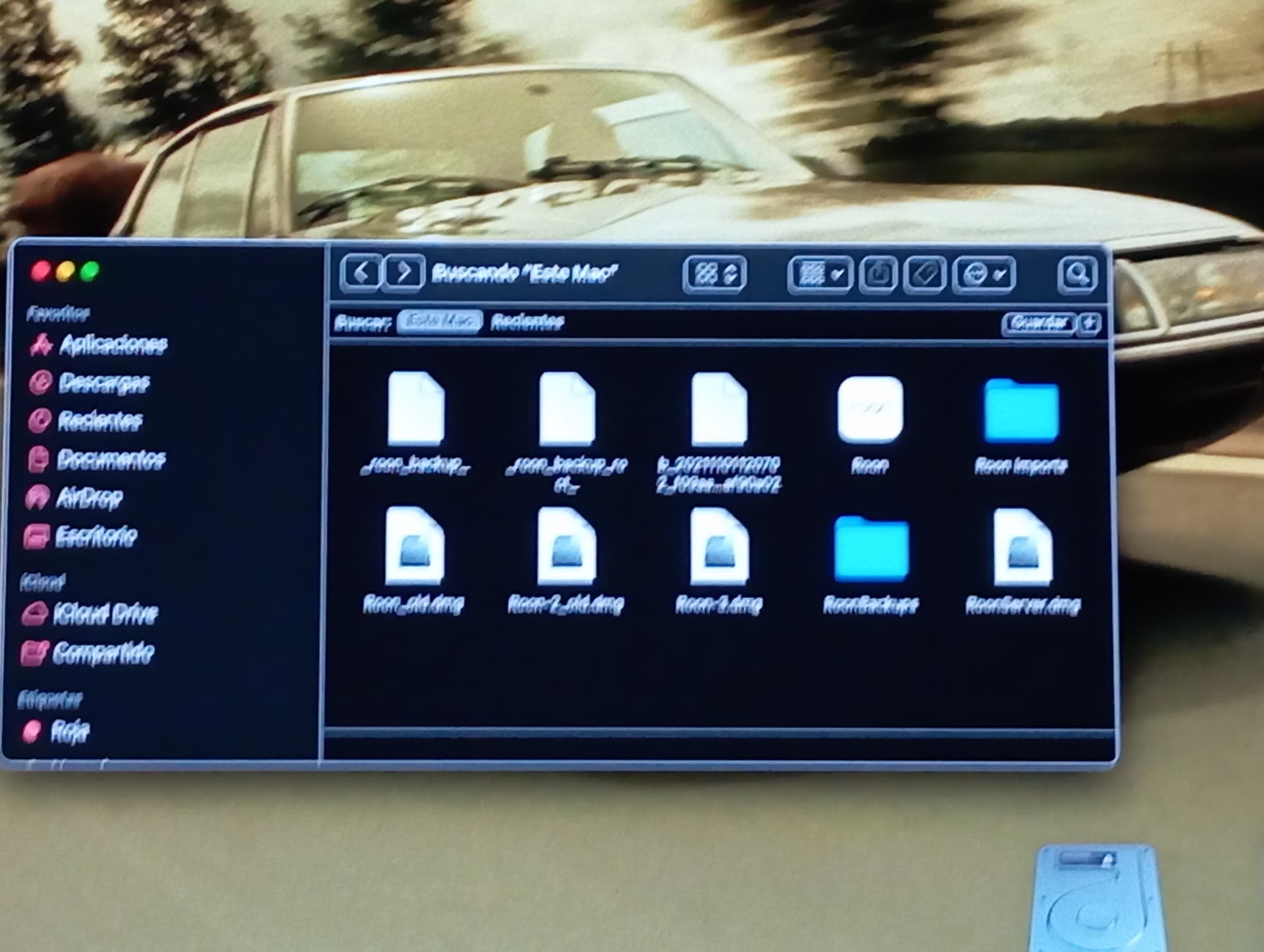

Hi @Andres_Garcia1 ,

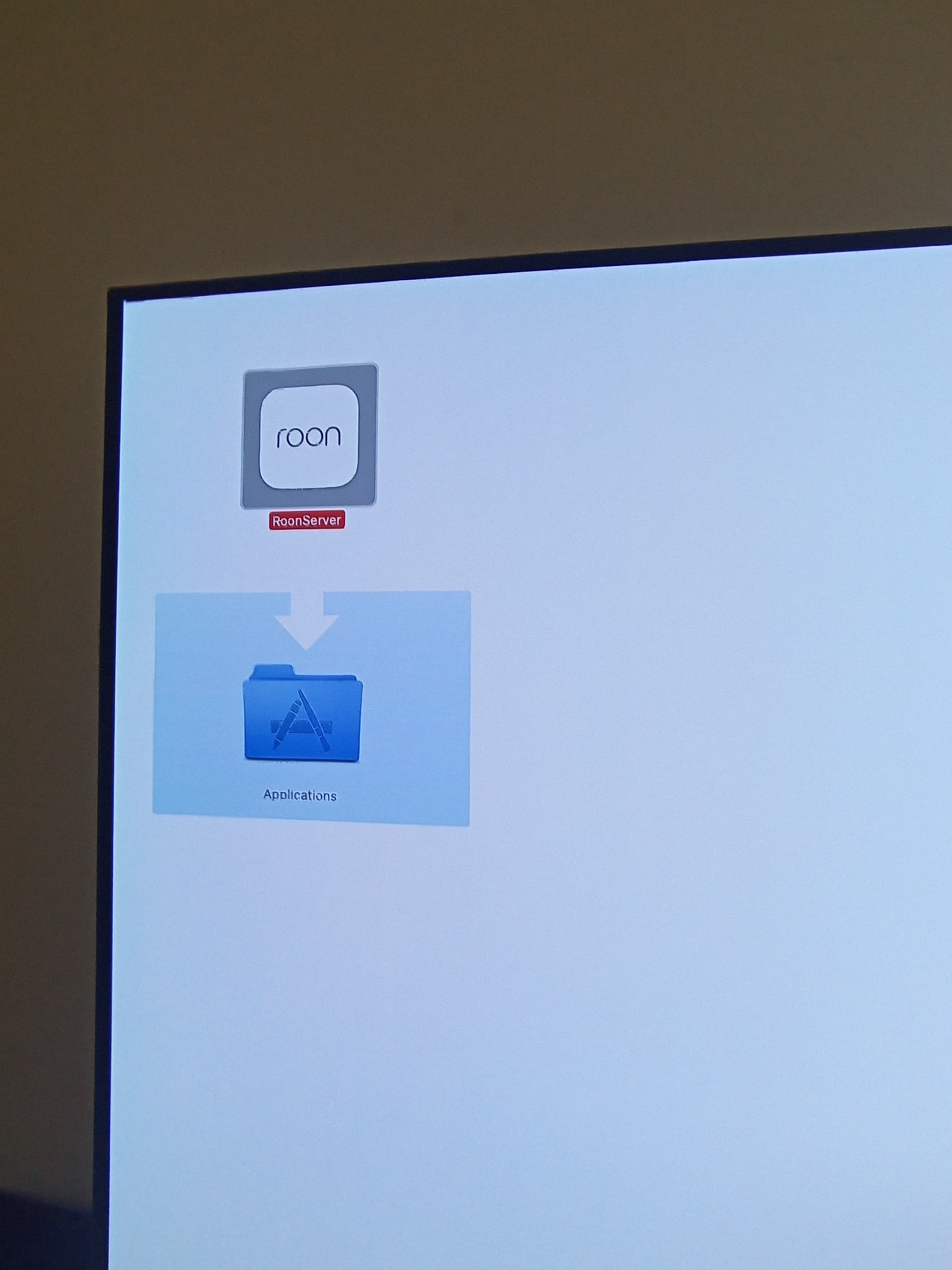

It looks like you have quite a few version of Roon in your latest screenshot. Can you please try to delete/move these versions to a new folder and download the latest Roon version from our downloads page and install via drag+drop to the Applications folder? Here is a direct link to the latest Roon for Mac version:
https://download.roonlabs.net/builds/Roon.dmg
If you are still having issues, please try to post a screenshot (using the Mac screenshot tool instead of a picture). Thanks!
I delete the program and all the files relatives to Roon, then i’ ve download the last version from your link… I’ ve installed the program… And its exactly the same:

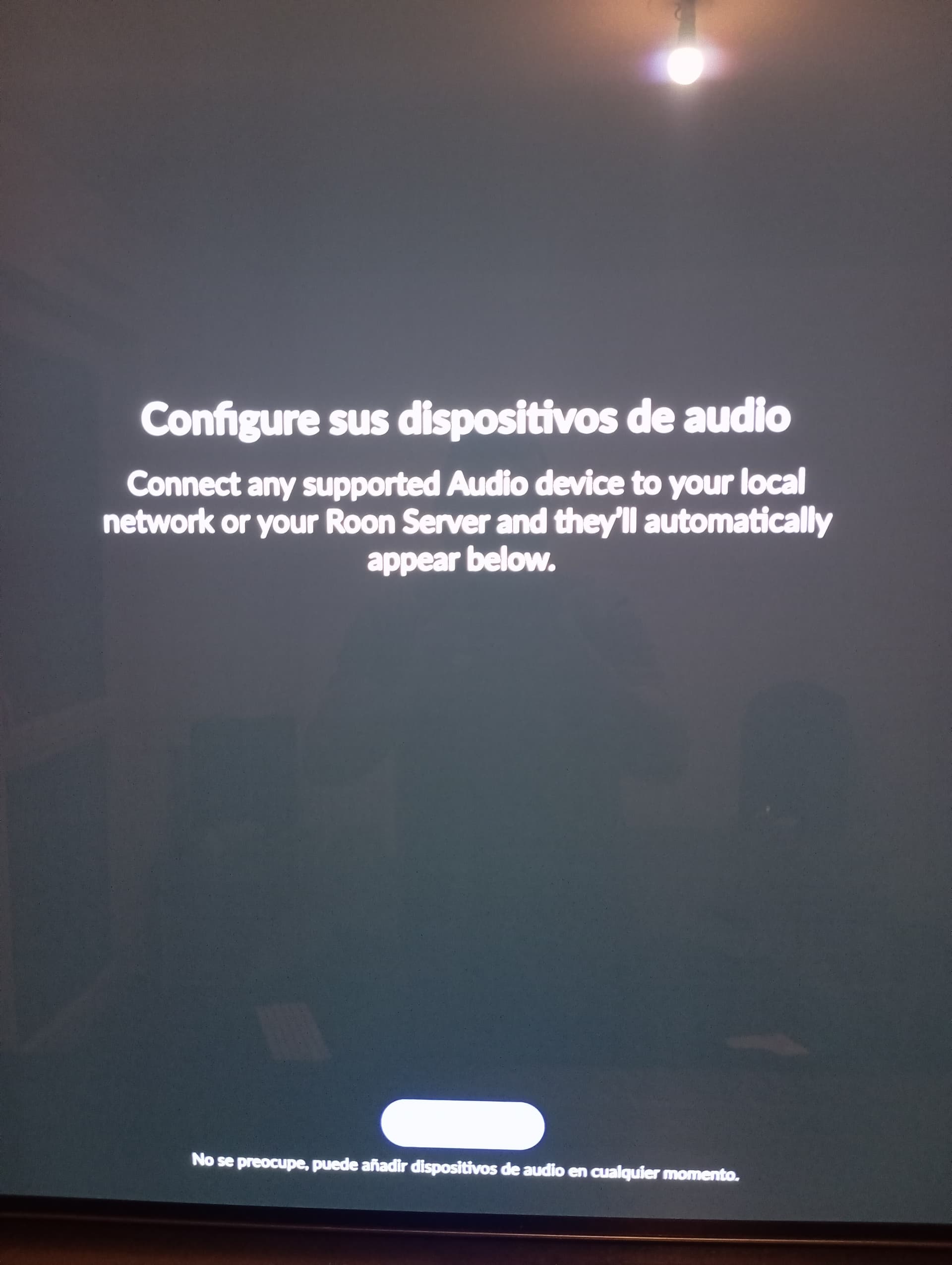

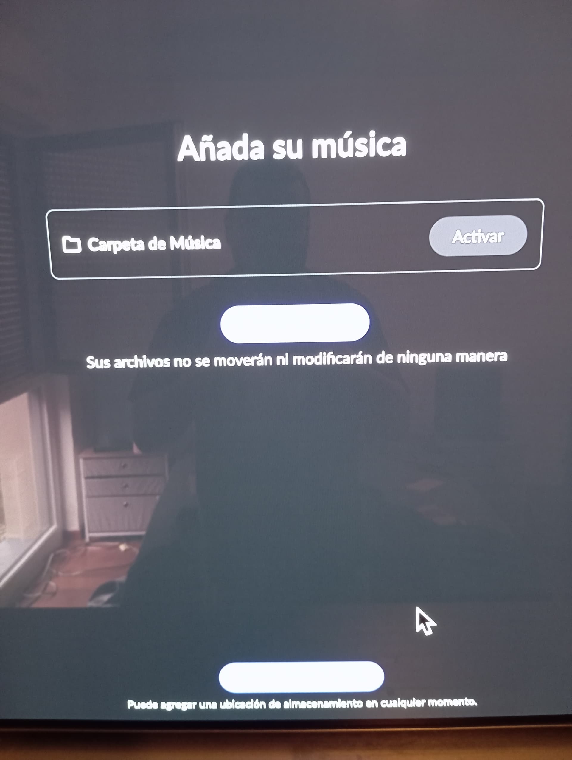

Those are the steps that appears… I click in " terminar" ( finish in english) and the program closed…
Sorry for not use the screenshot app from Mac. I Hope you are able to see the photos properly…

Please repeat the Roon database refresh from this post. Instead of adding your local library when prompted, simply allow Roon to open without any local library when prompted.
I delete the program again and all the files relatives to Roon and veryfied in “Activity monitor” if there is any Roon proccess running…I reinstall the program and delete the library like you said to me. Its Exactly the same… Open the program, put my Qobuz password and when It has to open… The program its closed…

  1. You mentioned Roon crashes after entering your Qobuz password on the streaming service page during onboarding. However, the subsequent screenshots indicates that onboarding proceeded to the Audio Device setup screen. Can you please describe precisely what happens after you enter your Qobuz password, and whether RoonServer is still running in the background if you open Activity Monitior?
  2. What happens if you skip Qobuz sync by pressing “No, gracias” in the first screenshot you shared above? Simply keep selecting this option until you reach the Roon Home page without any streaming services, local storage, or audio devices configured. Does Roon crash under this circumstance?
