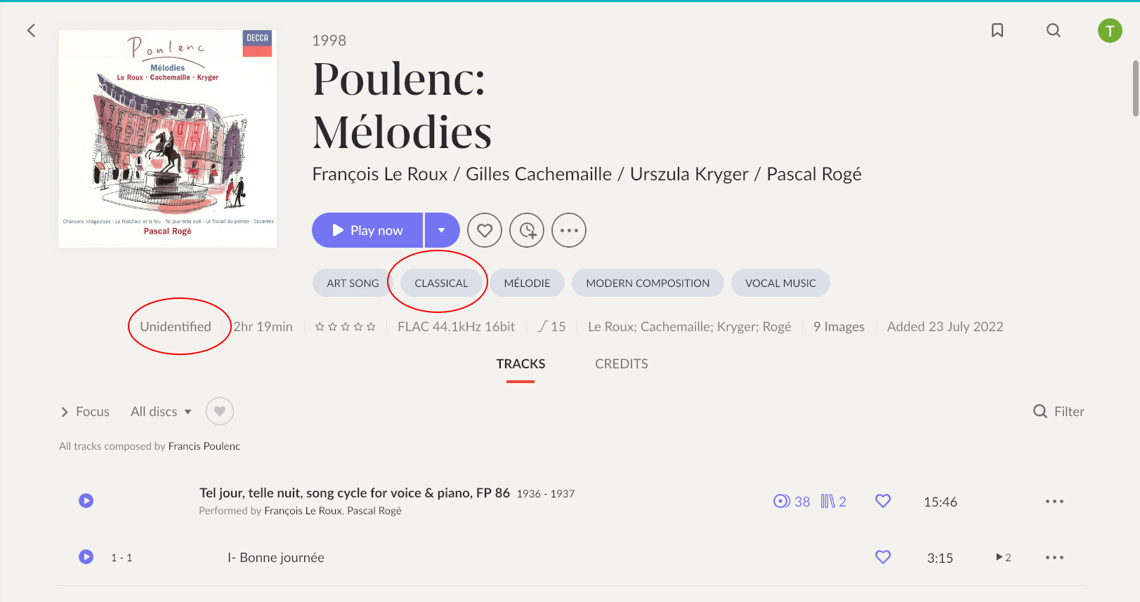

Have you set a “Classical” genre tag for your Classical albums? Roon uses that tag for all sorts of Classical treatment of your files that differs from Pop/Rock. If you don’t have many Classical tags set it sounds like you also have a lot of unidentified Classical albums because if roon can identify the Classical albums in its database it will set a Classical tag even if you haven’t.

One issue that messes up some Classical users is that sometimes they break up albums into works so that each folder represents a work rather than complete album, that is going to cause major issue for Roon because its primary matching algorithm requires a folder to represent full album (allowing for subfolders if multi disc album).

I don’t know for sure but I think main algorithm works in a similar way to how tools such as DbPoweramp work but instead of creating a checksum based on the length and order of each track on a CD, it does a checksum based on the length and order of each digital file. Times not as accurate as a CD but still good enough for many albums (not singles), I know this because that is one of the methods we use in SongKong, but it only works if have complete album and accurate rips of the tracks.
Additionally if songs have been matched by 3rd part tagger, and that tagger actually adds MusicBrainz Ids to the files such as SongKong, Jaikoz or Picard does rather than just the basic metadata then Roon recognizes these ids and accepts these matches without having to search itself for a match.
