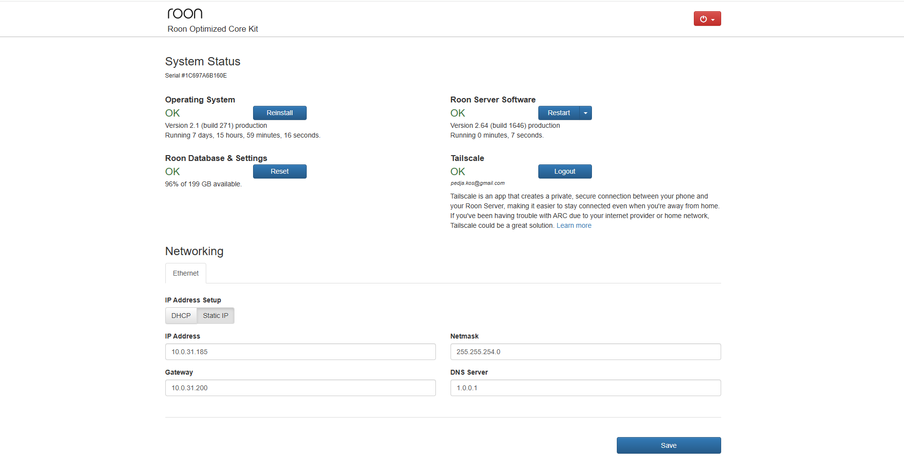

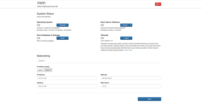

Can you please restart this ROCK and then share a screenshot of your RoonOS web admin page after it reboots?
Please also share a screenshot of your Tags page within Roon and your Settings → Library → Background Work page.

So you are saying Roon Server performs certain background tasks to index and analyze my library. Would like to emphasize that my Roon Server runs constantly, I do not shut it down, even if there is power loss it is on UPS so it keeps running. My Background tasks are scheduled between 1am and 5am, no usage or very light usage of resources at that time. I’m more concerned about Roon Client response time, and why it takes so long to load the home page. I have cleared history as per your suggestion, and still it takes very long time.
Just for your reference, after restarting ROCK Server it took about 7 minutes for ROON client on my PC to load home page.

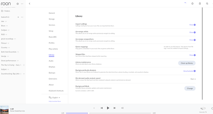

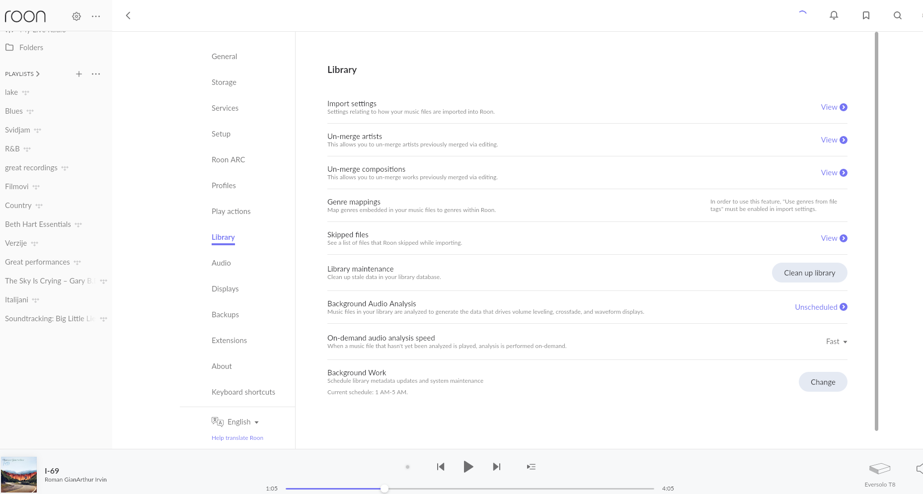

Below is requested Setting →Library→Background Work page Tag page
Hope this helps

While this may be the case for the OS, based on your screenshot, it looks like Roon Server has only been online and running for a few minutes. Keep Roon Server running for a few days to ensure the library analysis is able to fully finish before anything else.
With that, if you could, please share a screenshot of your In Settings → Library → Clean Up Library window.

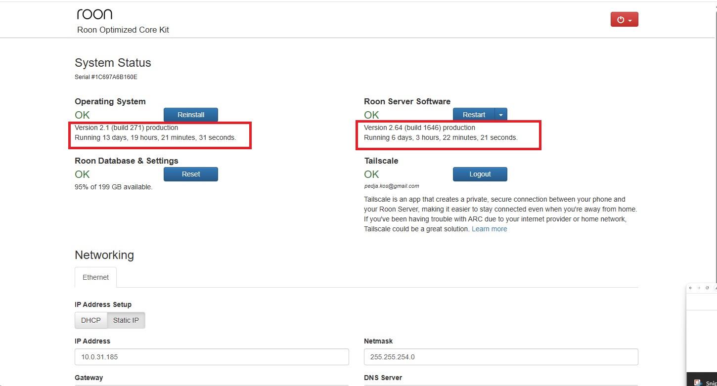

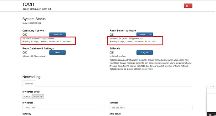

I’m Sending screen shot to show that Roon OS is running 13+ days and Roon Server more that 6 continuous days.

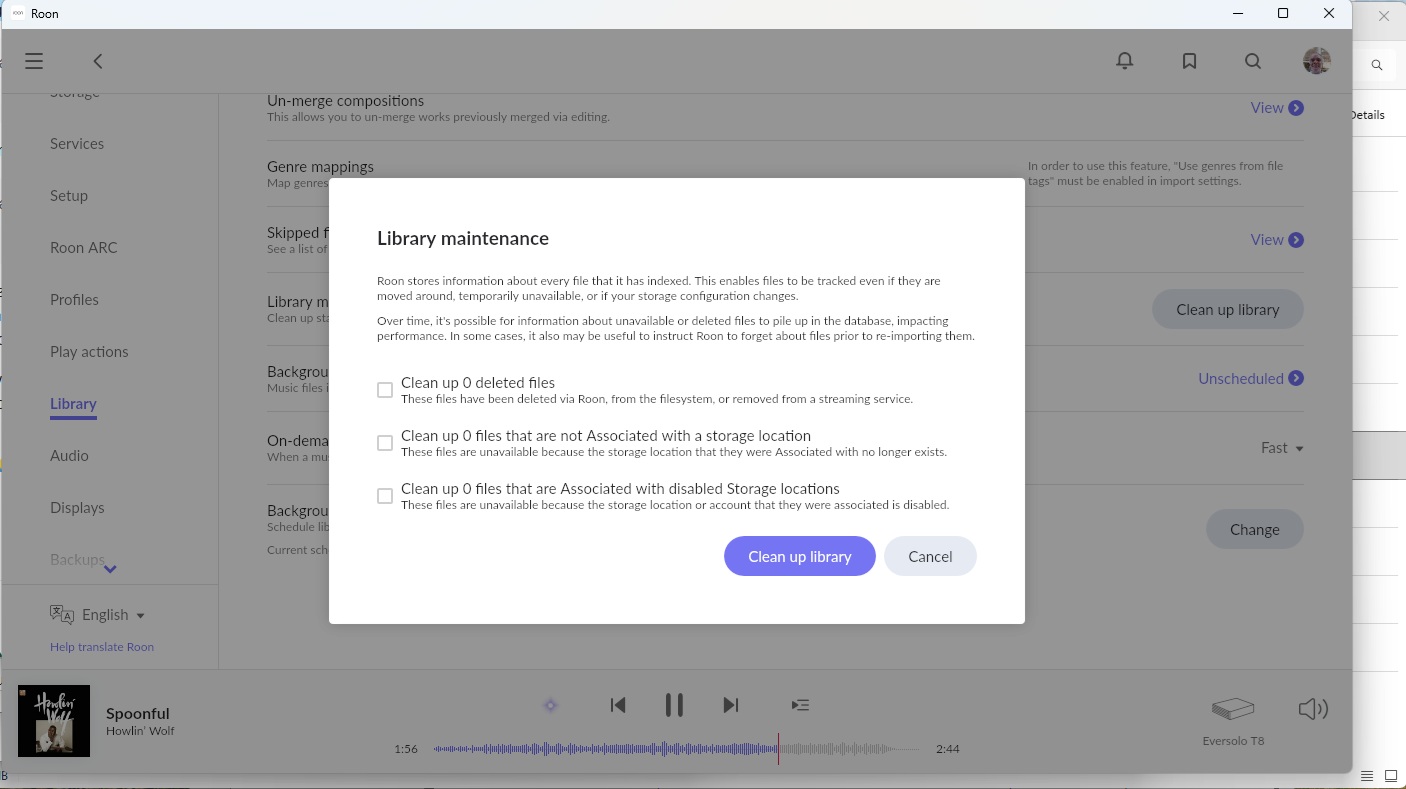

As requested screen Shot of Settings →Library→Clean Up Library
