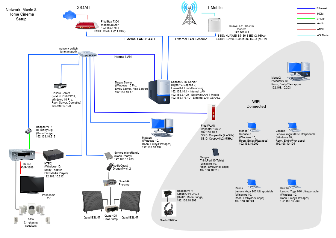

Here’s the network diagram of my current setup. As you can see, I have two RPi boxes, one of which uses a HAT to give S/PDIF input to my Denon AVR.
This would be fine for stereo, but if you want to use multichannel into your AVRs, you’d need to use the HDMI output on the RPi.

Curious what you use the HTPC off the Denon for as you have other servers on the network besides PI.

Erm, if you’re referring to the network diagram, I’m Geoff, not Steve… :slight_smile:
The HTPC is used for the Home Cinema and runs Plex and Emby clients (the Degas server runs the Plex and Emby servers) used to show movies and recorded TV. It also has Roon installed, since with Roon 1.3, I can now use it to play 5.1 audio recordings through the Denon.
