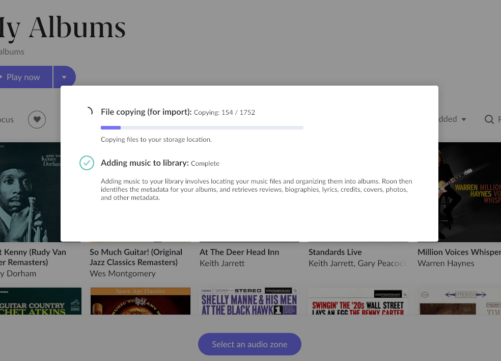

Added a hard drive to Nucleus one and when attempting to import from my computer to my albums it takes forever and keeps adding files, the attached is for one album on flac format, twelve files, as it addes imported it adds more to the pending. Any other way to get the files into the Hard disk at Nucleus?

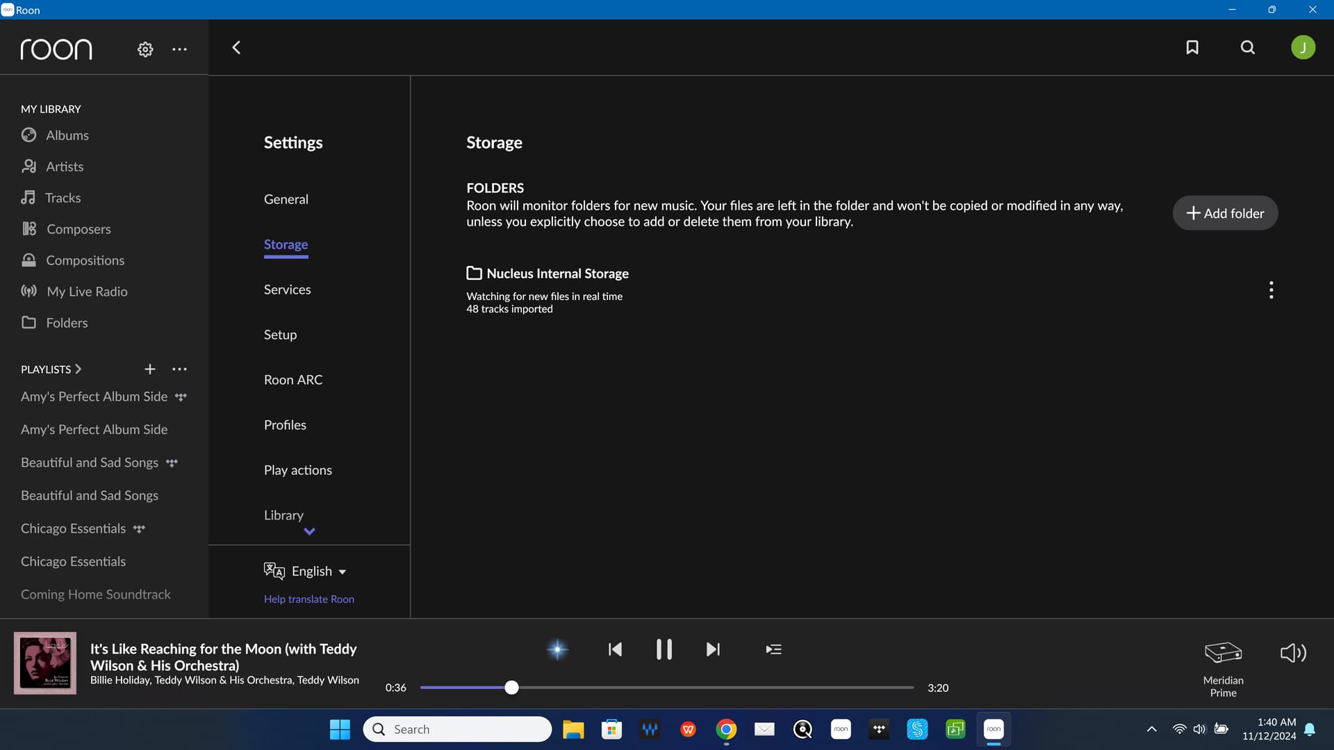

  2. what do you see if you launch Roon and go to Settings (the gear wheel top left) > Storage?

On storage I see
Folders…+add folders where I think we can set up the watch folder in my computer?
Then below
Nucleus one internal storage, watching for new files in real life, so the hard drive is there inside the nucleus but nothing is there.

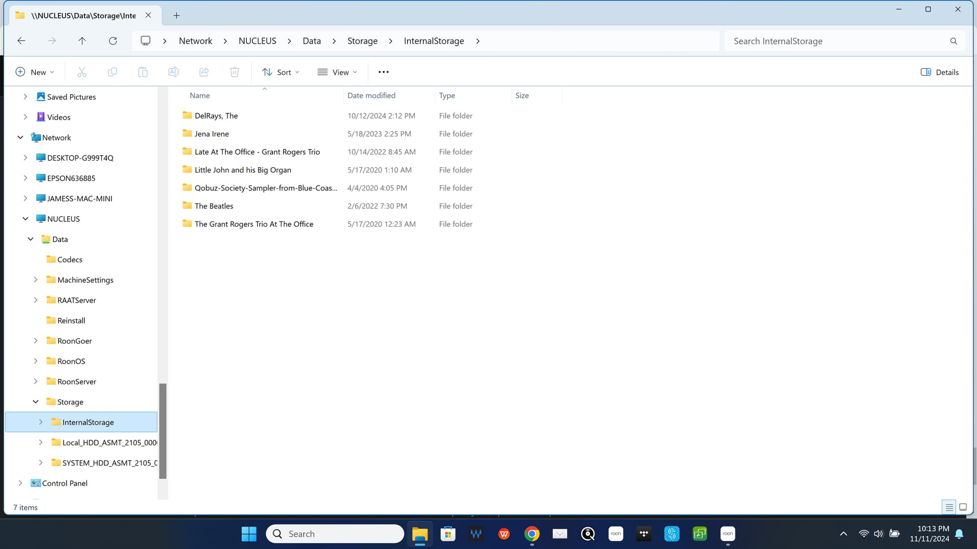

Your internal drive that you added to your Nucleus will be your watched folder and will look like this.
Use Windows File Explorer to drag and drop music files from your computer to your Nucleus internal drive.
I think this is what I am missing to move the files to Nucleus seeing the Nucleus on my file explorer under my Network. I don’t see it. So if you can walk me through the process of adding the nucleus to the network via wifi. Then I can drag the files to the nucleus storage.
