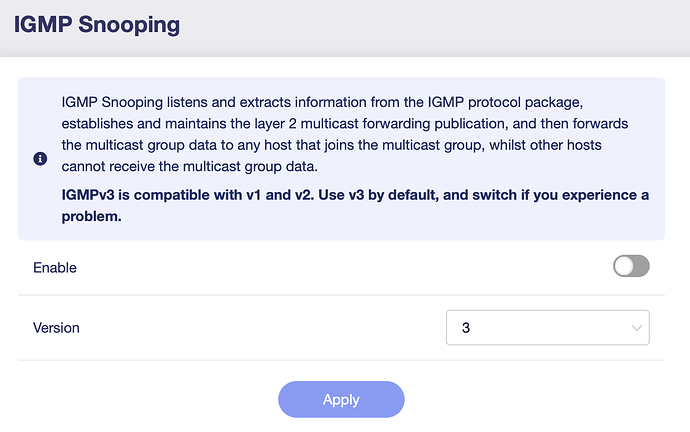

  3. On your new Gl.iNet router, could you please confirm whether IGMP (Multicast/IGMP snooping) is enabled? Roon relies on multicast traffic for device discovery, and this setting can impact connectivity.

On your new Gl.iNet router , could you please confirm whether IGMP (Multicast/IGMP snooping) is enabled?
Interesting; yes there is a setting for this, and it was not enabled:
I will enable this, try the Roon app again, and update here with the results.
