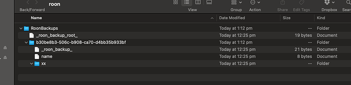

I havn’t been able to backup Roon for quite a while.
I have a Mac mini and I’ve been trying to back up to a USB.
Here’s the screen shot of the backup folders on the USB.

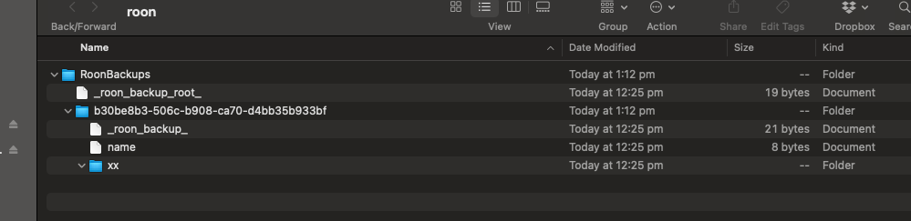

Hi Daniel,
I backed up at 12.25 East coast Australia time Mon 11 Nov to a folder on the desktop and again there are only a handfull of byttes. Please advise.

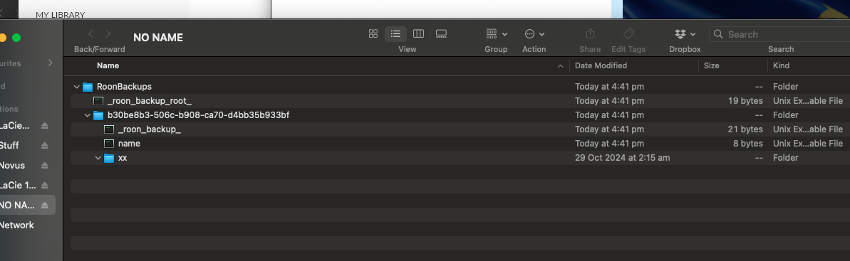

Hi Daniel,
I cleared some space and ran another backup at 9.06PM Weds 13 Nov.
I ran another backup to another external drive at 9.13AM Thurs 14 Nov
Is it possible to verify these backups?
