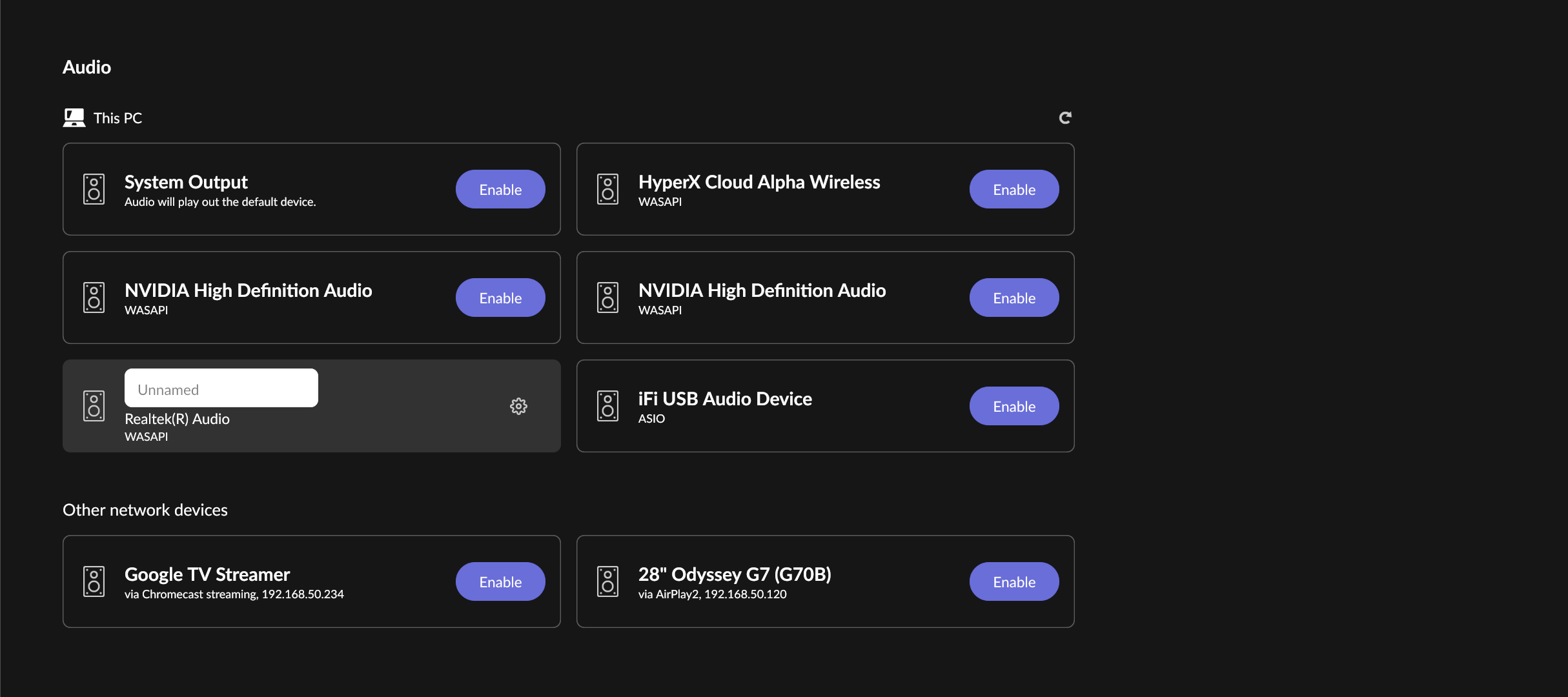

Roon is not recognizing audio output (ref#6B75HW)
· I don't have a System Output available, but I'd like to keep troubleshooting
· Cable (USB, HDMI, SPDIF, etc.)
· Connected directly to my RoonServer machine
· No, it does not show up there
· Only one output type is affected while the other output type works as expected
· When I switched from the headphone audio out switch to green audio output jack
· Ifi Zen Can 3
Roon not recognizing audio output
Router & Modem (Doesn't make a difference, issue only occured when switching jacks)

I tried that, and it did not work.
If I may further describe the problem, its not necessarily that Roon doesn’t recognize the audio output, its just that it won’t play songs. As shown, “Realtek Audio” shows up in Roon, as does System Output, but neither when enabled and selected allow Roon to actually play the songs. They just skip until it says “Too many failures. Stopping playback”
