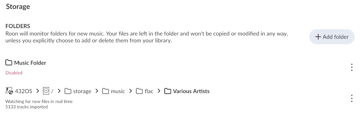

Hi Benjamin,
Removing the Meatloaf & Friends double album, plus cleaning up the library, did not solve the problem.
So then I disabled the watched folder containing all my local music. Afterwards I added a new watched folder with the subdirectory “Various Artists” from my music library, which is still a big subdirectory containing +300 albums. This solves the problem, at least for now. I will look again if anything weird happens tomorrow.
Thanks Benjamin.

Hi Benjamin
Yes, it seems that cutting up the library into several seperately watched folders solves the problem.
I have now added one last folder with DSF-files only. No restart of scanning occurs at the moment.
Thanks for all your research and help!
Peter
