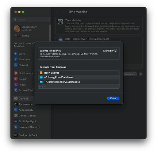

Here are the exclusion settings for the Time Machine backup. The only thing I have changed is Backup Frequency, it was on Automatic. Have I missed something?

Or Time Machine corrupting the Roon Database as I have excluded those folders from Time Machine’s backup.

Hi @Adrian_Berry,
Thanks for your patience. Recent RoonServer diagnostic logging indicates you might still be having this issue. I wanted to return to some log snippets from an earlier post that may illuminate a potential troubleshooting angle:
These traces represent RAAT PCM packet loss within the LAN; they’re agnostic to Time Machine and Backups. The endpoint is requesting samples that have become corrupted or gone missing before they can be buffered. As more and more missing samples accumulate, the audio stream overruns the buffer and the endpoint stops playback.
In most recent diagnostics, we can see these events occur after timeouts with Tidal track downloads. RoonServer isn’t receiving data from Tidal in time and re-requests it from their servers. The ensuing buffer pressure could exacerbate the endpoint-reported dropouts above, particularly if you’re playing from the RAAT instance on the Mac Mini itself.
It’s not clear why packet loss accumulates with Tidal, but since the entire network is hardwired, bandwidth allocation would be the most likely culprit. Note that in almost all cases, Roon recovers without audible dropouts in the logs. This issue does not affect Live Radio and it’s not what you’re reporting, but it could possibly illuminate an underlying cause.
More interesting is the behavior of grouped Zones during long Live Radio sessions. We can that after over 6 hours of playback from Planet Rock, a particular Zone, [Front Office], responds to a five-second AdBreak in the radio stream by dropping its TCP connection due to inactivity. When playback resumes, this endpoint is unable to re-sync with the stream.
Time Machine can disrupt Roon Backups if they’re both working on the same files simultaneously. It’s not normal for Time Machine to disrupt playback unless it’s simply a trigger for another factor that we can likely mitigate.
Apple Time Capsules are usually included with an Airport router. Is that unit involved in this network in any capacity?
At your convenience, repeat your most recent test and play Live Radio while initiating a manual Time Machine backup. However, play to a single endpoint rather than a grouped Zone, like the System Output of a Remote. We’ll be reading the diagnostics of the event and will report back with what we learn.
Please let us know if you have any questions. Thank you!
Hi, sorry for the slow response. I’ve been out and about and carrying out some more experiments when I wasn’t.
Long story short: I have replaced all 3 of my Mac mini Endpoints (Audio Devices?) with Raspberry Pi 4■■ running RoPieee. My Roon Server is still the 2012 i7 Mac mini running Sonoma. This is enabled by using the Open Core Legacy Patcher software.
This setup has run Planet Rock internet radio perfectly for over 2 days with 2 endpoints in a group. Over 48 hours without a single dropout - a record in my household! All I did was change the Endpoints. The router, DNS, hubs, switches, cables, DACs etc all remained exactly the same.
Conclusion:
  1. There is something with the Mac minis that Roon does not accommodate.
  2. Like all good problems, there are several root causes.
So what causes problems?
  1. Time Machine
    There are quite a few posts on the Forum stating that you should not run Time Machine on a Mac running Roon.
    The Problem is actually much worse than that. I’ve demonstrated that any Mac running Roon as a Remote and Time Machine connected to your network will cause all your Roon Endpoints to dropout when Time Machine kicks off - even if that machine is not playing anything via Roon. The mere fact that it exists on your network and is running Time Machine and Roon will cause dropouts with internet radio. However, in my experience it is only internet radio that has this problem. Streaming from Qobuz or local stored music is unaffected. So somehow streaming from an internet radio station is different.
Interestingly, using an iOS device, an iPhone or iPad, as a Remote does not cause dropouts. There are Warnings in the Roon Server log file but no dropouts. But iOS does not use Time Machine.
Example Warn messages that appear at the start of dropouts:
01/19 11:25:17 Warn: [.NET ThreadPool Worker] could not run /usr/sbin/diskutil info -plist '.timemachine/RoonServer Time Capsule._afpovertcp._tcp.local./2AFA0EF9-5A60-4498-9EEE-7C5AA35921E3/Data' -- Exit code was: 1
02/08 12:44:22 Warn: [Worker (15)] [Lounge BiFrost + Kitchen DSD + Front Office DSD] [zoneplayer/raat] Too many dropouts (>3s dropped out in the last 30s). Killing stream
  1. Using Mac minis as Endpoints
    After making sure that Time Machine is turned off on every Mac mini that is running Roon, I stop seeing dropouts associated with the Warning "Too many dropouts (>3s dropped out in the last 30s). Killing stream"was still getting dropouts.
However even with Time Machine turned off on all machines running Roon, I was still getting dropouts. I reviewed my complete system again and it occurred to me that the Mac minis I’ve been using for Endpoints and the Roon Server are quite old. But the Roon Server machine is running macOS Sonoma and the Endpoints are running Sequoia even though they are not supported by Apple. This is achieved using the Open Core Legacy Patcher. I wondered if the Patcher was causing some problems.
I did not fancy buying several new Mac minis to prove the point. But I have been considering finding out about Raspberry Pis for some time. So I have bought 3 second hand Raspberry Pi Model 4■■ and installed the RoPieee implementation of ROON. I am now using these as my 3 Endpoints and retained a 2012 Mac mini running Sonoma as the Roon Server - no Endpoint.
So whilst I still do not understand what is wrong with the Mac minis, I think this experiment proves the it was the Mac minis that were causing the problem. Nothing to do with DNS, Routers, hubs, switches etc.
  1. Having said all that, a couple of hours ago I started Roon Remote on the Roon Server Mac mini and added in a third Endpoint. I realise that I had originally started the 2 day successful experiment running from my iPhone rather than using Roon on the Roon Server. As I finished typing this summary, the system dropped out. The Roon Server log leading to the stoppage is:
