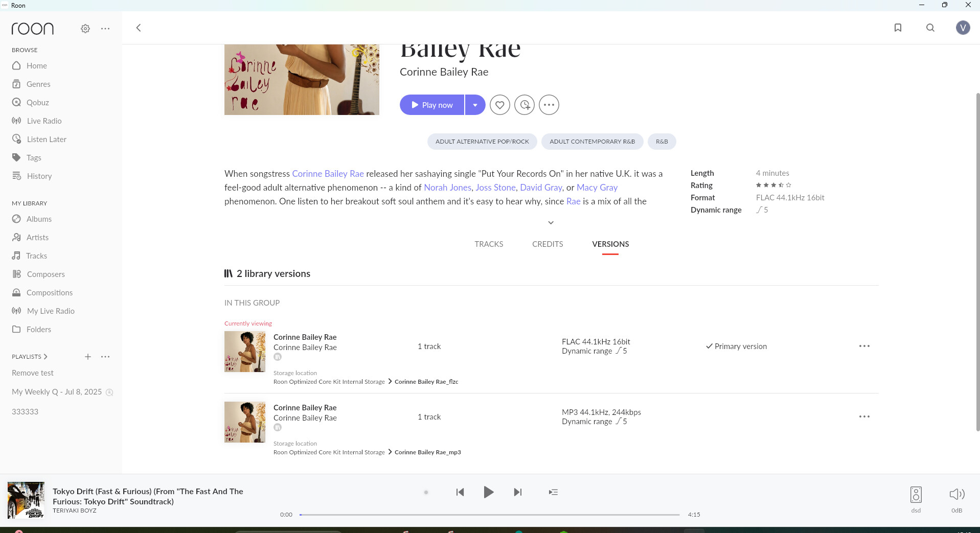

When using Roon search and selecting local results, first result is always lossy MP3 when FLAC exists.
Asus Router RT-AX82U - LAN

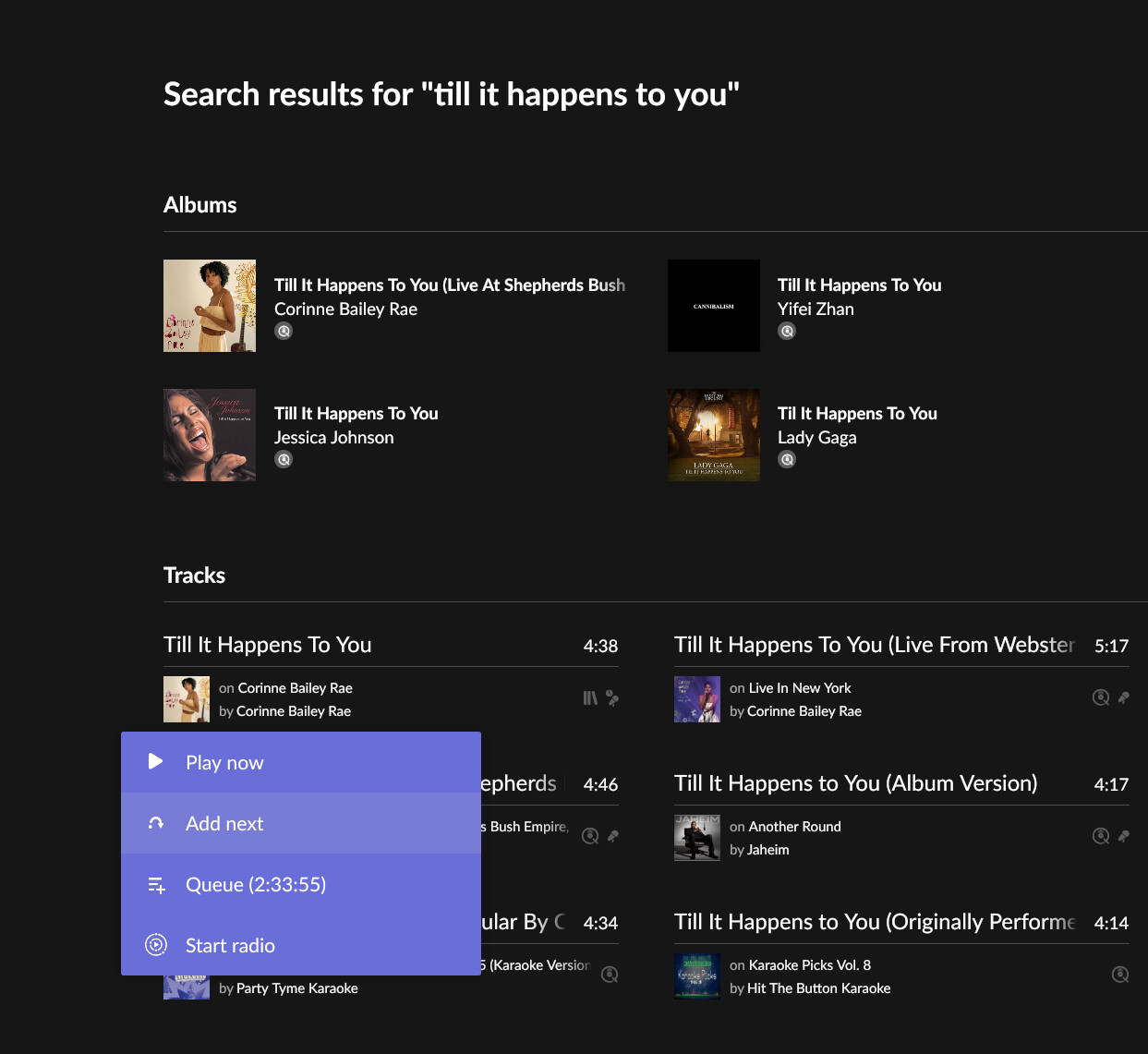

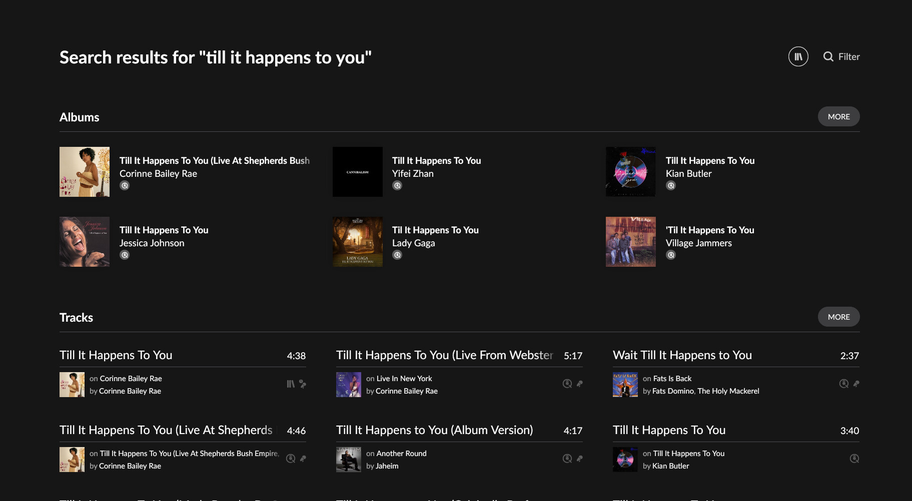

Adding photos showing how I’m getting these results. My search starts with “ctrl + f” to open Roon search.

When I repeat the search now the top suggested track is from Qobuz? That’s odd. Both Qobuz and my local file are 16/44 so I would expect it to default to my local file of the same quality. Especially since before I removed the MP3 folder it pointed to a local file first in the results (just lossy of course instead of my lossless file).
Even if I click on the “library” icon, it still suggests Qobuz first for both the album and the track.
Hi @David_Robinson,

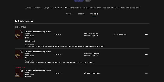

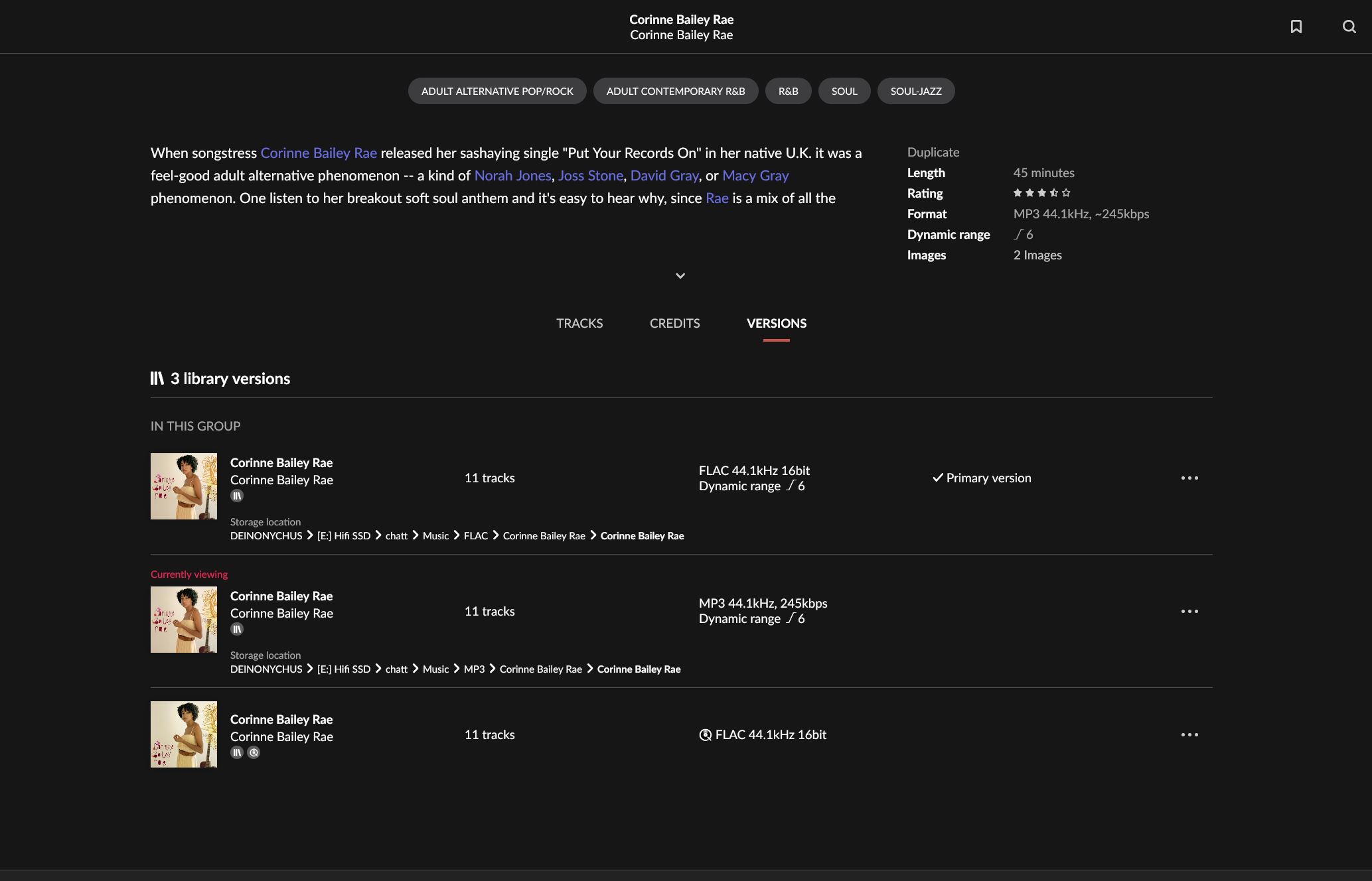

Thanks for the update. Can you please share another screenshot of the Versions tab for this album now that you’ve performed the library cleanup?

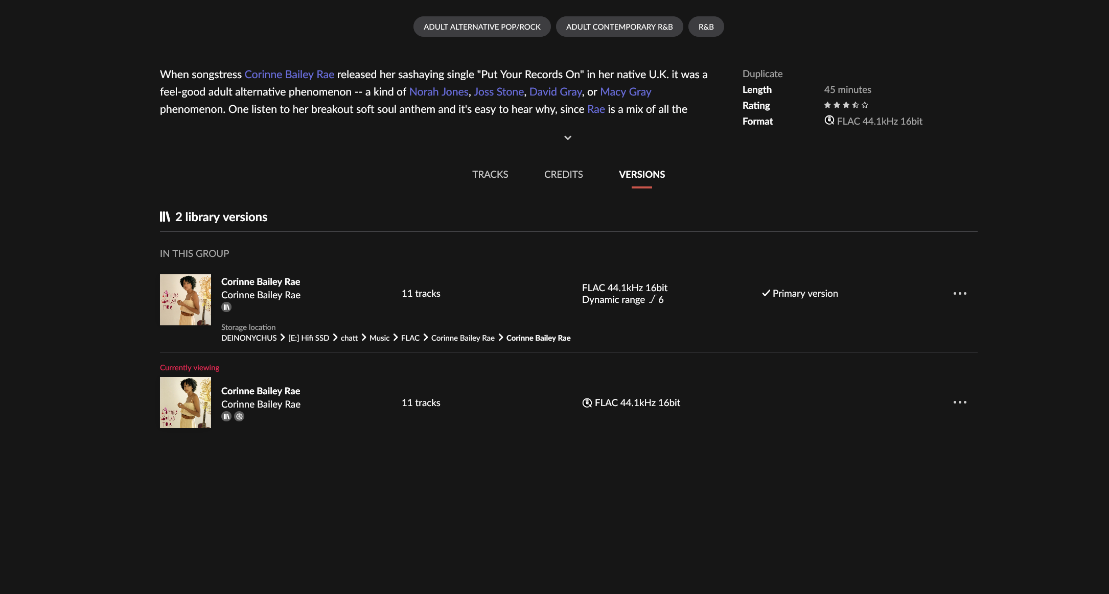

Sure.
It now defaults to Qobuz (despite the FLAC album being selected as primary).
In the time since my last reply I’d re-enabled my MP3 location and Roon went back to preferring lossy files again. Is this a bug?

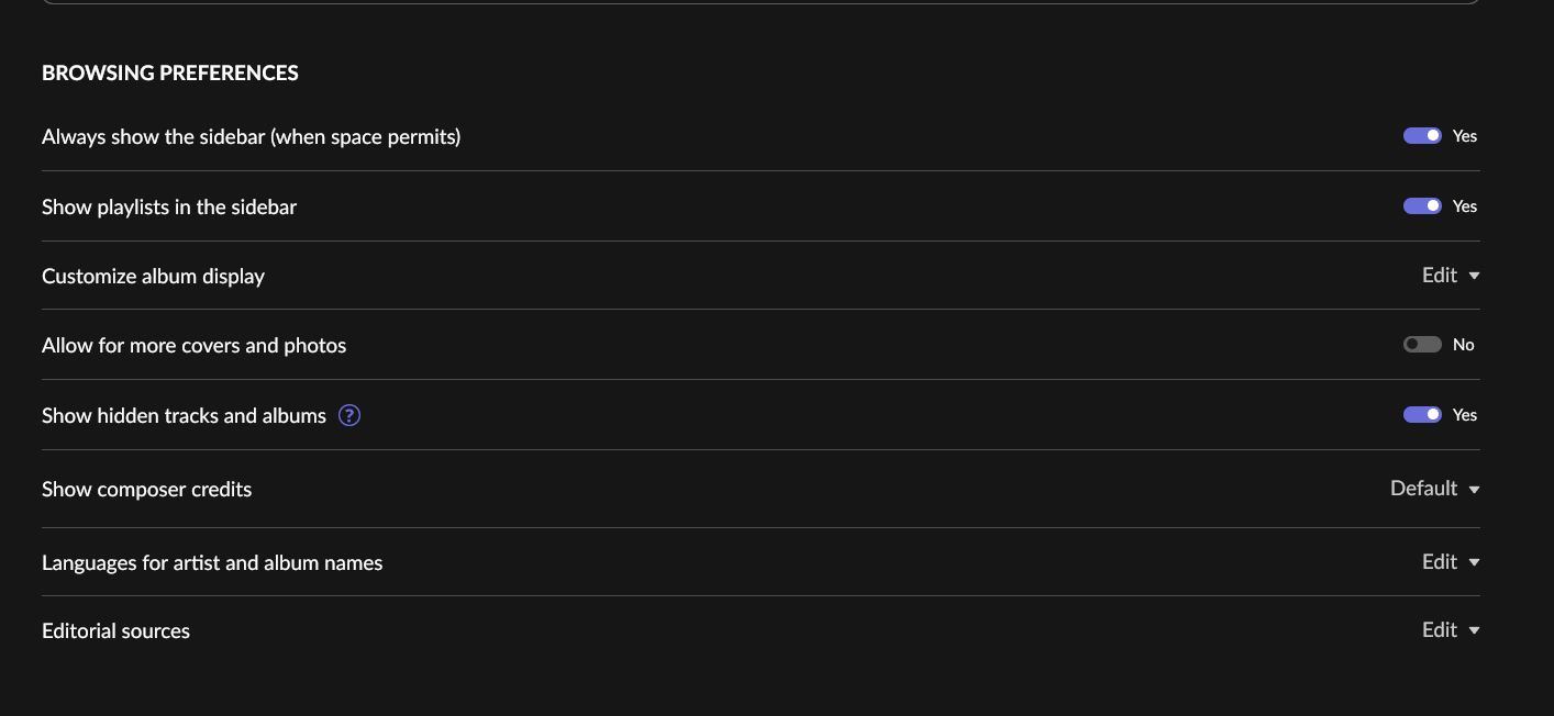

As a quick side test, could you please head to your Roon Settings and enable ‘Show hidden tracks’ and see if the same issue occurs?
Thank you!

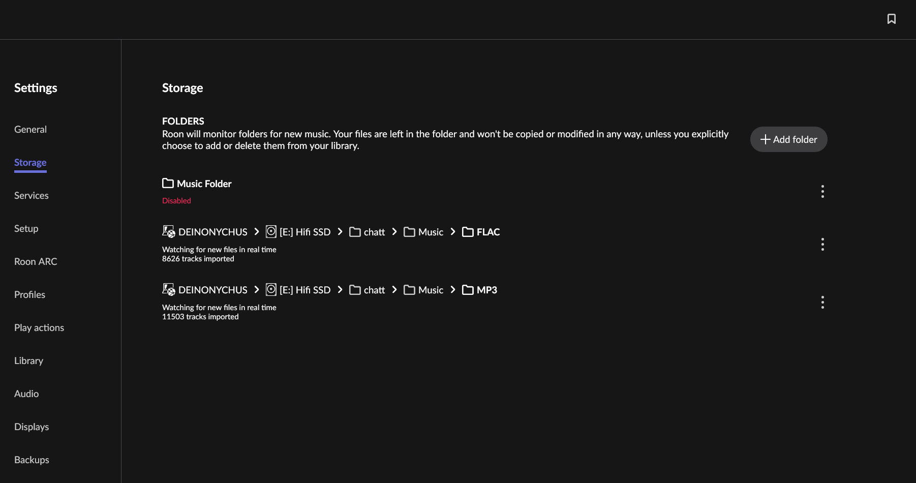

Yes, I have both locations enabled in Storage settings
I have also enabled “show hidden tracks and albums” per your request

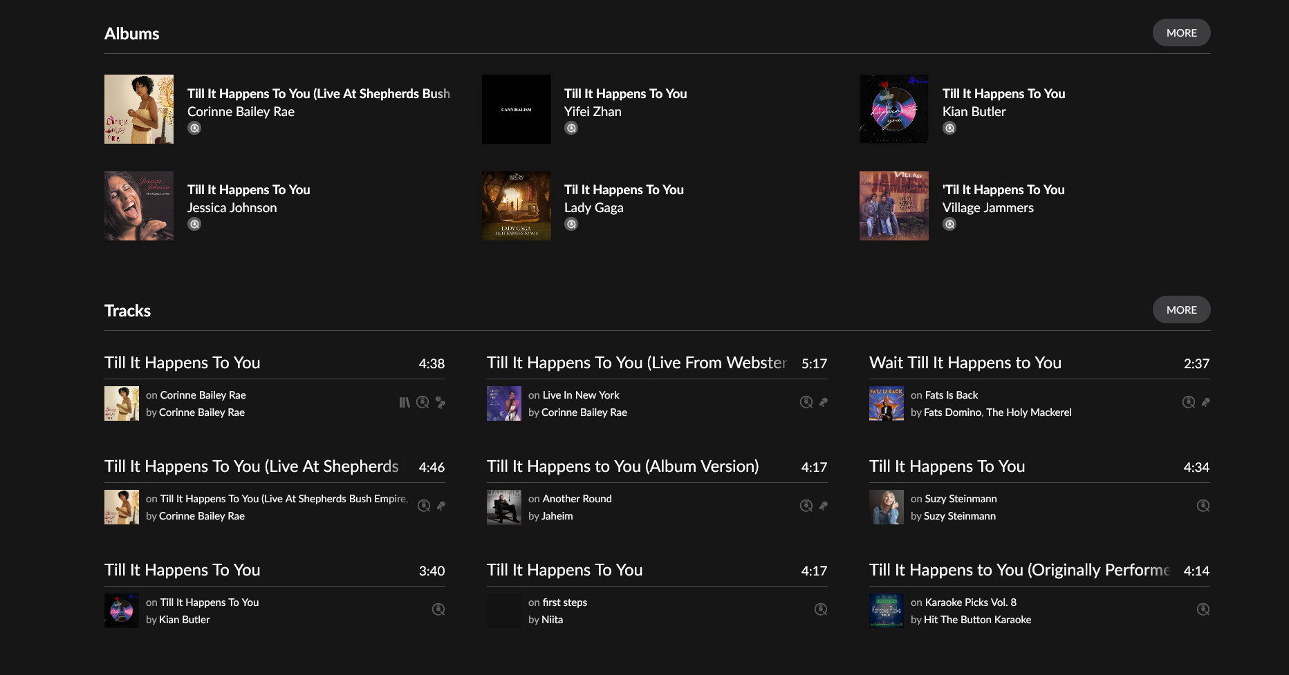

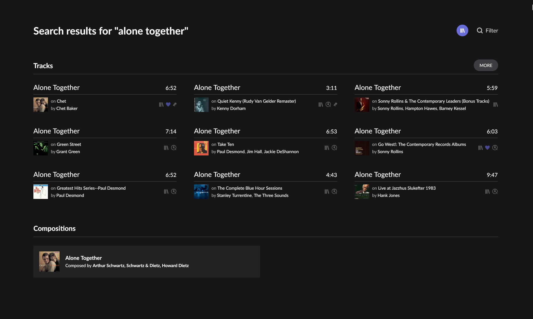

As a test I searched for “alone together” and then selected “Go West!: The Contemporary Records Albums” (it’s the third column, second row in the picture). Here you can see in the screenshot, Roon is suggesting the Qobuz version
As you can see, I have an identical version available locally that it didn’t show in the search results (Qobuz purchase)

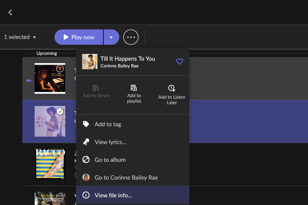

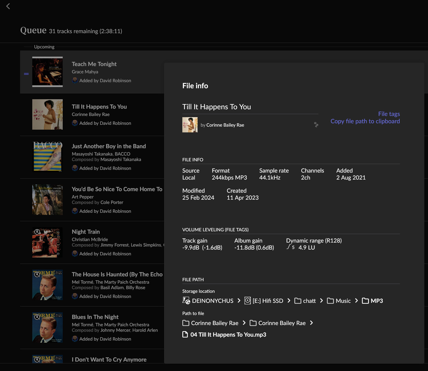

Yes, it does queue the MP3. The video I uploaded was provided to demonstrated that.
I have submitted the database backup as requested.
Are you able to provide a video showing that it’s not queuing the mp3 for you when you add it to queue from search? Roon has done this across 3 different machines for me so if it’s working “as intended” in your case it would be helpful to see.

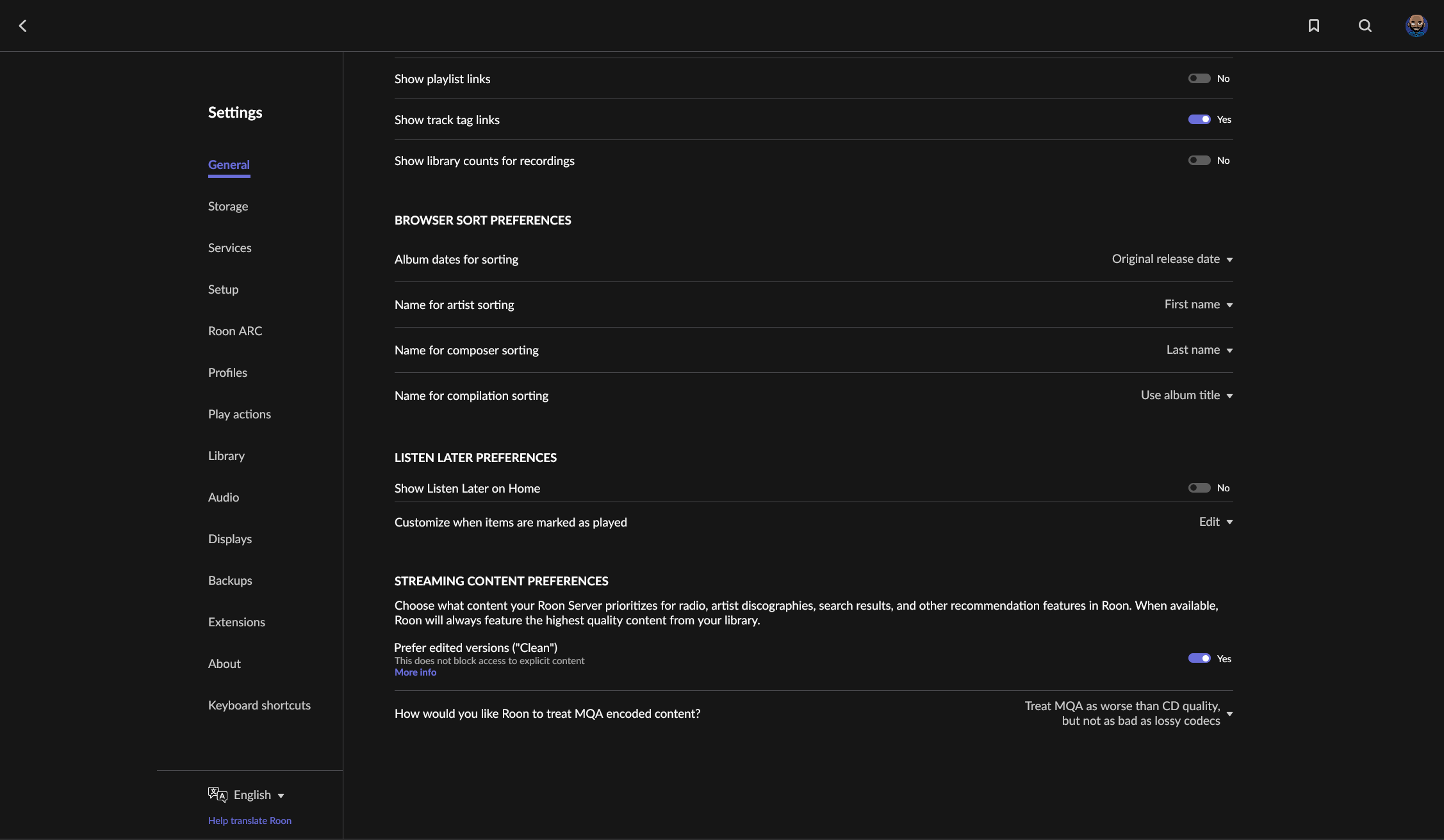

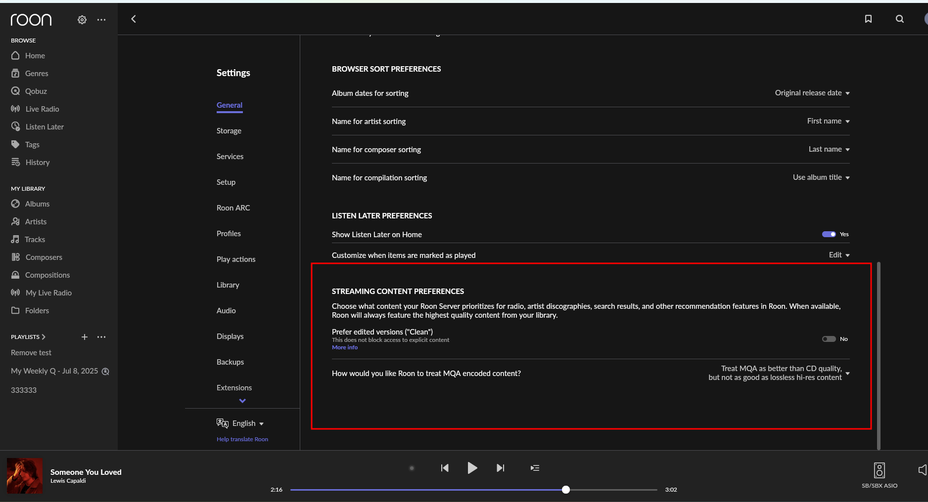

Additionally, please share the screenshot of this section:
Thanks for keeping me in the loop and for all of your help.
Here is the screenshot as requested
