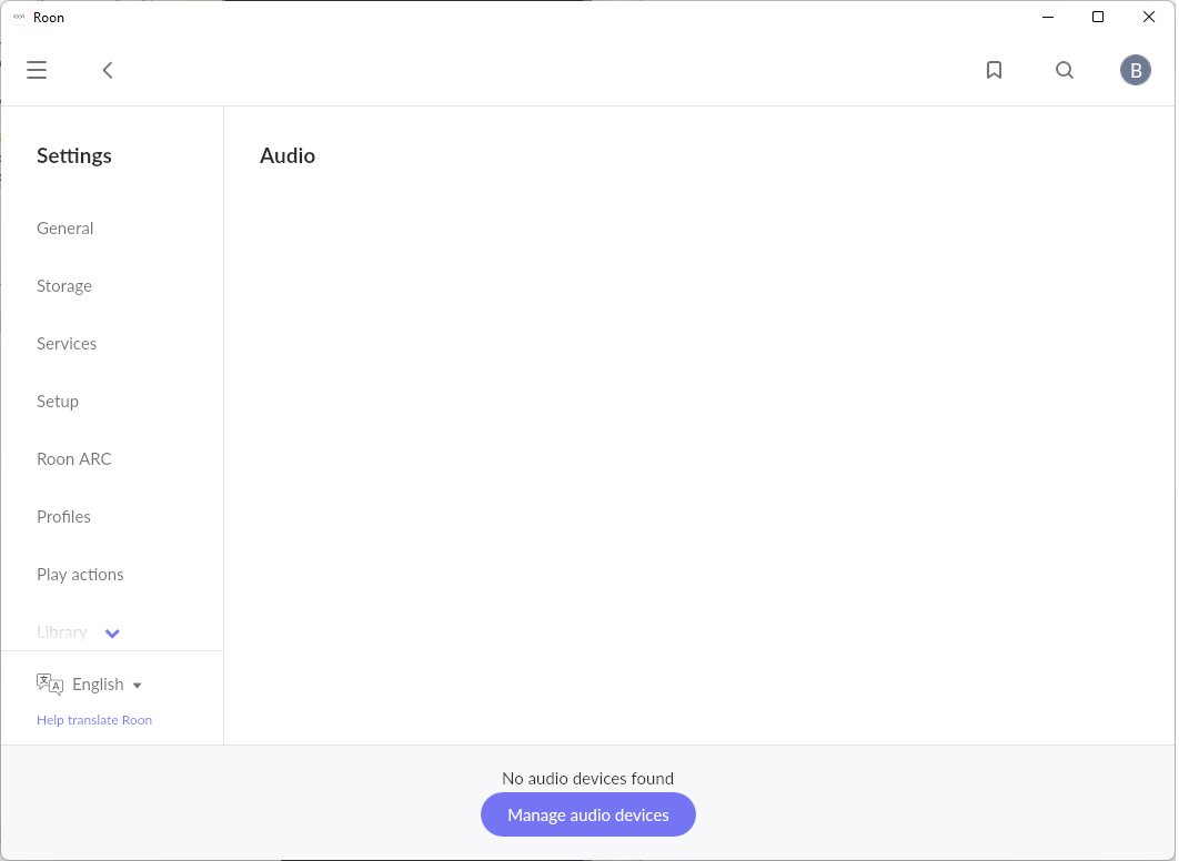

· 20 minutes ago. 08:15 April 26th 2025.
· Oppo HA-1 external DAC. Connected to my PC using USB cable.
I am using a Windows PC with Roon SW and Roon core installed on it. Everything works, *until* I leave the PC for say one hour and the password protected screen saver kicks in. After that, Roon reports "No audio devices found", and I must do a full logout from Roon, then login again, and my external DAC is found. Quite irritating having to do this several times a day.... Before I found out that I could log out and in again, I had to do a full PC restart in order to make Roon work again... I think the problem started some say 2-4 months ago.
FYI: I have an external DAC (Oppo HA-1) connected to my PC using an USB cable. I always have the latest Roon SW installed (i.e. update whenever there is a new version).
My PC is connected to a router using an Ethernet cable. The router is connected to my fiber internet access box.

I’ve gone ahead and enabled diagnostics mode for your account, and after reviewing the logs, we can see that at 07:53:59 the system seems to have gone to sleep:
04/26 07:53:59 Trace: [RAAT::System Output] [volume/wasapi] [OPPO HA-1 USB AUDIO 2.0 DAC] Set volume to 1.000000 mute to 0 [SHARED]
After that, you logged back in the Roon at 08:20:46:
04/26 08:20:46 Debug: [accounts - LoginSSOConfirm] successful login
Could you kindly clarify:
  • Did you wake up your PC around 08:15, and at that time no audio devices were available, as shown in the screenshot you provided?
  • If music is actively playing when the PC goes to sleep, do you observe the same behavior (no audio devices after waking up)?
Looking forward to your reply so we can continue troubleshooting this together!
Question 1: Yes, I think I may confirm the Screen Save ON times and the log-back-on/Screen Saver OFF times.
Question 2: To my surprise, it seems as if Roon is playing when Screen Saver kicks in, then both Roon continous to play while Screen Saver is ON, and when I log in to my PC again, Roon still continous to play. So never stopping Roon from playing is actually a workaround, it seems. (But a workaround that requires a lot of Internet bandwidth!).
