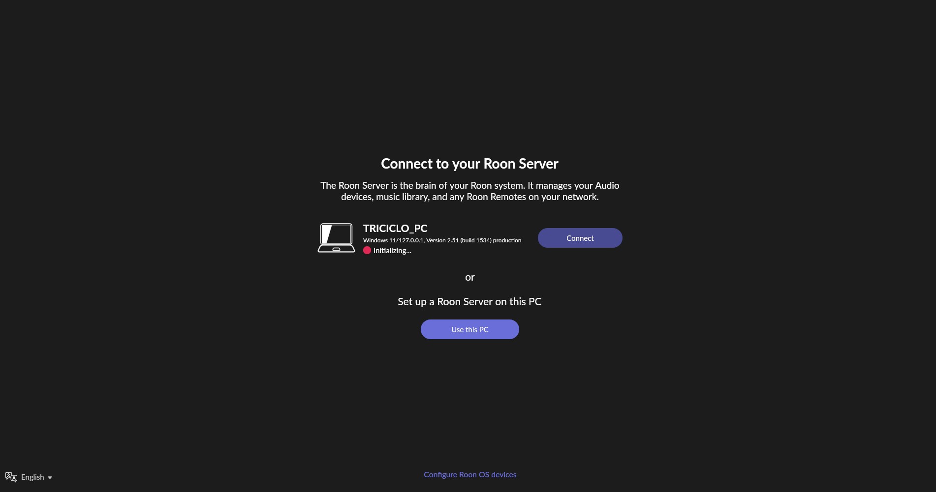

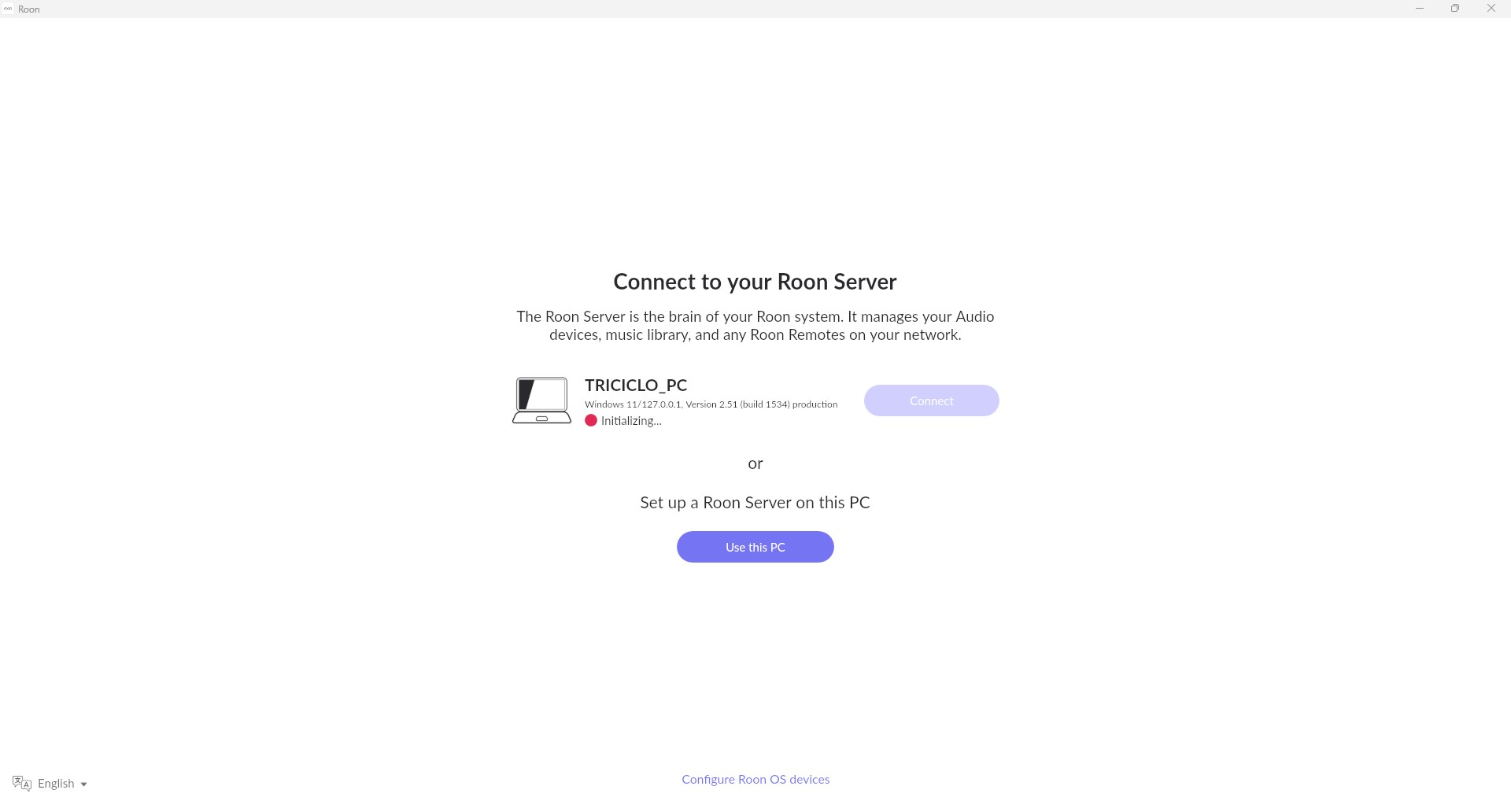

Thanks for reaching out. When you are stuck in an Initializing state like that, it can be due to firewall settings.
Since you are using a Windows PC, I would verify that both Roon.exe and RAATServer.exe have been added as exceptions to your Windows firewall.
You can use these instructions to add the exceptions and the executables themselves would be located in your Database Location/Application folder path.
I would also add these exceptions to any Antivirus or other Firewall blocking applications you may have and ensure that you connected to your network via a Private network, not a Public one, see this guide for more information.

I’ve checked that the computer’s name is still TRICICLO_PC, since it’s the name Roon seems to be excepecting and not finding.

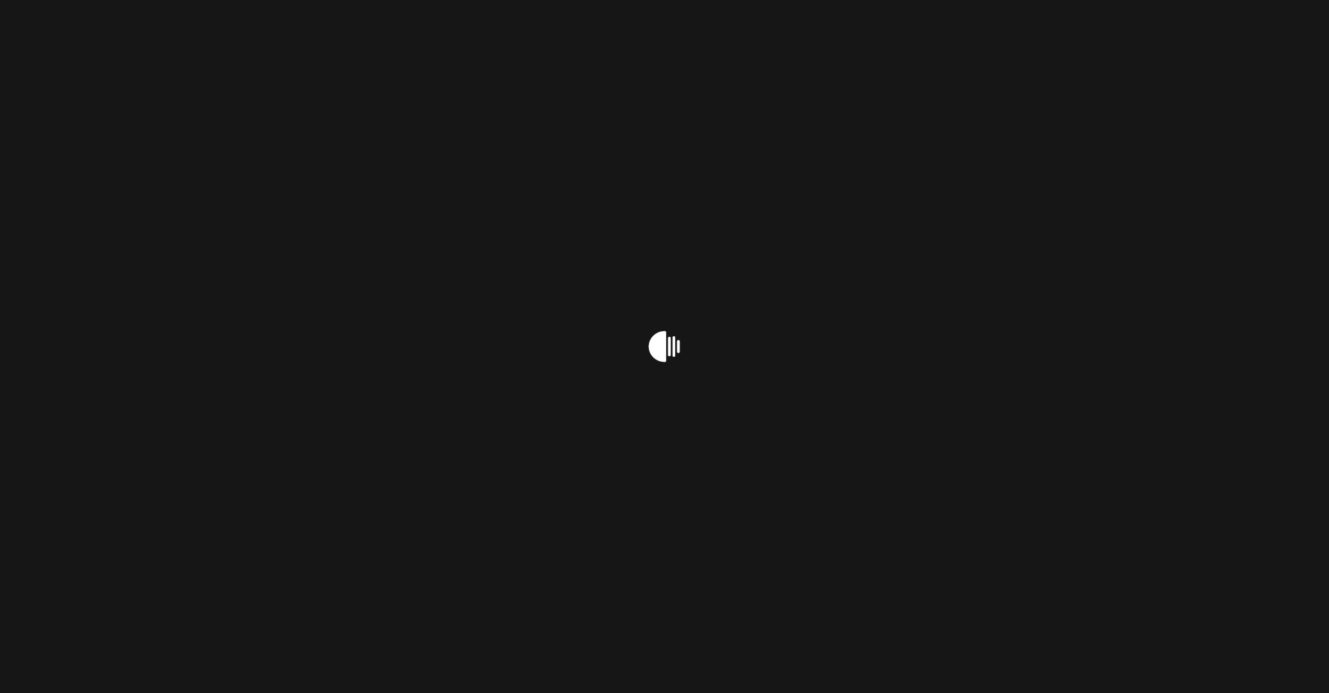

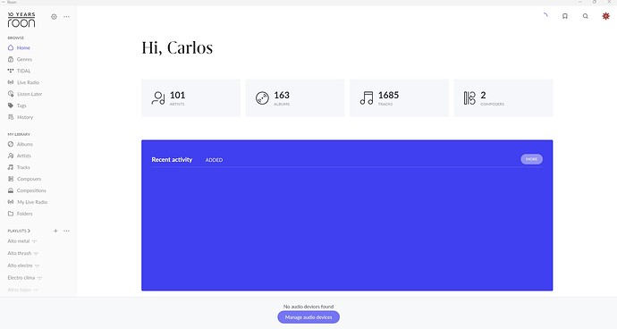

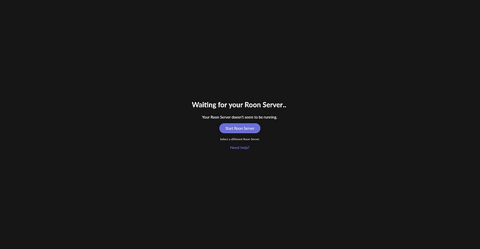

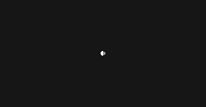

I send screen captures of the different stages after the backup is restored and the connection is lost. The last photo (nr. 4) shows that if I delete databases and setting, connection to the server is restored.
