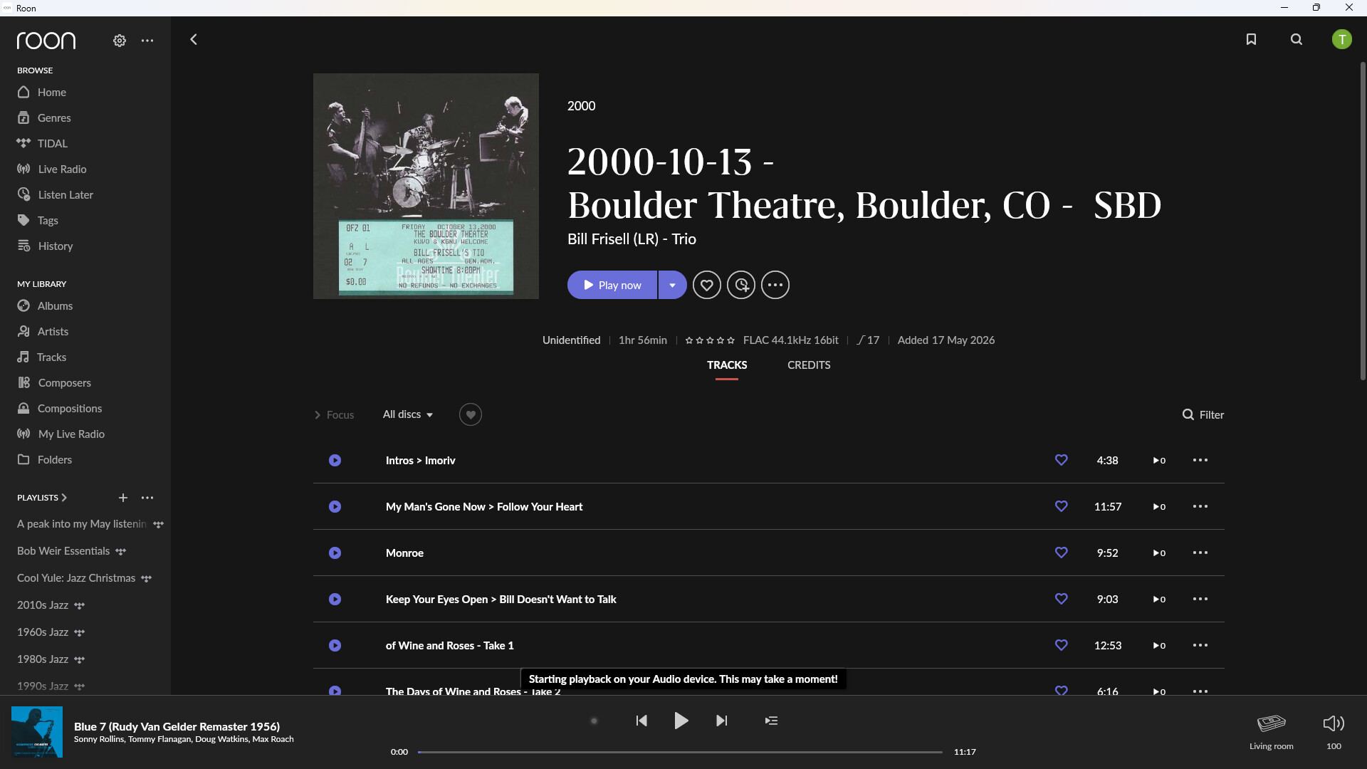

last night Roon again gave me the message the “it will take a while to play the file” message at 8:02 pm. see the attached screen capture. when it stops working I’ll again get the time it occurs and send that info.
