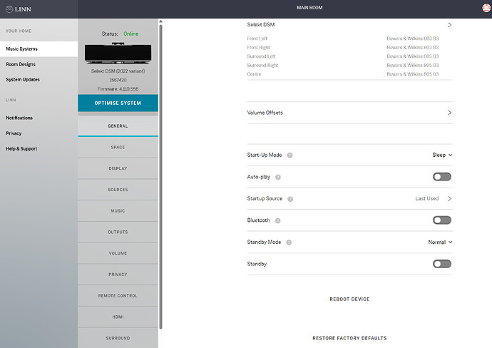

You can use “Reboot” instead:
I got the same problem as you.
Torben
